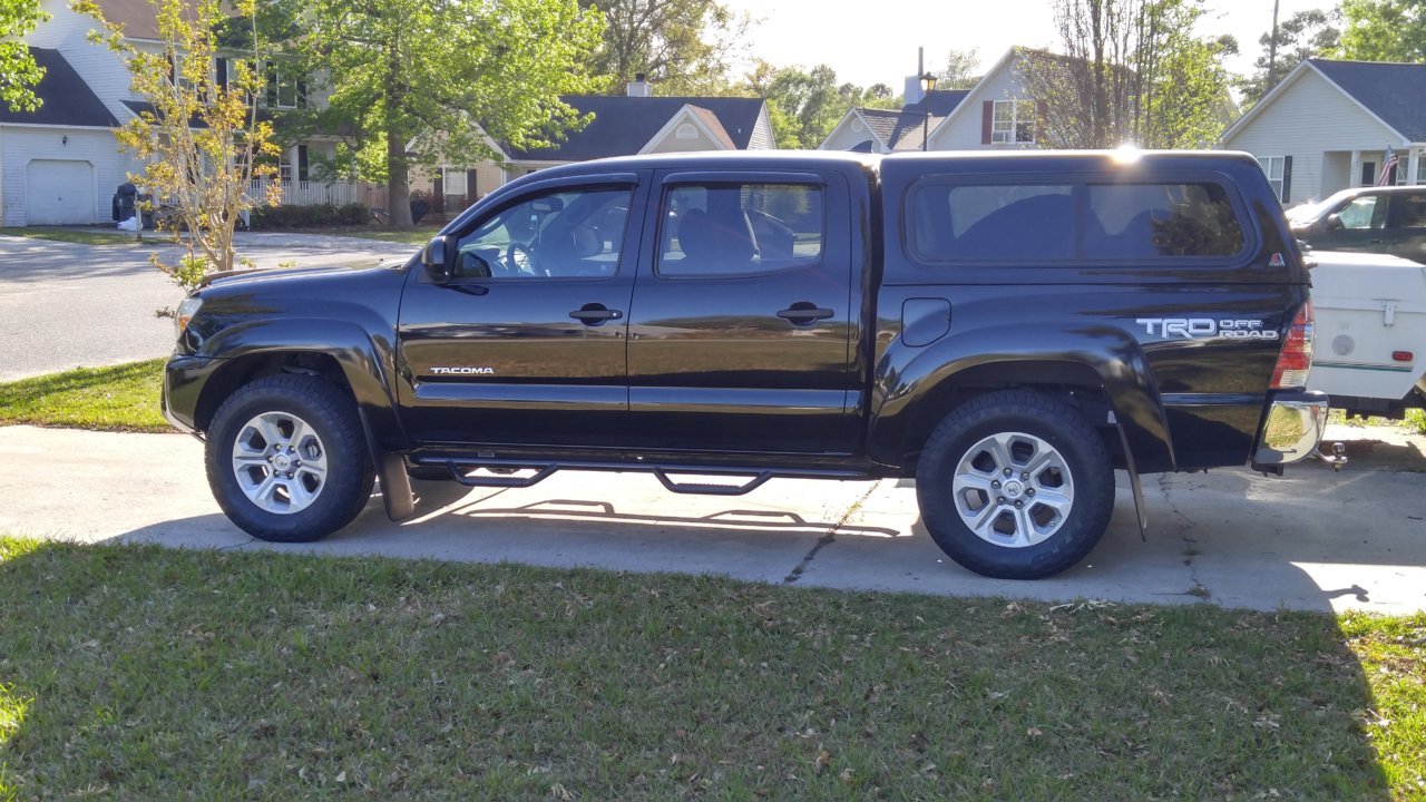

    Taco.jpg The 4 runner "snowflake" wheels fit taco's perfectly and I run 265/65/17's on them. My truck originally came with the 265/70/16's. I picked up the snowflakes from marketplace as dealer takeoffs because the owner had TRD wheels installed.

    As you can see by the photo what I call the "snowflake" wheels are. Kinda like the older trans am wheels.
