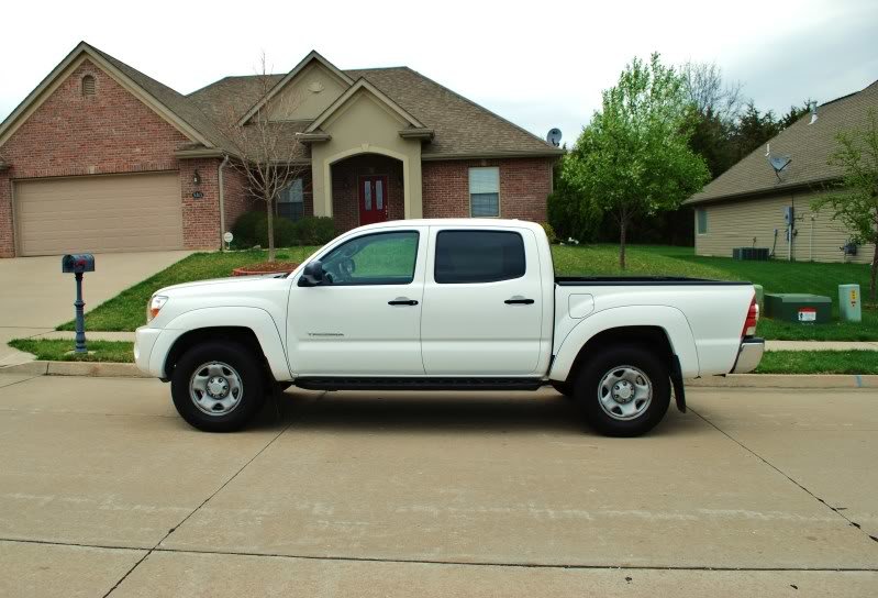

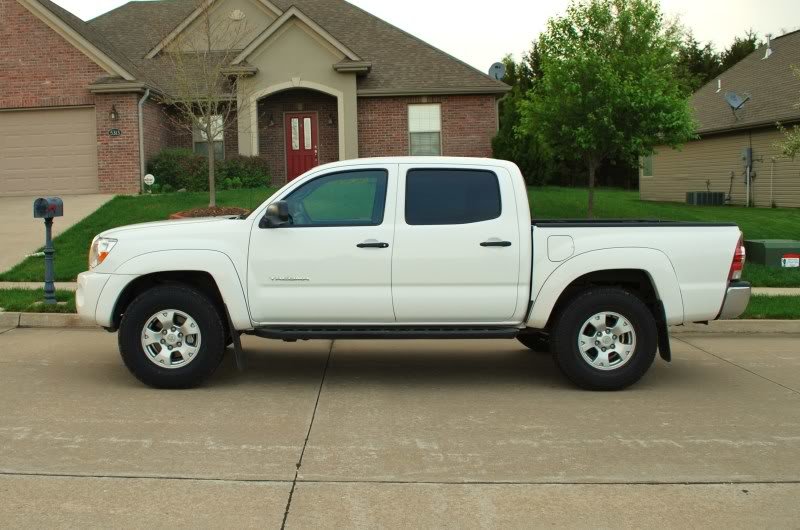

    I did it, it was a subtle change but I think the truck looks way more balanced and I was glad to have some bigger tires that are better able to handle the snows around here. I went from the 245mm Dunlops to the 265mm Hankook Dynapros. Prepare to take a loss though - I sold my steelies with the Dunlops with 5,000 miles on them for a whopping $200. I just built a pressure chamber for the TPMS sensors.
    After:
