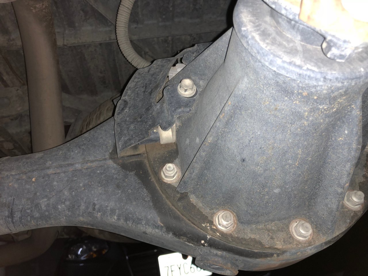

    Well my 16 TRD OR 4x2 has a seeping rear diff... my diff was inspected at 23k for the same seeping and they cleaned it and told me to monitor it to see if it continues. 23k later and my diff looks like this. my dealer told me my trucks Vin doesn't fall under the TSB that is out so they will need to charge a $145 fee to inspect. they said if they find it to be warranty then they will refund the $145 but if its not im SOL. i did do the diff breather relocation mod at the advise of this shops former shop foreman. too broke to front the $145. lmk what y'all think..

    Idk, but it seems you have some rust issues on that joint in picture #1.....
