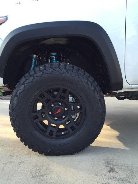

    The tire place I got them from said there actually a true 33x10.5 but the calculator shows it to be just over 35" but when you measure them there right at 33"x10.5. Not sure how it works but it does.

    Yea that's a great example of why it's important to look at manufacturer specs/measurements and not just accept that size rating. Many tires run smaller or larger than what you would expect by just looking at the 275/85r17 type rating. In my experience for some reason Japanese tires seem to run more narrow/smaller, e.g. a Nitto 295 may be as wide as a Goodyear 275. Then you have stuff like sidewall lugs that don't factor into tread width and can increase the overall width of a tire, so something like a Duratrac may give clearance issues where a same "size" Wrangler Adventurer fit fine.

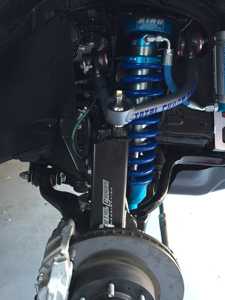

    Alright guys I was able to finish up the front yesterday. No rubbing so far even at full lock. I tried reversing down hill at full lock also and did not rub. I also did not adjust the front coils yet, I want to give the truck some time to settle. The true test will be once I get this thing offroad. The kings and ko2's combine for a super smooth ride. I plan to make a build page soon after a couple more mods. I will report back with more results.
