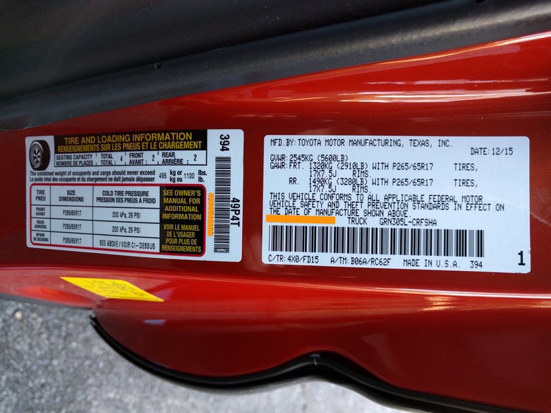

    Build date?
  4. Feb 9, 2016 at 9:51 AM
    desantim
    desantim [OP] Well-Known Member
    May 6, 2013
    #103608
    138
    Mario
    Oregon
    Not sure, where would I find that information?
  5. Feb 9, 2016 at 9:52 AM
    usadaytrader
    usadaytrader Well-Known Member
    Nov 8, 2008
    #10592
    1,132
    Probably the on drivers side door. Near the latch
  6. Feb 9, 2016 at 9:56 AM
    desantim
    May 6, 2013
    #103608
    138
    Mario
    Oregon
    From what I can tell, 12/15?
