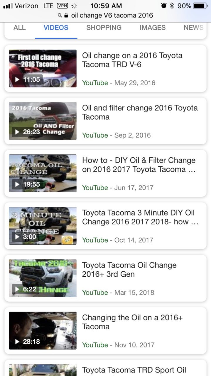

  17. Aug 23, 2018 at 9:39 AM
    #17
    Tacowin1013
    Tacowin1013 Well-Known Member
    Dec 20, 2016
    #205311
    2,628
    2017 OR DCSB 6MT MGM
    Also works if you dont' like your local walmart. I can't stand it, but will go to the automotive department get the 5 qt jug for $22-$25 dollars and submit the rebate to Mobil 1 and get $12 back for each jug. This way my oil changes with the filters are pretty cheap
