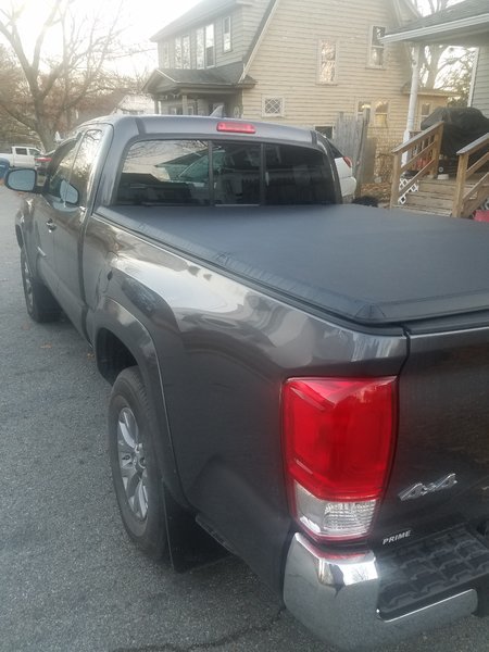

    So it came today and couldnt wait to open the box. I dont see any reason it wont fit my 16. It is too damn cold right now to try but I measured my dads track and mine and they are exactly the same distance apart. It came with a foam tape strip to put down across from rail of bed (mine is square and he dont have one.) so I assume it was to fill the gap he would have. The only thing I didnt see (but didnt dig through the bag) was the piece to fill the gap at the end of the square tube but I will cut squares off the end of the strip I got. For the record, this 15 version I bought on ebay and the seller wanted 159.99 or make an offer and I figured he would meet me half way between his price and my offer and I offered him 140 and he took it. free shipping. Thats a big diff in price to the 16 tri fold.

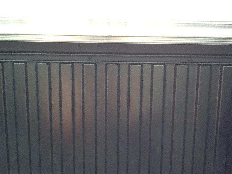

    The 2015 header rail will fit on your 2016. Here is a pic on my sport access cab under the Revolver x2image.jpg

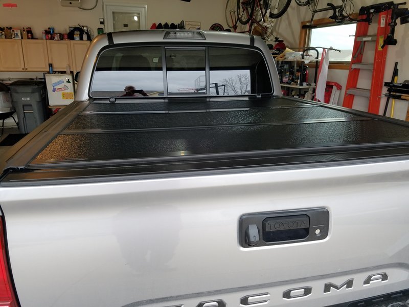

    Undercover flex tonneau
