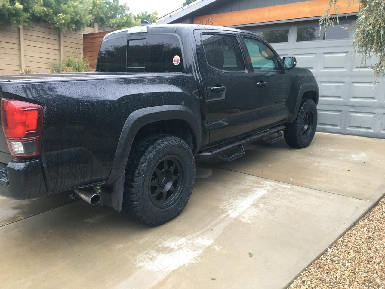

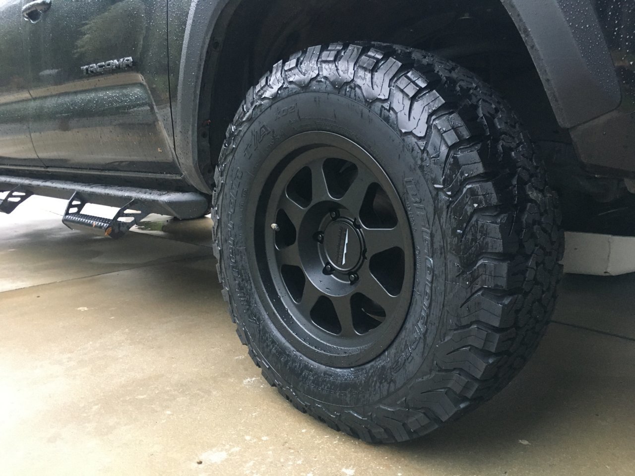

    Ok... so.... I've been a bit busy with work but I thought I'd update everyone on what I went with and the end result incase they go down the same or similar path!
    I opted for some Method 701s - 17 inch x 8.5 with 0 offset. I paired them with some BFG K02s 265-70-17s.
    Running this on a 100 percent completely stock 2021 TRD OR package (no upgrades beyond the normal to the lift/suspension/etc) I have complete clearance and zero rubbing issues running this set up. A full-sized spare wheel/tire fits completely fine under the truck bed.
    Thank you ALL for your help!

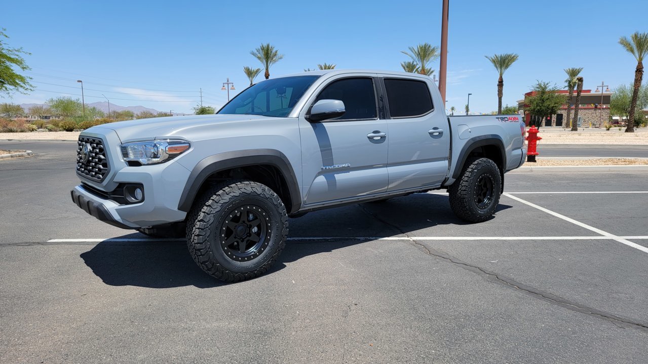

    I went 16's because I like more side wall. I'm running scs br6's with 265/75r16's on my stock suspension 20210519_115237.jpg
