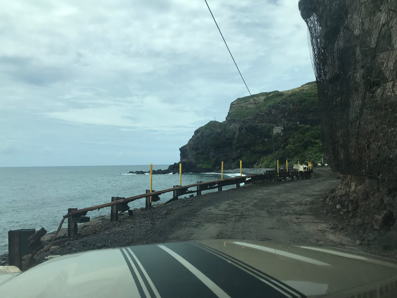

    I've always leaned toward smaller diameter rims. Over time I've found optimum satisfaction with E-range 265 75 R16 KO2's at 30psi when hot. Any lower pressure makes handling feel sketchy.
    My priority is a supple ride and good handling & traction running fast on the rough surfaces on my local roads, and decent traction on mud & wet grass uphills.
    I see a lot of folks on here switch to 17" or larger wheels. Am I correct in thinking that larger wheels give less air cushioning and more harshness? Interested in other opinions on this.
    Taco Kalepa.jpg Tires here need to be tough to refuse nails and sharp lava rock on roadway and on sides.
