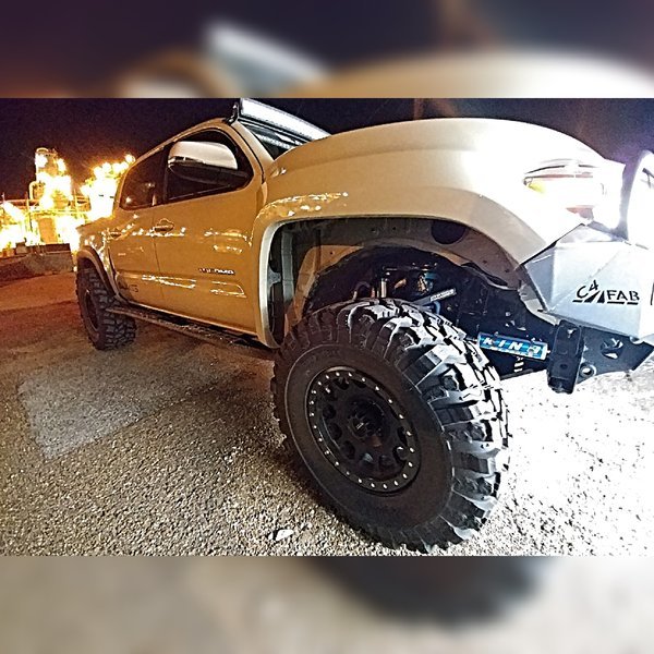

    Good call. I would have pulled the trigger on the copper but not available. Missed it by a few hours. I am going to go with Matte Bronze and looking at 285/70/17. The picture below from the Ray10 thread is that setup. I should have around a 3" lift when I get everything setup.
    TacoSharky[QUOTED] and arnette64 like this.
