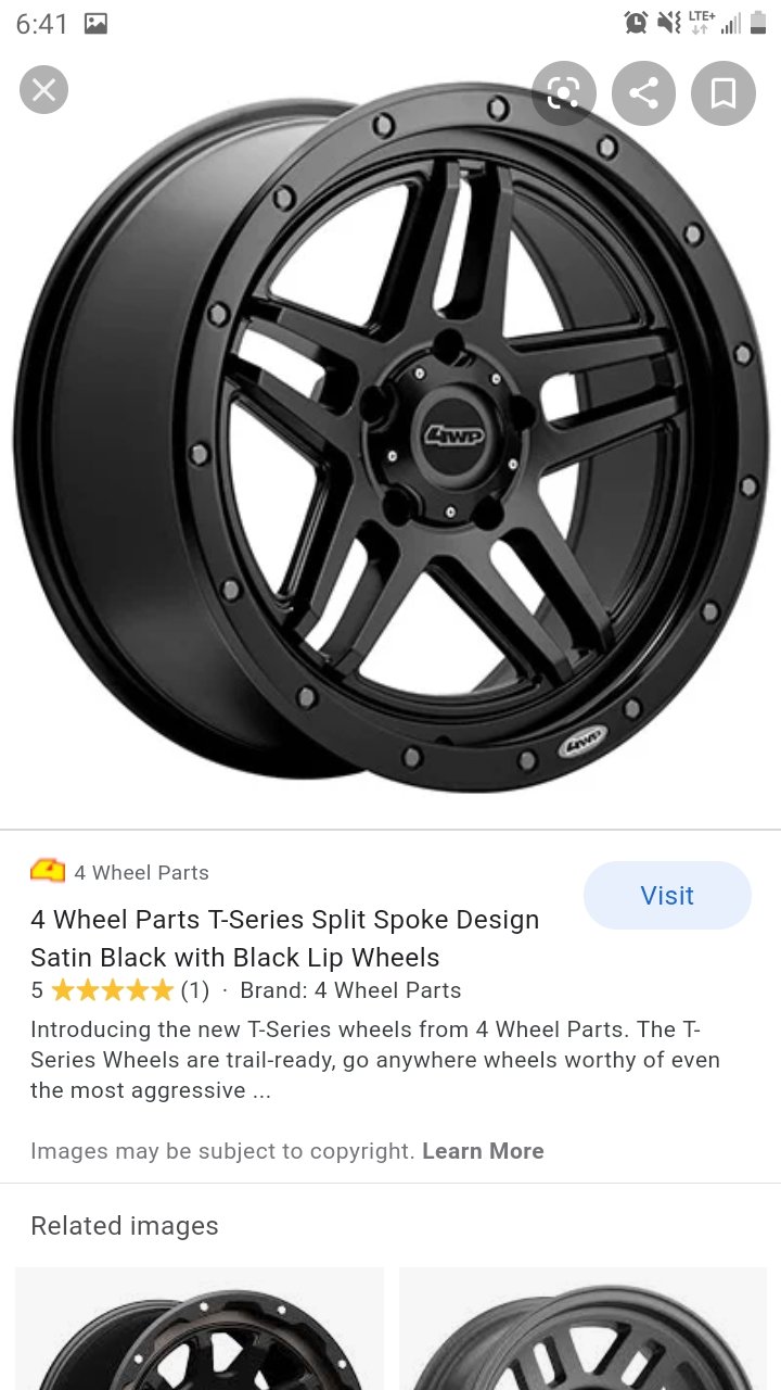

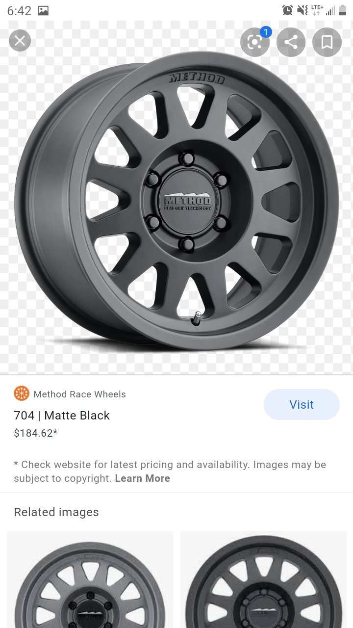

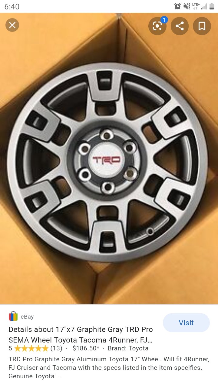

    I think I'll go 17s as well. These are the four I've narrowed my list down to. Does anyone know if there is a certain wheel width that makes fitting the 285 easier? I would think narrower so the tire sits taller to keep it away from the upper control arm. But that's just a guess

    Mrnond 101 those are the 17’ 4 runner rims right? Do you have a lift on ur taco? And what size tire are you running on that?
