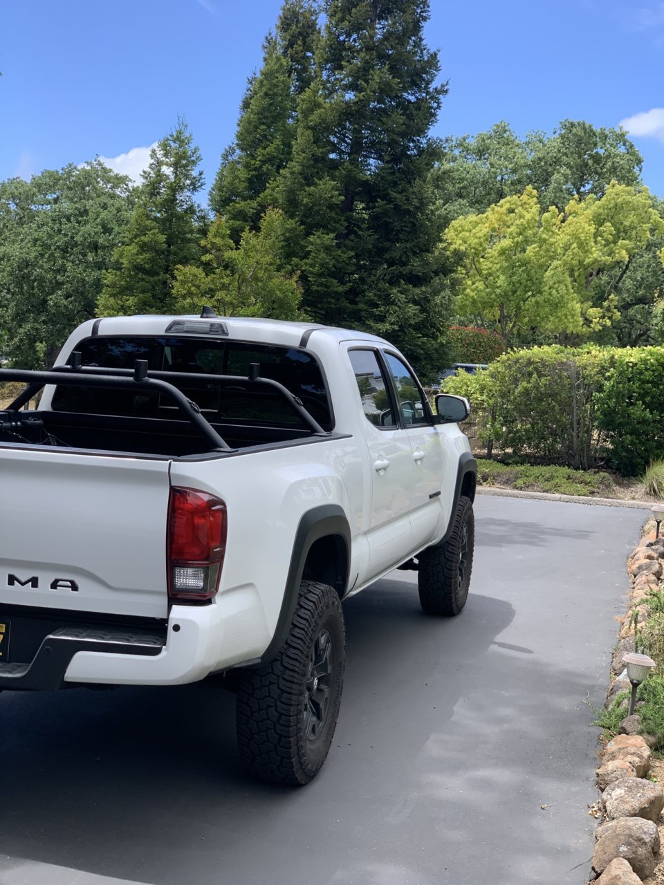

    Reason enough for me to say 16"

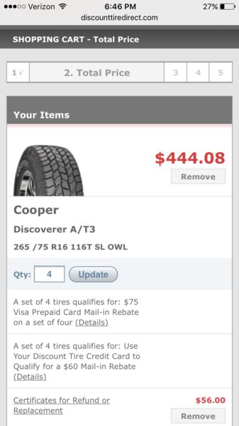

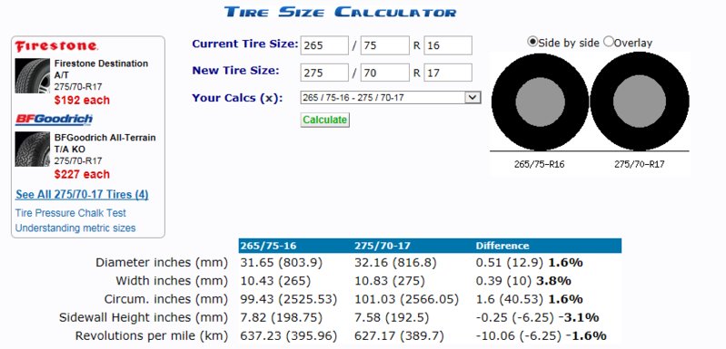

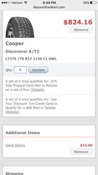

    You're comparing apples to oranges.
    A 265/70/17 is a more accurate comparison to the 265/75/16.
    Albeit you are correct that the 16" tire is still cheaper that the 17" option, but not quite by the landslide the screenshot depicts. For the Cooper AT3, its more in the neighborhood of $75-100 depending on where you purchase.
