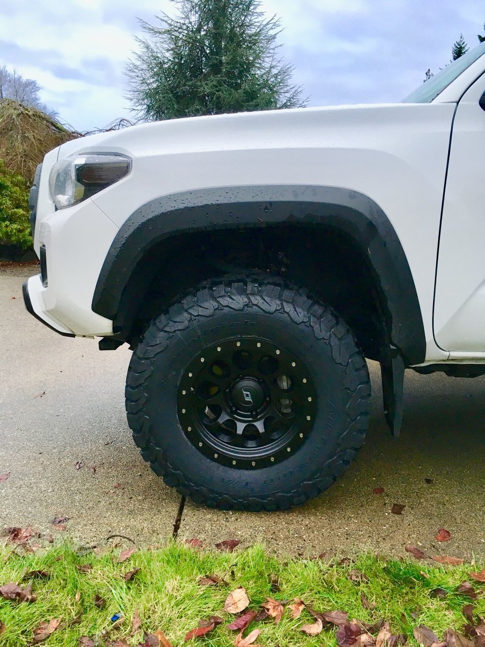

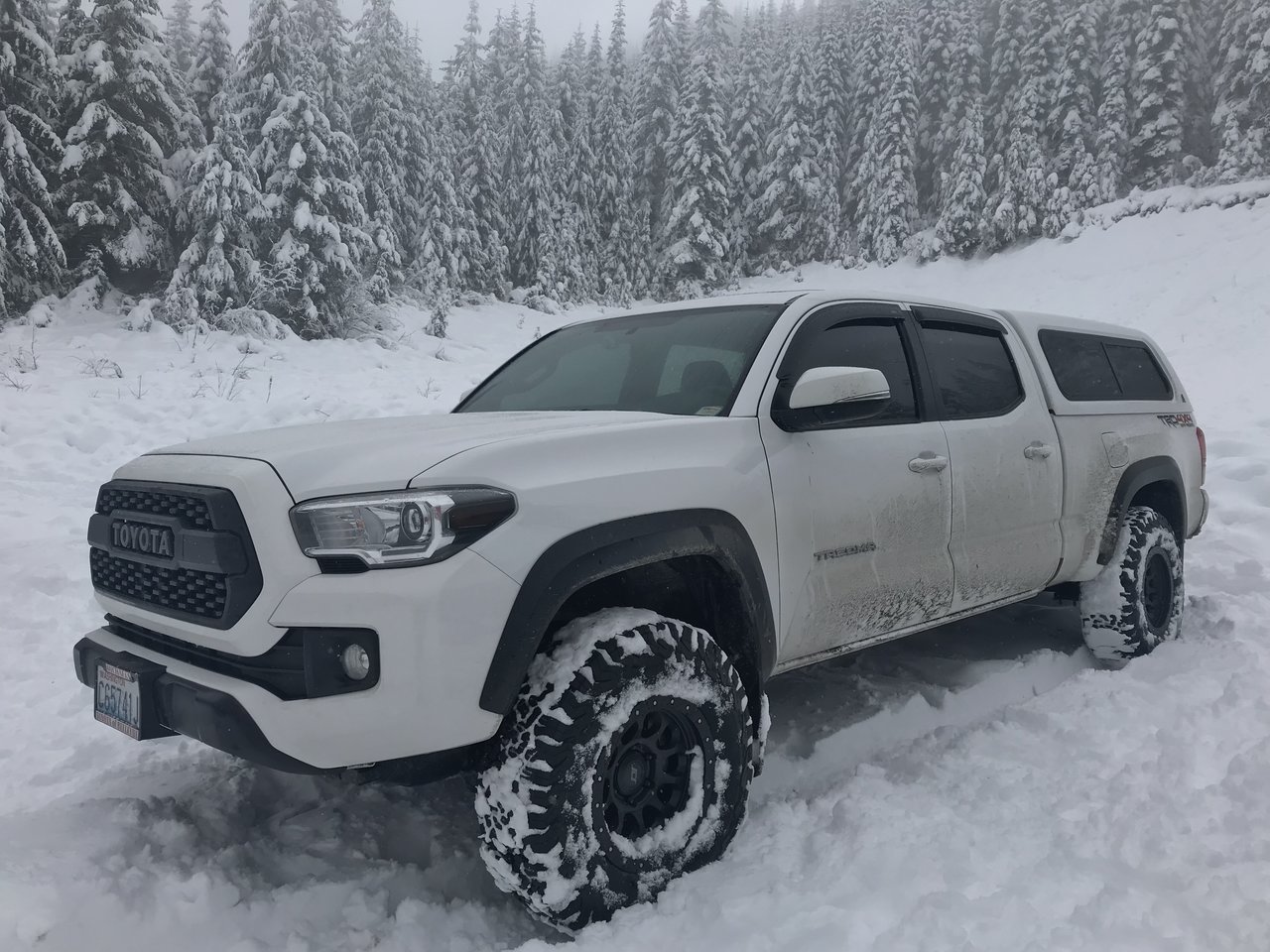

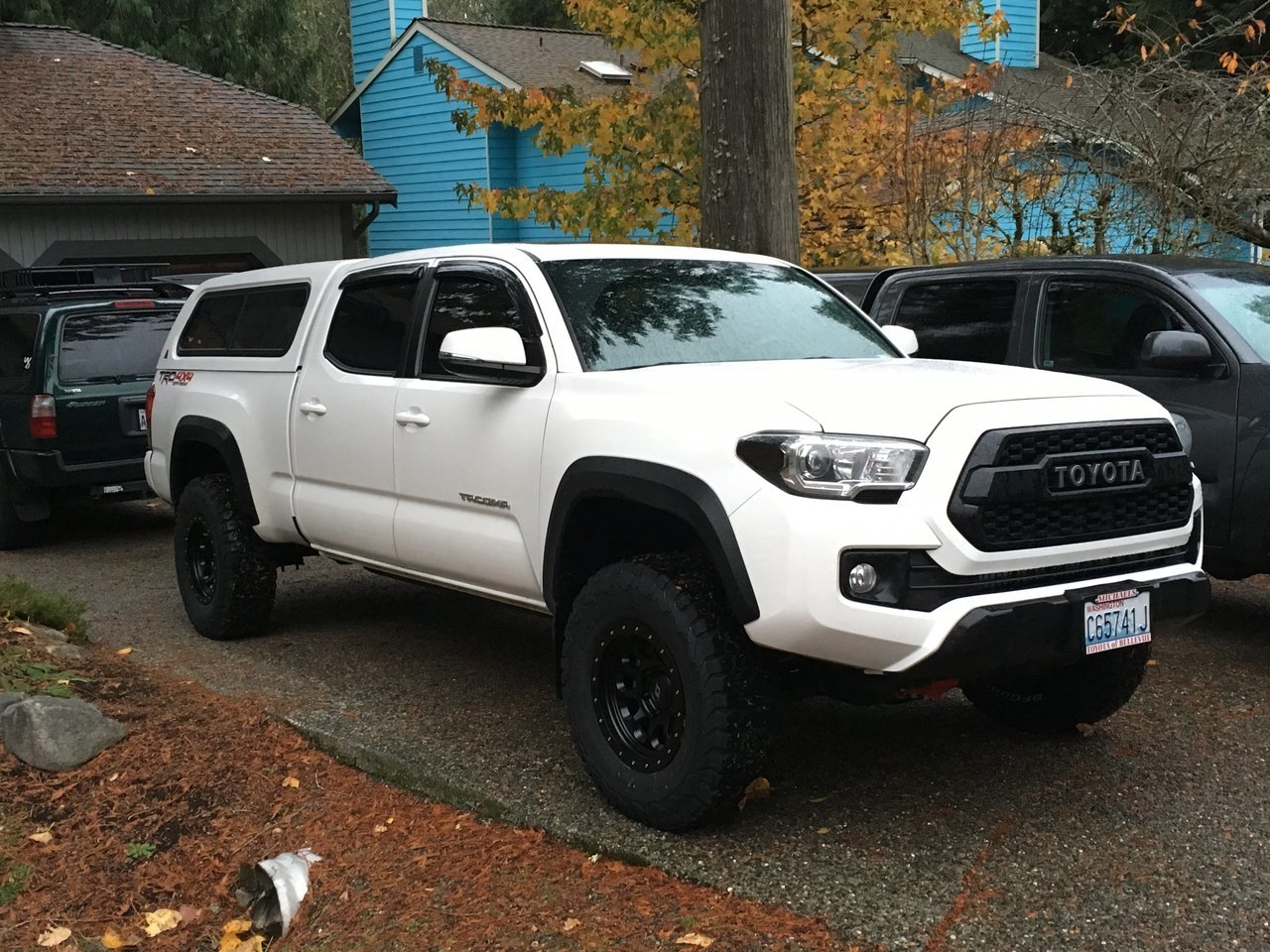

    Toytec Alumaseries Coilovers OME El111R Camburg UCAs Scs sr8 17” 285/70/17 KO2
    16” Ray10
    265/75/16

    Any full truck pics and can you share lift and backspacing info?
    Thanks!
  8. Dec 28, 2017 at 2:48 PM
    1cleanFG
    1cleanFG DialsGarage
    Jan 19, 2016
    #175465
    681
    DialsGarage
    PNW
    2023 Sport 4x4 DCLB
    16x8 4.00” BS
    -12mm offset
    Front lift: 5100 on 3rd notch
    Rear lift: 5100 w/ Toytec 1.5” block
    Best pics I have for now, lighting sucked lol.
