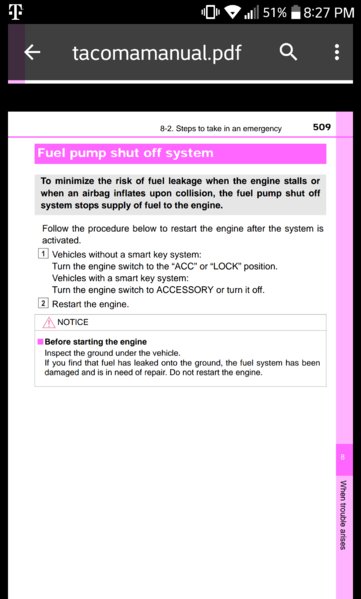

    Do Tacomas have an emergency shut off switch on fuel pump? Fords do. It is behind the passenger side kick panel or use to be.

    Looks like a pretty simple reset on the Tacoma.
