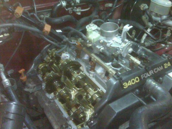

    2003 3.4 engine, is anyone doing this themselves? or should i have toyota do the work ( $600.00)

    If you are comfortable pulling the upper intake off, it is really not such a bad job. You will need a FSM though. You can get around needing the SST with a couple of screwdrivers. You would want to make sure your dealer has shims in stock before you start.

    Wow looks fun. I wanted to do this a few years ago on my 3.4 at 250,000 miles and my mechanic friends talked me out of it with some very sound rationale and still going strong.

    I think ill let an experienced tech, handle it this time
