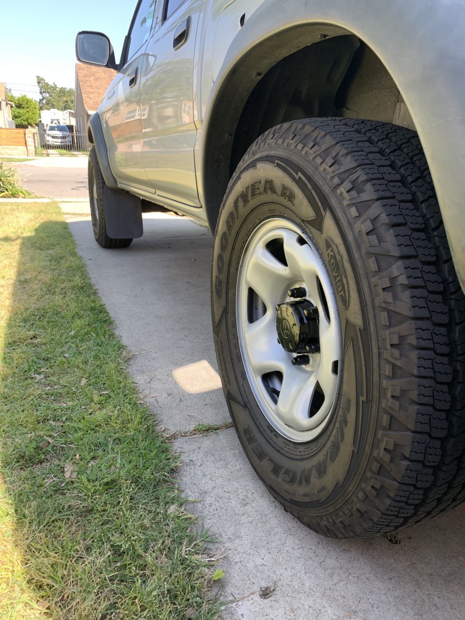

    I’d have to look up the specs on the wheels I bought for the same purpose - 33s and tundra brakes. They are 16x8 not sure of the back spacing. One hack I used was shopping for wheels that “fit” a 2005 tundra on those website firms that guides

    Most 16" wheels will fit Tundra caliplers, so you'll likely be fine there - but once you know the wheels you want, feel free to post up here and people can tell you if they've tried them. @ekul310's suggestion of checking if they fit a 2005 Tundra is a great one as well!
    Backspacing won't really affect whether you can fit 33's - it will just affect where you will rub/have to clearance
    • more backspacing means clearancing on the inside/frame side
    • less backspacing means clearancing on the outside/fender side
    Stock backspacing is 4.5", so if you find something that's between 4.5" and 3.5" backspacing, you'll be good. More than 4.5" and you start to get into cases where you can rub your tire on the spindle (which you can correct with wheel spacers if need be).

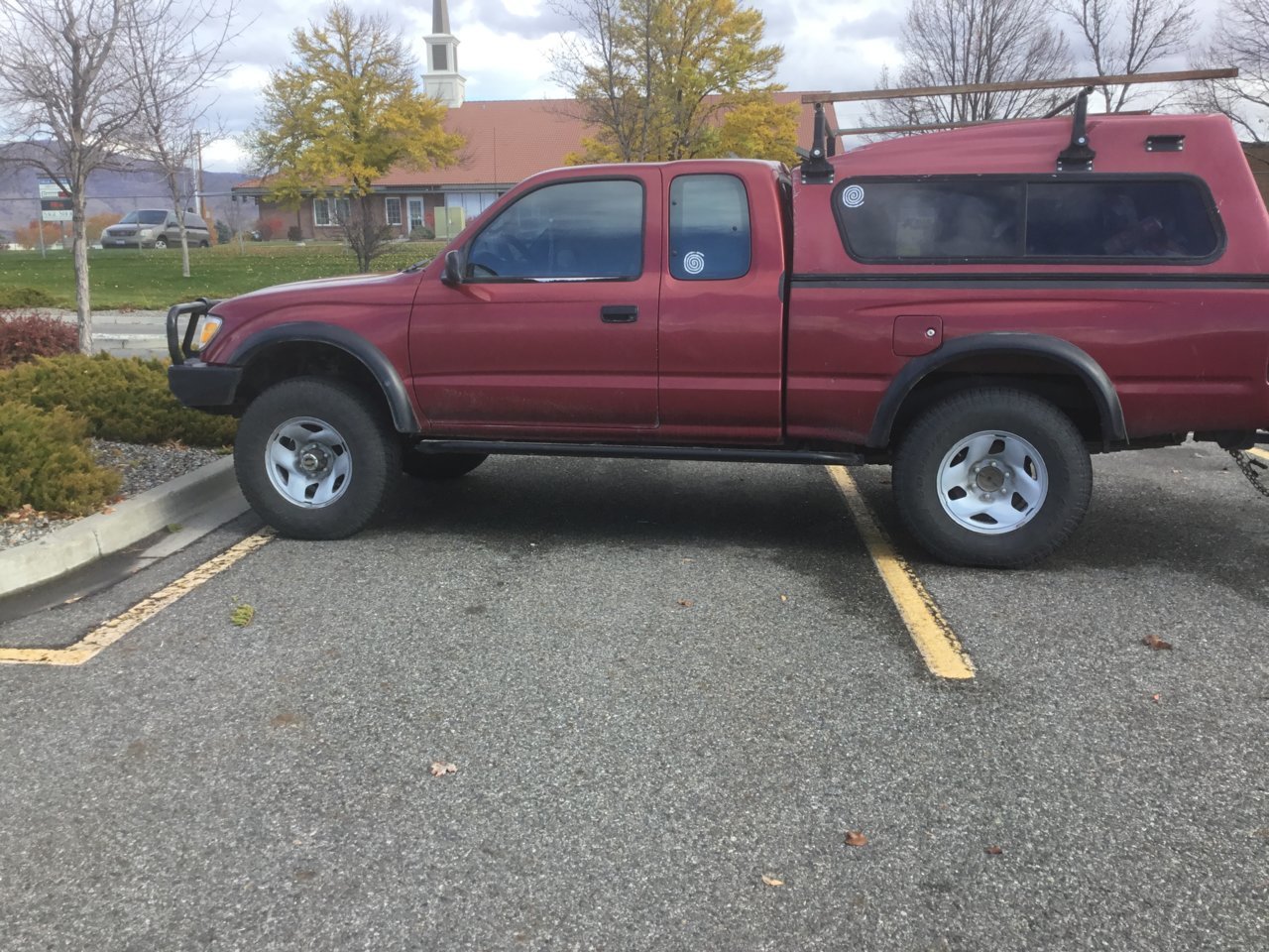

    Thanks for the Info Turbo, love your truck it looks really good. I like the steel wheels, but I am curious where the two front steel wheels came from? I know you got them from a friend, are they spares off a tundra? where would I be able to find some?

    The fronts were spares off an 01-04 Tacoma, which have all round holes. The rears were spares from a 2nd gen Tacoma, which is where you see the oval hole (and those won't fit).
    So, what you're looking for are those 01-04 Tacoma spares. I'm not sure that many really know the difference as they sell them though, so that's where the difficulty is going to come in.
