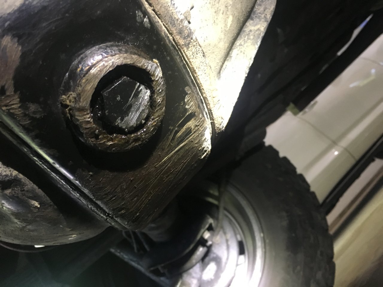

    The protective ring is doing its job.

    Yes, but the drain plug was loose and dripping after 125 miles or so.
    Had to drain diff and grind the inside of the ring so I could get a socket on it.

    You've started down the path of more trouble with that plug. Both @cynicalrider and myself had to deal with that, and all just after one obstacle to give an idea how quickly it could happen.

    Damn. I had to take the pilot out of a hole saw to cut back the schmear just to get on my plug.

    I threw a trail gear plug in haven't had any real issues since. But haven't really dragged the diff over much since I did it.
