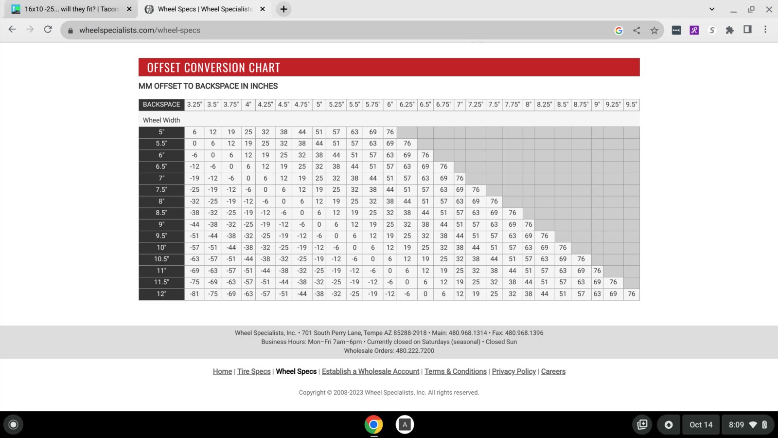

    Assuming the wheel is aluminum and not steel it shouldn't rub the caliper. The OEM 16x7" wheels have +25mm offset or 5" backspacing. 16x10" wheels with -25mm offset will have 4.5" backspacing so you actually have .5" more clearance on the back side. With a wheel that wide, plan on doing the usual CMC or relocation, pinch weld flattening and bumper/fender trimming. What size tire are you wanting to run?
