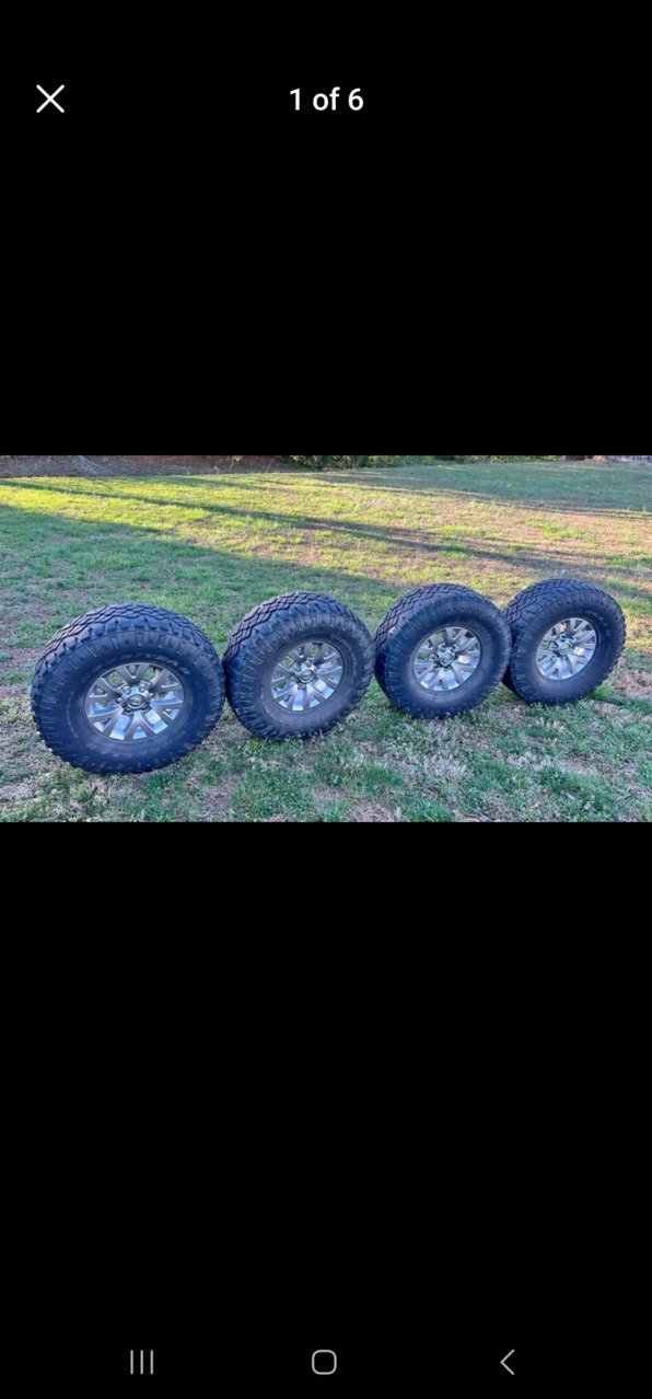

    Not much information on this kind of set up and wanted to see if anybody had any feedback on cost to mount, experience on short and long term of running this on their tacoma. Running a lower psi and any concerns

    How are you going to get/make them fit? Major rub-a-dub-dub.

    You'll need an 8" minimum width rim and if it were me I would want 8.5" or 9". The 16x7 in the posting title is really pushing it and not recommended by tire manufacturers which typically are going to call for an 8-11" rim. YMMV - I am sure it is being done or has been done.
    edit: I should add that you will need some serious spacers if you are rolling on OEM 16x7" rims

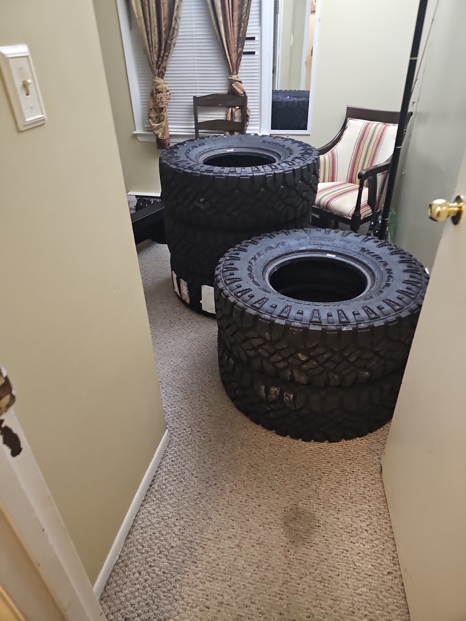

    Nice set of chairs!

    nice tires, I'm surprised you store them inside the house though, let's just say the smell is strong

    so they would be considered 34.5 or 35's either way they should look sick cant wait to see them on the truck

    Not recommended. But you should be fine on 7” unless you air them down a lot. Could pop a bead easier. I like the look though!

    how heavy are those 315s?
    Always like the look of the thick tires on a 16" wheel

    That's has to be like a 70 lb tire. Welcome to 10-12mpg club.:)

    As long as you have the right offset on the wheels, got rid of the fender lining, rolled the pinch-welds (which I assume you did given the cab relo) - you should be fine.

    Poor mans beadlock. I have seen folks run tires like this on 7" wheels but not ideal. probably $50 a tire to mount and balance.
    Tires will probably last 30k-40k miles. I dont run Goodyear so others can chime in.

    Looks like they are mounted on oem sr/sr5 wheels. Your gonna rub uca's with stock offset of those.

    I see wheel spacers in your future
