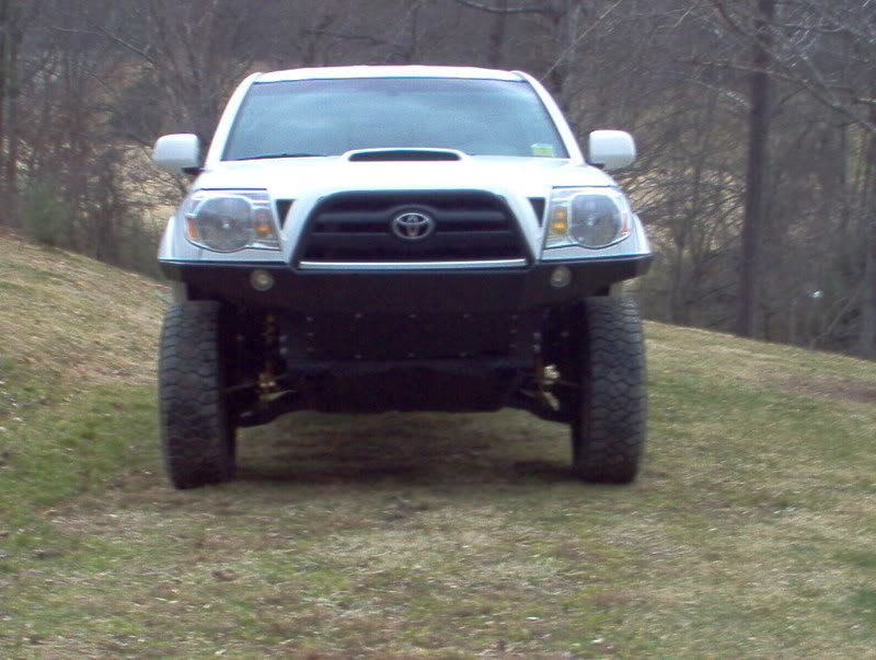

    Got the front 2.5 on this morning,going in for the TSB next wensday then im gonna need some tires,cant spring for any wheels right now.Any ideas on size for 16x7's ???
    It seems the 285/75 is for 8" wheels or bigger.I found a 255/85(33.3 x 10) in a BFG. I want 32-33 but cant find much for a 7" rim, any ideas ?
    I kinda like the skinny tire look.
    Thanks

    those 255/85/16's should look fine on there...and btw, thats only a 32x10

    damn...looks like ur right....i know the 255/75/17 is a 32, so i figured the 255/8516 was the equicalent, but that should be a 255/80/16

    That was my plan but everything I see says 8-10 inch rim.Mine's a 7 inch wide wheel,so,,,,im lost.I will keep searching.

    Just the toyota wheels 16x7,just like the spare.Not sure what model these wheels came on.

    Well they are not the wheels it came with,my stockers were 17's but I bought some black 16 inch steelies from a member here.They have stamped on them 16x7 so I assumed they were 7 inches wide but I will measure them tomorrow.Thanks for the help!!
