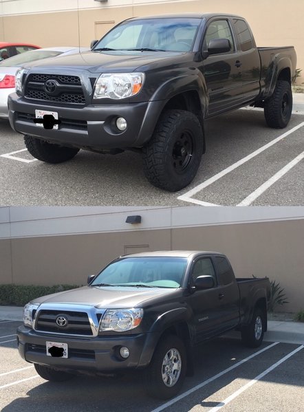

  4. Sep 14, 2016 at 9:54 AM
    tamer
    tamer hamerworx.com
    Aug 21, 2008
    #8674
    847
    NorCal
    2015 TRD OR AC, MGM, 4x4, 6spd MT
    not a close up on the wheels, but you get the idea...
    Ryanpowell88 and Sna[OP] like this.
  5. Sep 14, 2016 at 6:01 PM
    Sna
    Sna [OP] Well-Known Member
    Mar 21, 2015
    #151425
    1,395
    Alberta
    ‘15 trd sport 6MT dcsb, mostly stock?
    Those look nice....and VERY similar to the ATX Mojave wheels.
