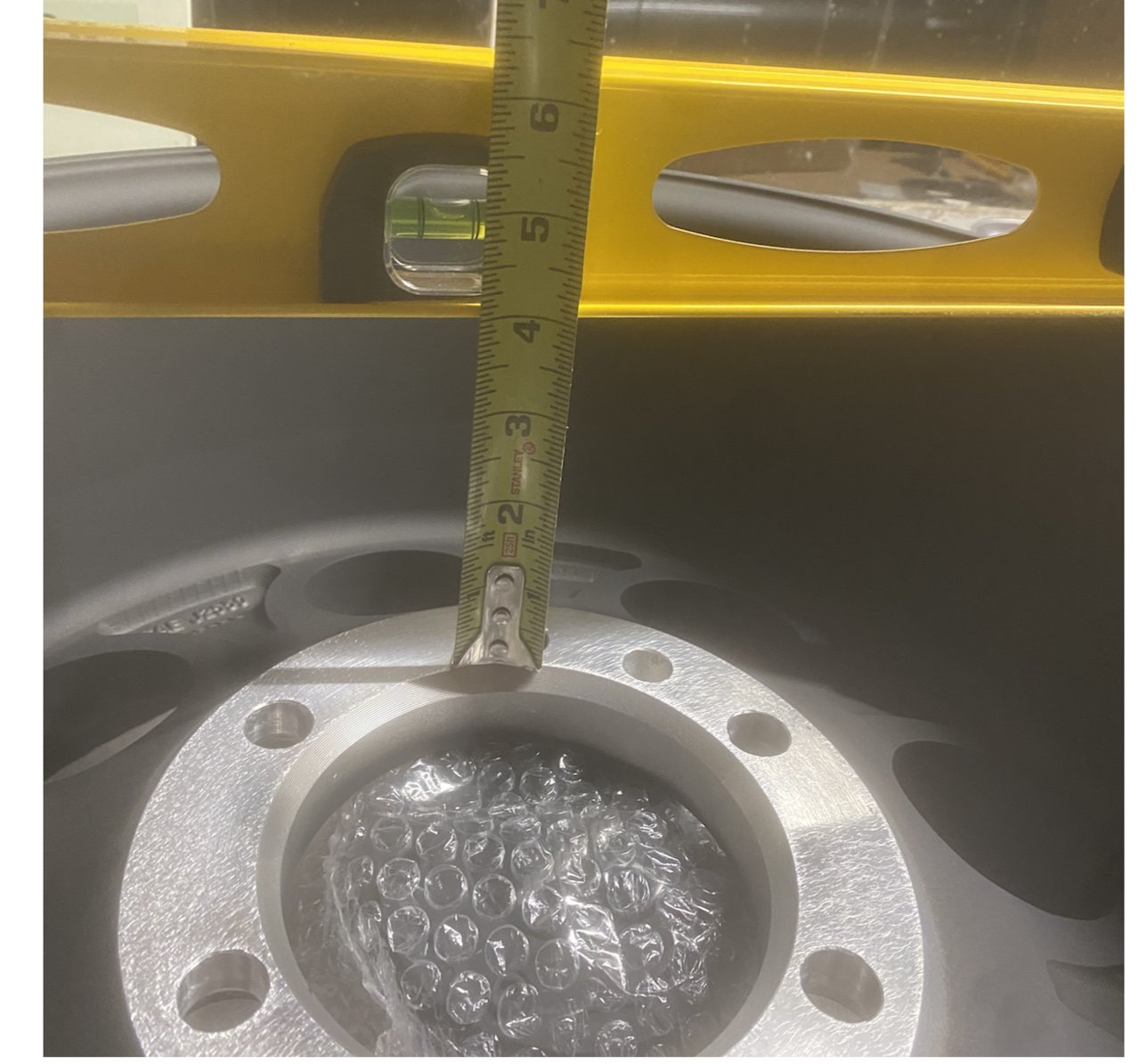

    Procomp 7069-6883 16x8:

    I just recently got some. I had 16x8 old school steelies with 285/75/16 Goodyear MTRs as my wheeling set, and the stock rims with 265/75/16 as a normal setup, but was chasing a vibration, so in a rather desperate move got new wheels and tires to rule that out. Always liked the look of the Wheelers alloy set back in the day, The ProComp 7069 is the same wheel just in matte.
