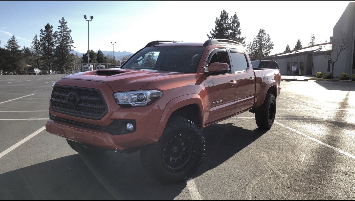

    Softopper, method NV, 265/70/17
    I've got the method NV 17. I wanted those wheels for a long long LONG time and they're 100% worth the money and then some. My brother was working at a powder coating shop here in town that also installed tires and he said they were one of the higher quality wheels he's come across. Powder coating is top notch, minimal weights for balancing which shows how well they are built
