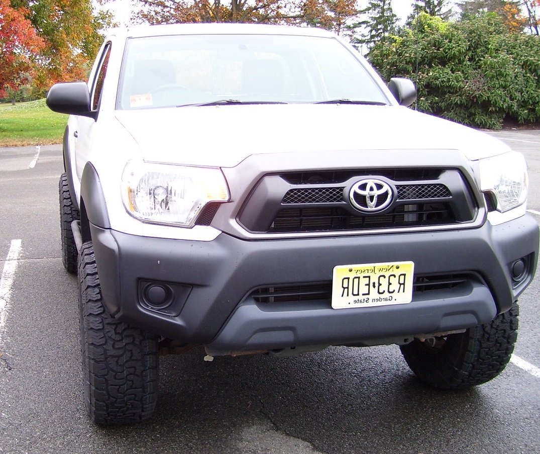

    Here's a comparison:
    First picture is with 285/75/16 on 16x8 wheels with 0 offset. It's tucked in a bit more and with flare trimming and pinchweld beat in, there was no rubbing.

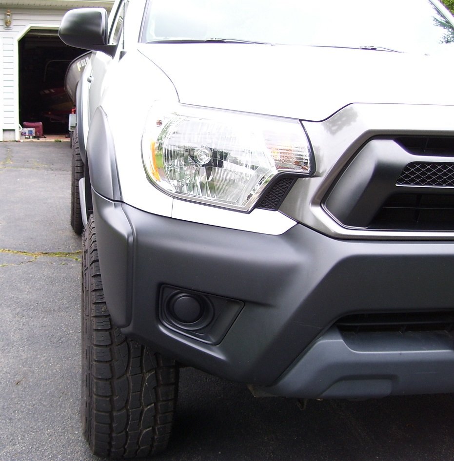

    The second picture is with 305/65/17 on 17x8.5 wheels with -10 offset. They are both around 33" tall but the 305 is obviously 20 mm wider. The wider tire on a wider wheel with -10 offset pushes it out more. This results in some minor rubbing on the body mount which would need the cmc done to get rid of. 285/70/17 would still stick out but 10 mm less. Ignore the fact that I flipped the image to be able to make a similar comparison.
