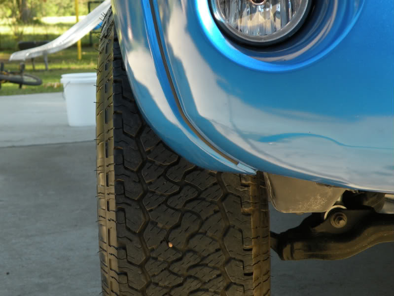

    So I have 16x10's on my truck right now, but I found some other wheels I really like and they are 16x8. I want to have the tires stick out from the fenders some, and I was wondering, if anyone has the 16x8, how much they stick out. Any help is much appreciated!

    The overall dimensions of the wheel don't directly affect how far they will stick out. That is determined by the Backspacing of the given wheel you choose.

    Sorry. 0MM offset, 4.5" Backspacing.
    That's all Latin to me, to be honest.

    XD Hoss 795 Machined/black 16x8, 0mm offset, not sure of BS.........Stock rugged trails....... I think 265/70/16..don't really feel like running outside to check

    Thanks man. that's what I was lookin for. got any more pics from different angles? If not I'm sure someone around here does. Thanks for the pic though!
