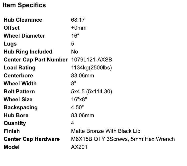

    Mmm I’m new to this so I’m not too sure these wheels are 0 offset how would I find out backspacing specs
  4. Jun 22, 2018 at 12:13 PM
    crazytone87
    crazytone87 [OP] Member
    Jun 20, 2018
    #257007
    5
    Tony
    White 2012 Tacoma access cab SR5 M/T
    These are the specs 4.5” backspace

    With 4.5” of backspace you’ll be able to fit 265/75/16s. You’re good man.

    I have the AX202's in the exact same spec (16x8 0mm offset, 4.5" backspace) on 265/75 tires. Tested on and off road, and no rub, even at full lock. You do have to remove the front mud flaps, but otherwise no CMC or trimming required.
