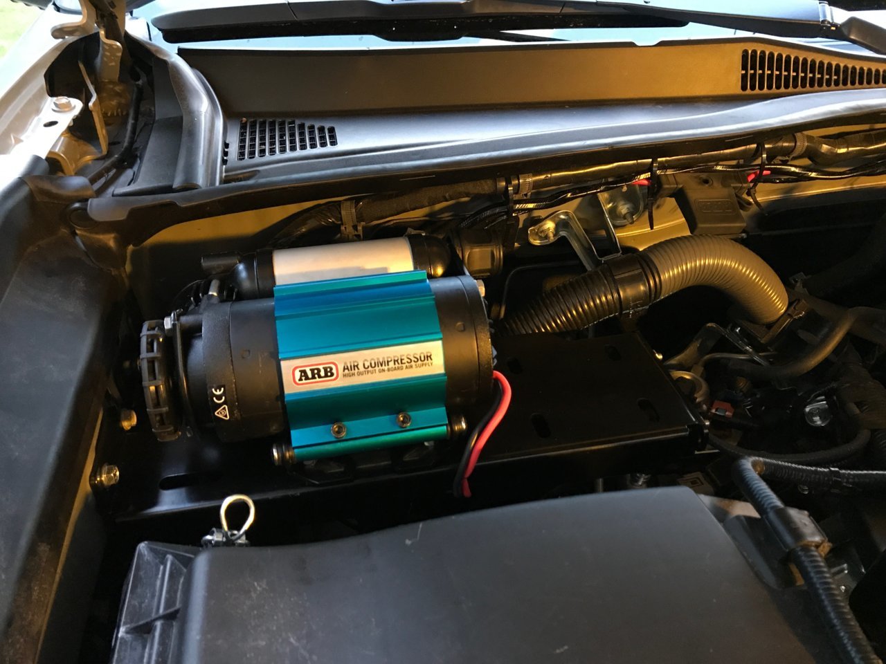

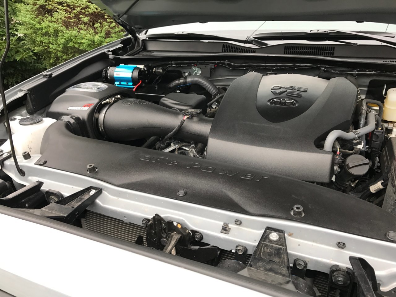

    Intake without the scoop is crap. The plug for the ram air fell out within 1 day of road driving leading me to buy the added ram air scoop.
    Arb comp on slee mount.

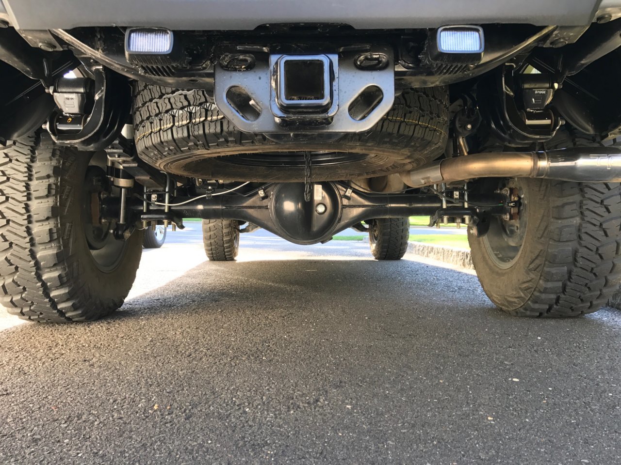

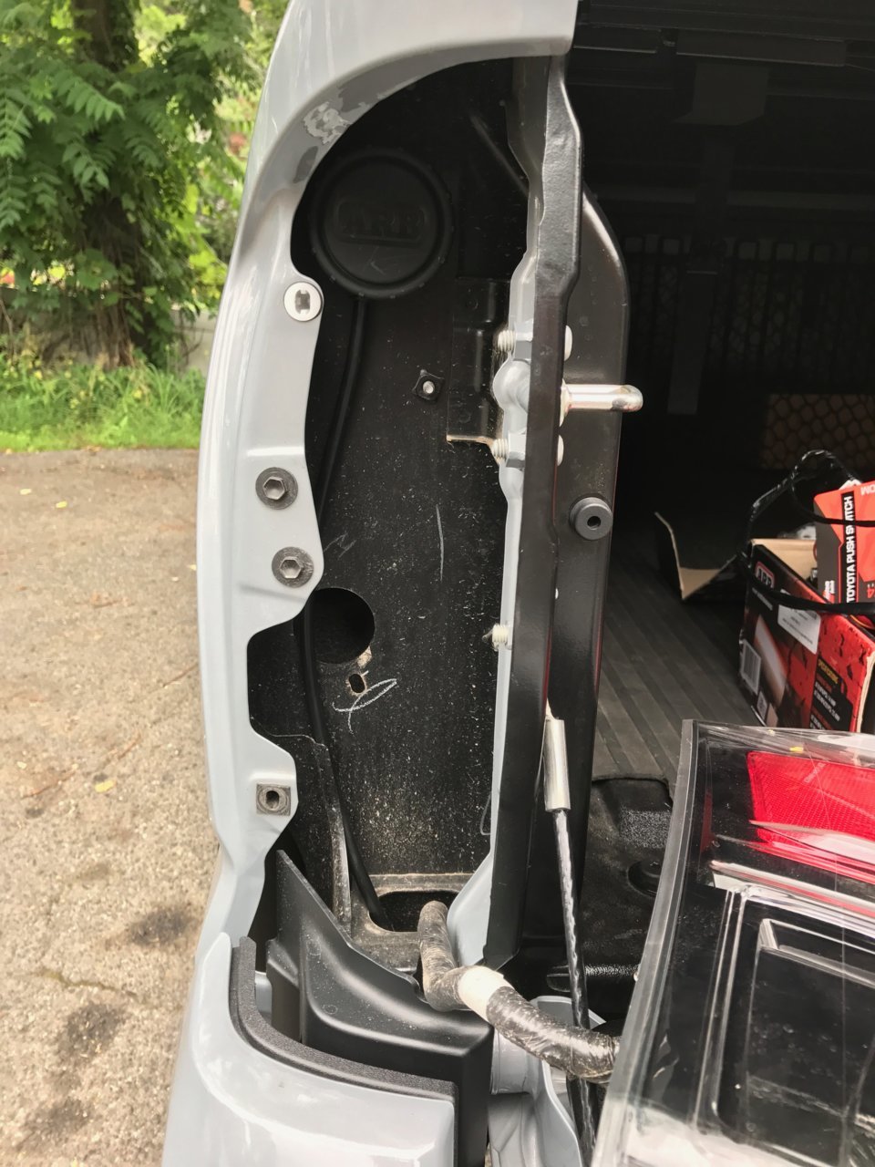

    Arb dif breather mounted in tail light
    Crappy rigid front fogs wired for reverse and F U lights.

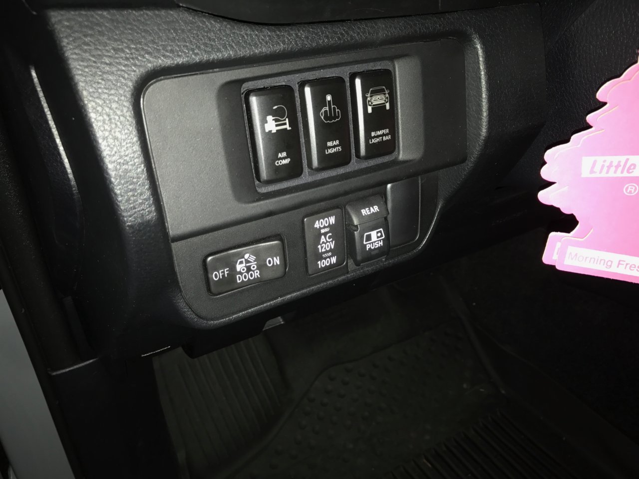

    First switch setup before the sdhq switchpros.

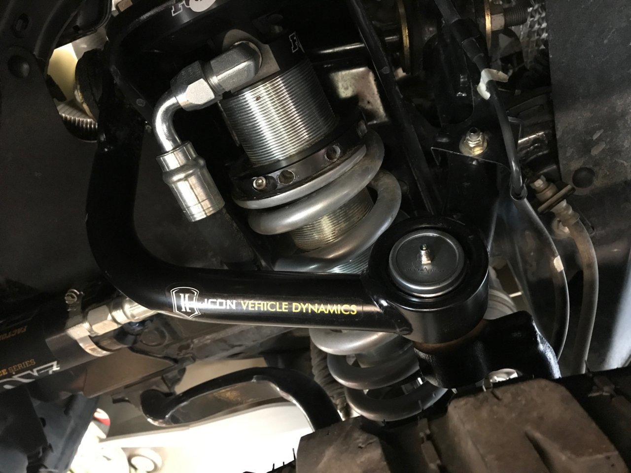

    Icon upper control arm. First bought with uniball, couldn’t take the noise so I went with their delta joint which works excellent and quiet as can be.

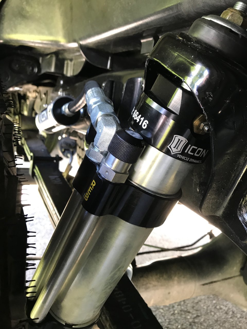

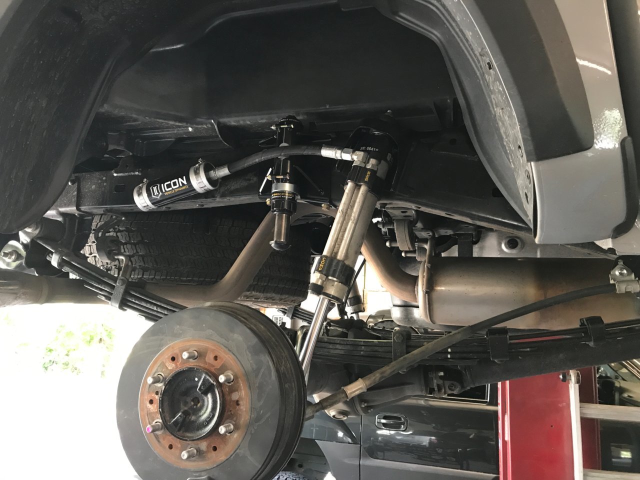

    Rear icon omega bypass. Def not valved right for no weight in bed. With bikes its decent but empty it’s still too harsh, even after rebound and comp are tuned. Def recommend for someone with weight in bed.

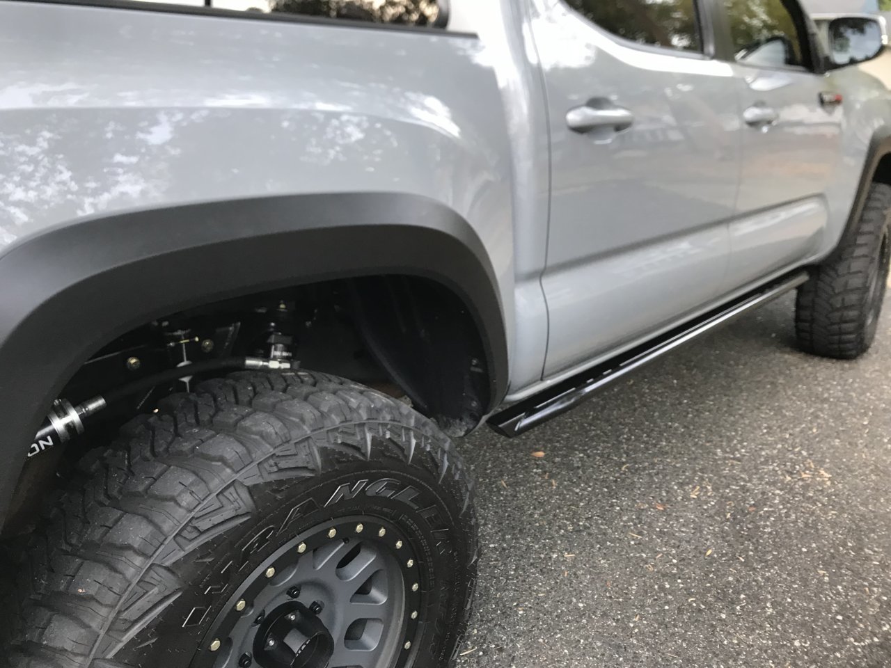

    Rockyroadoutfitters sliders. These things are solid. Definitely have the sleekest look and closest positioning to the truck. I’m not fond on the airplane wing setup most people go with but to each his own.
    I do understand why most people don’t go with these sliders because of the mounting. It mounts to the frame and the underside of the body on the pinch welds. Some say you might feel vibrations in the truck since it’s running through the body mounts but I have not had that issue. If anyone is interested in these sliders I wouldn’t use the hardware that comes with the kit. They want you to predrill the holes then use a self tapping screw in them. I nut and bolted to the frame. The hardware is weak and your drilling through a portion of frame that’s almost 3/4 inch thick. I’d be happy to further explain about these if anyone is on the fence about them.

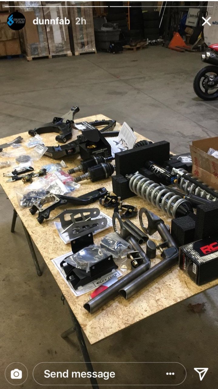

    And the last pic is what it looked like when she got dropped at Dunn fab to go under the knife.

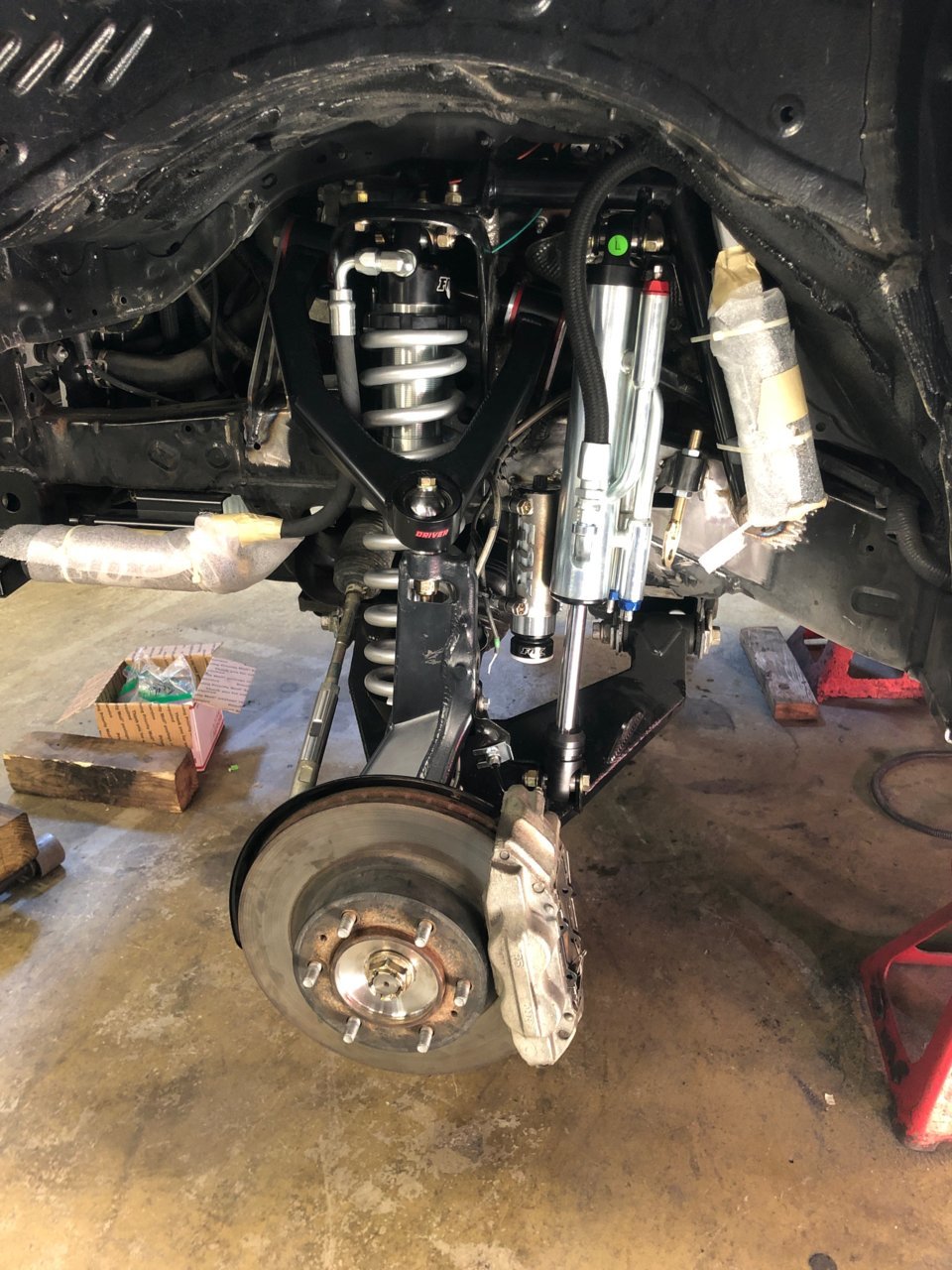

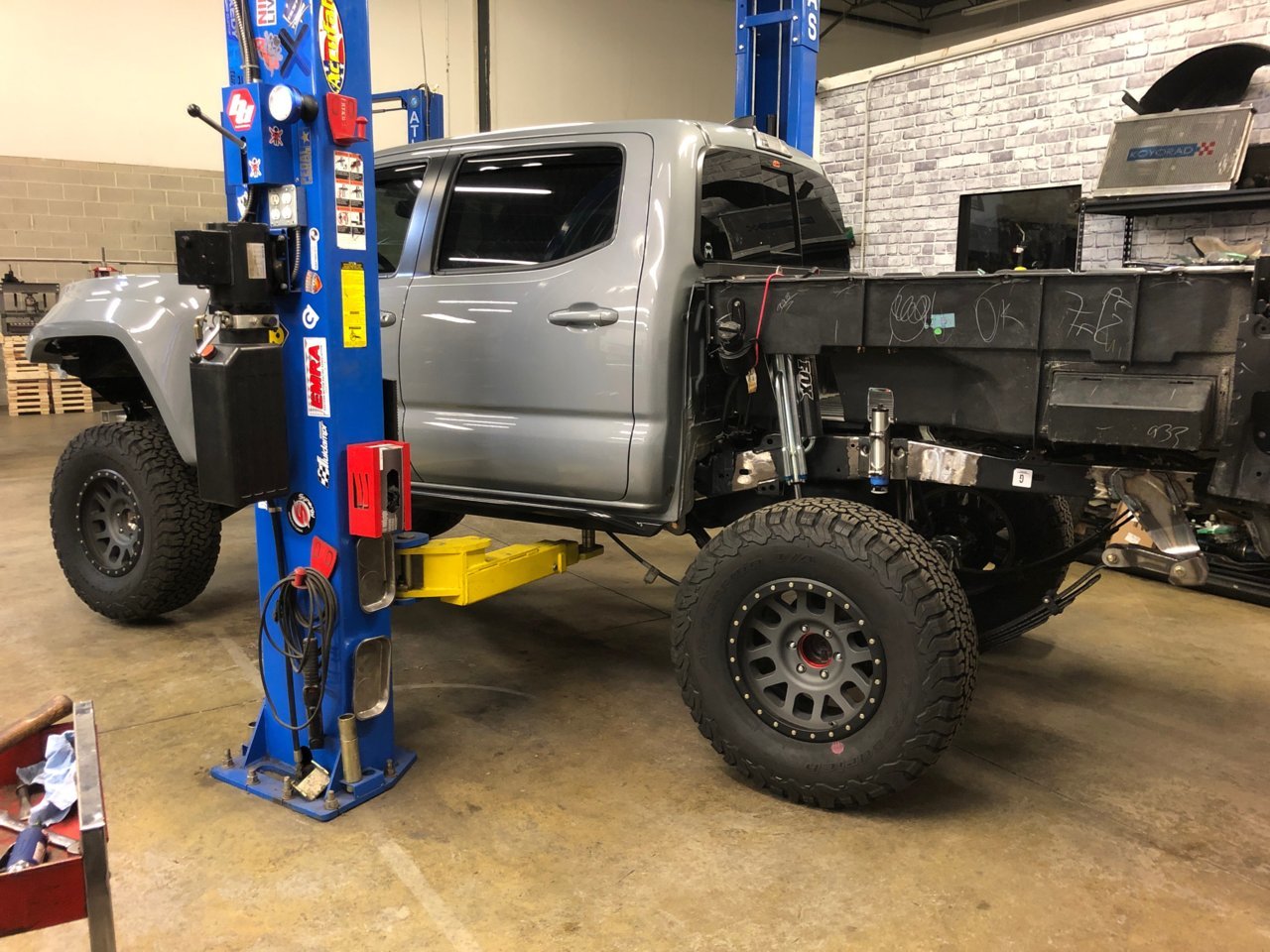

    Been a while. Here’s some updates

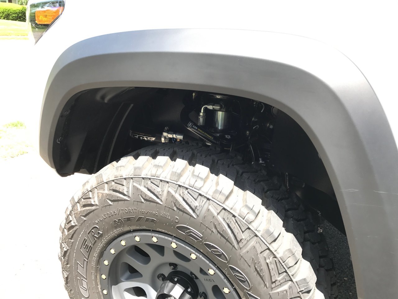

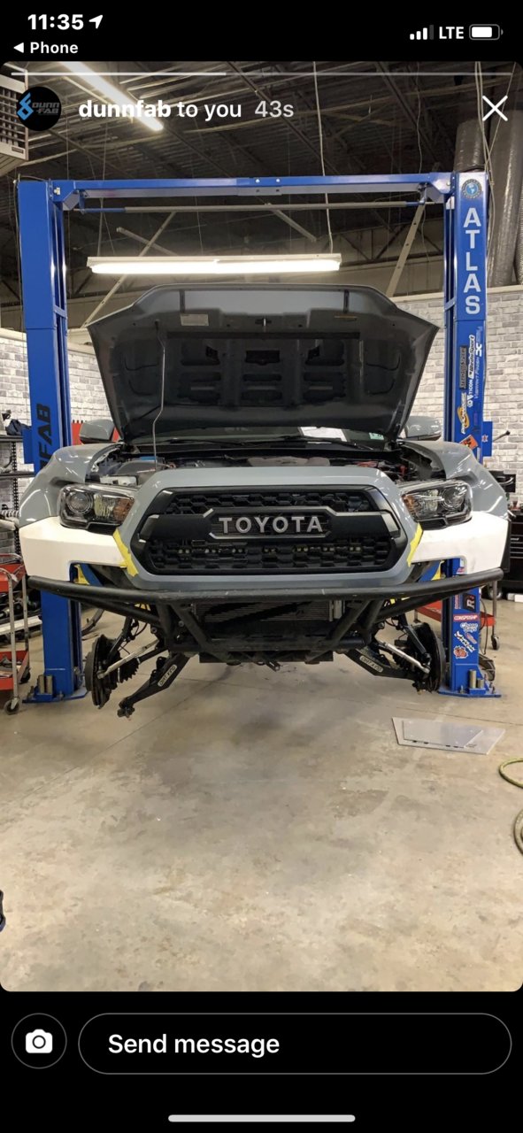

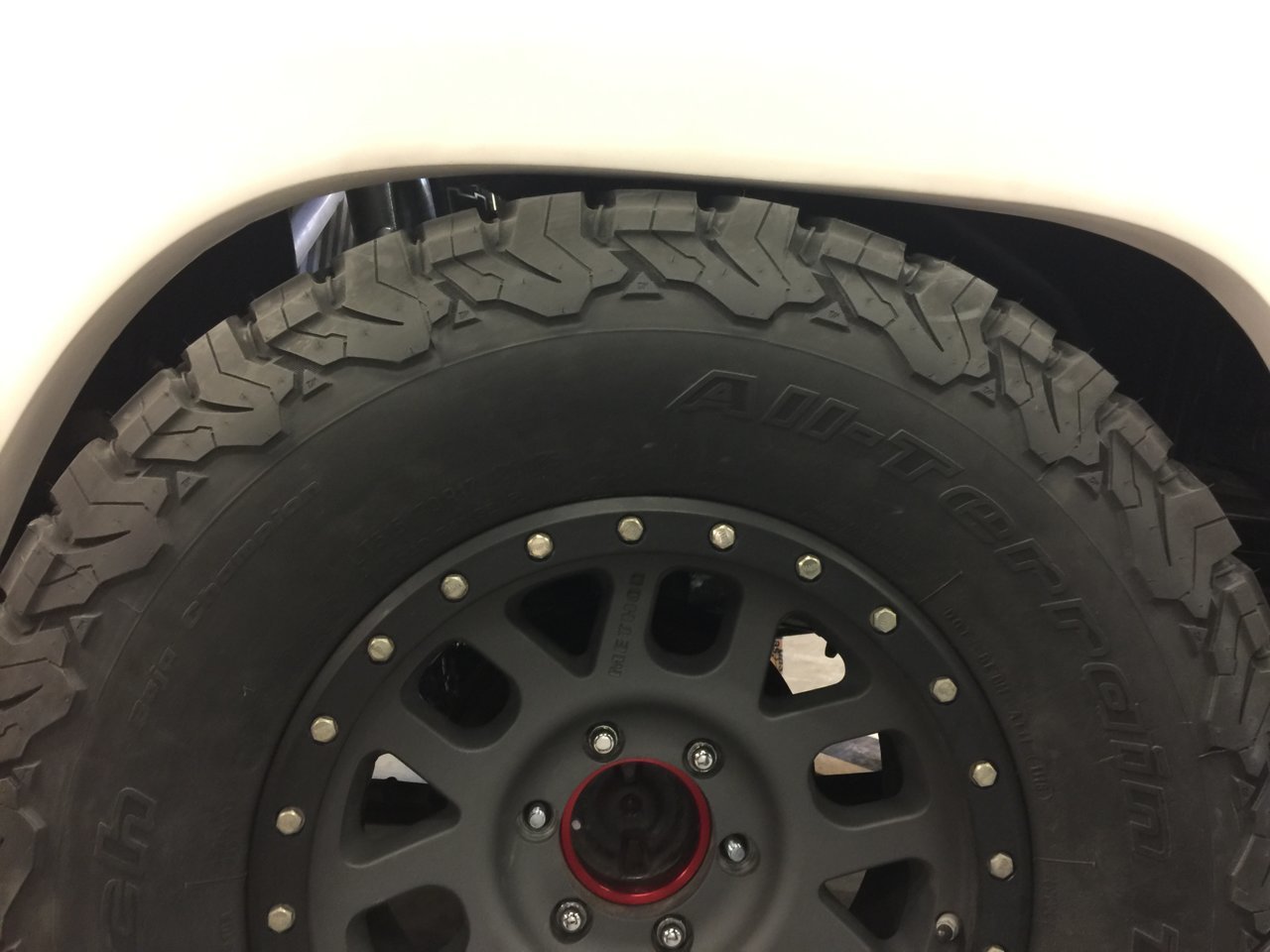

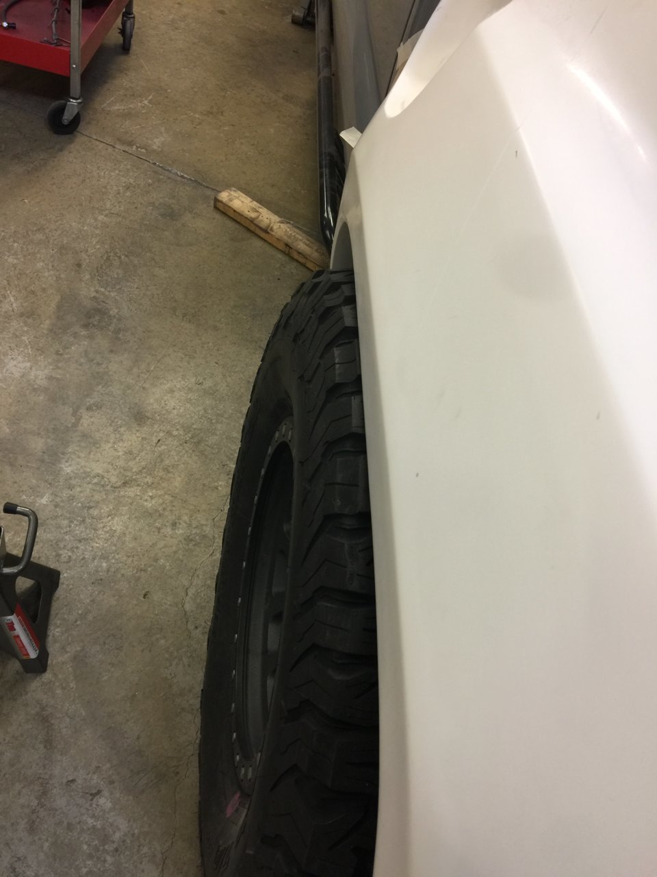

    Front end all buttoned up. Inner fender needs to be chopped so the tires can fit at full bump.
    Mcneil 3in fenders DO NOT work with a dmz spring under, 1.5 wheel spacers and 315s. I’m waiting for the 6in to come out soon. For now I’ll just hack the 3in up. It’s only money right?
    Still have 1.5 inch of travel left in the rear and the tires are hitting the fenders. They are not wide enough or high enough rise.

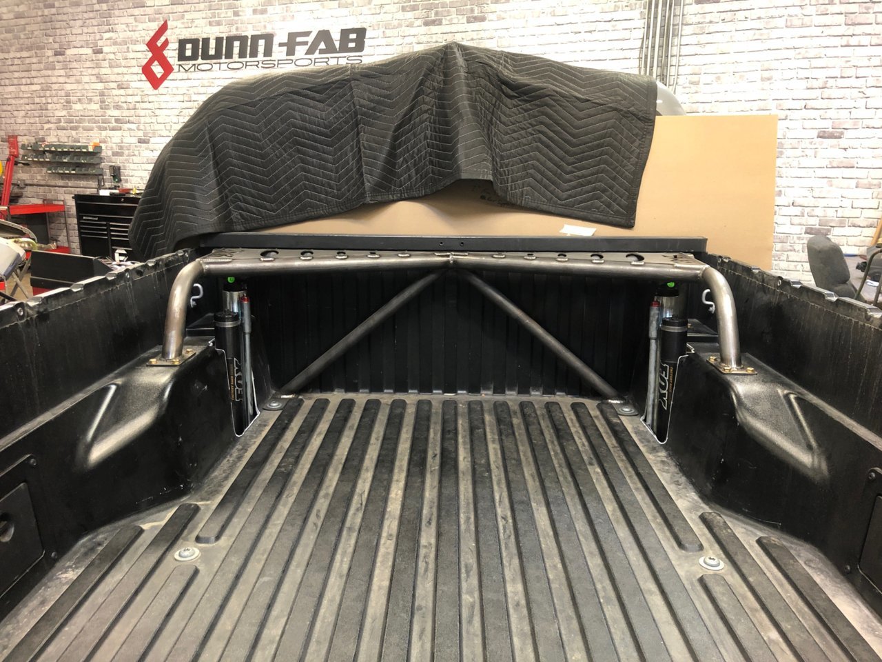

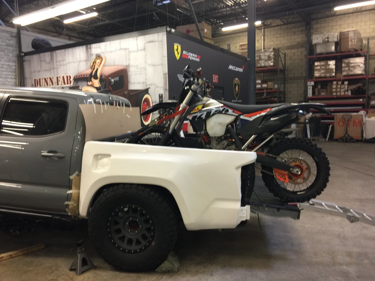

    17 LT pro

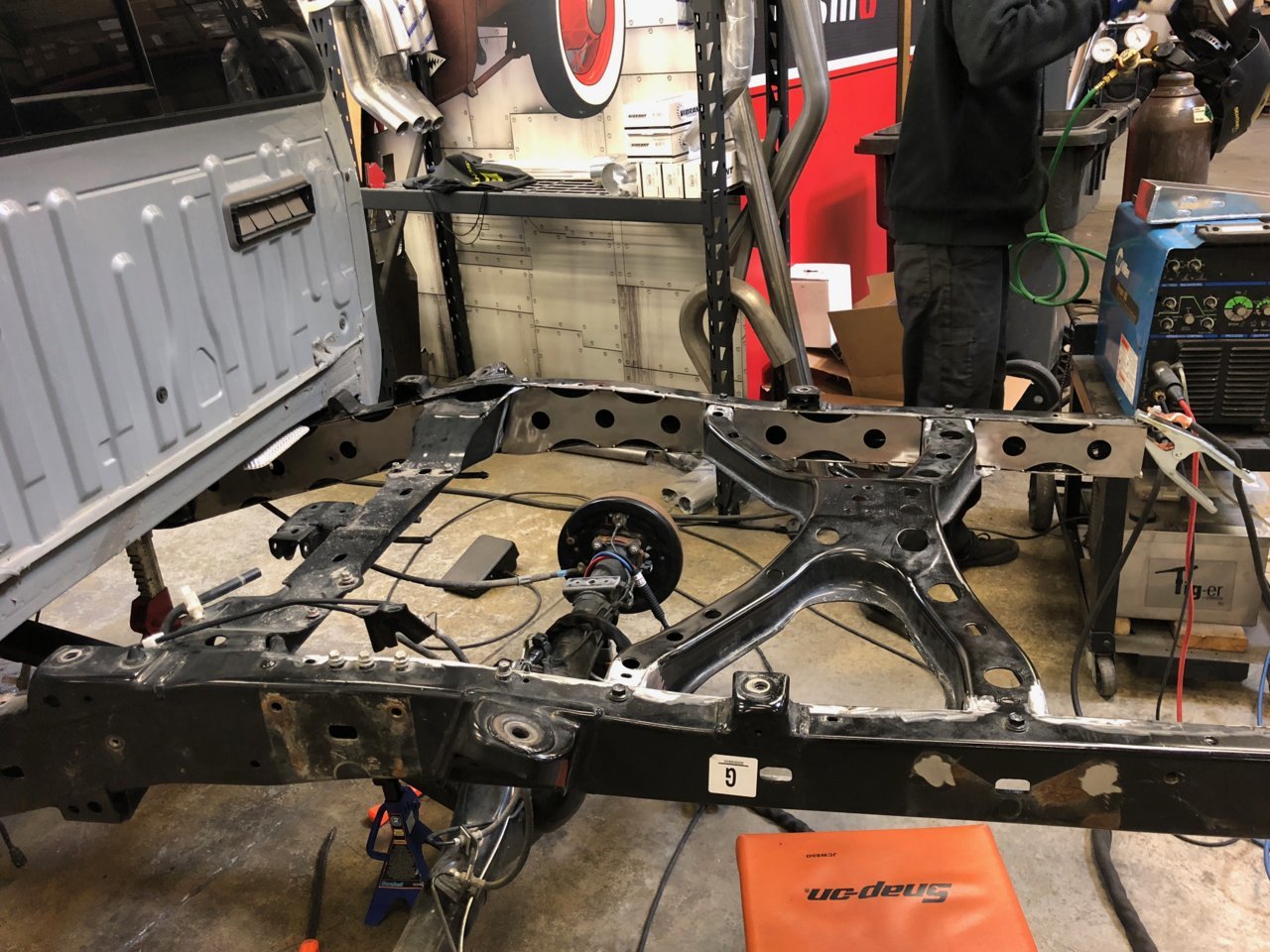

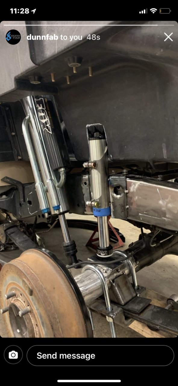

    Rear end is almost buttoned up. Need to notch the frame to fit the bypass on articulation. Waiting on parts from powdercoat. Bedcage and all looking good. Bike barley fits in there. We added 2 wheel chocks to hold the dirt bike tires straight while I send it over whoops n jumps. Frame is also boxed using dmz kit.

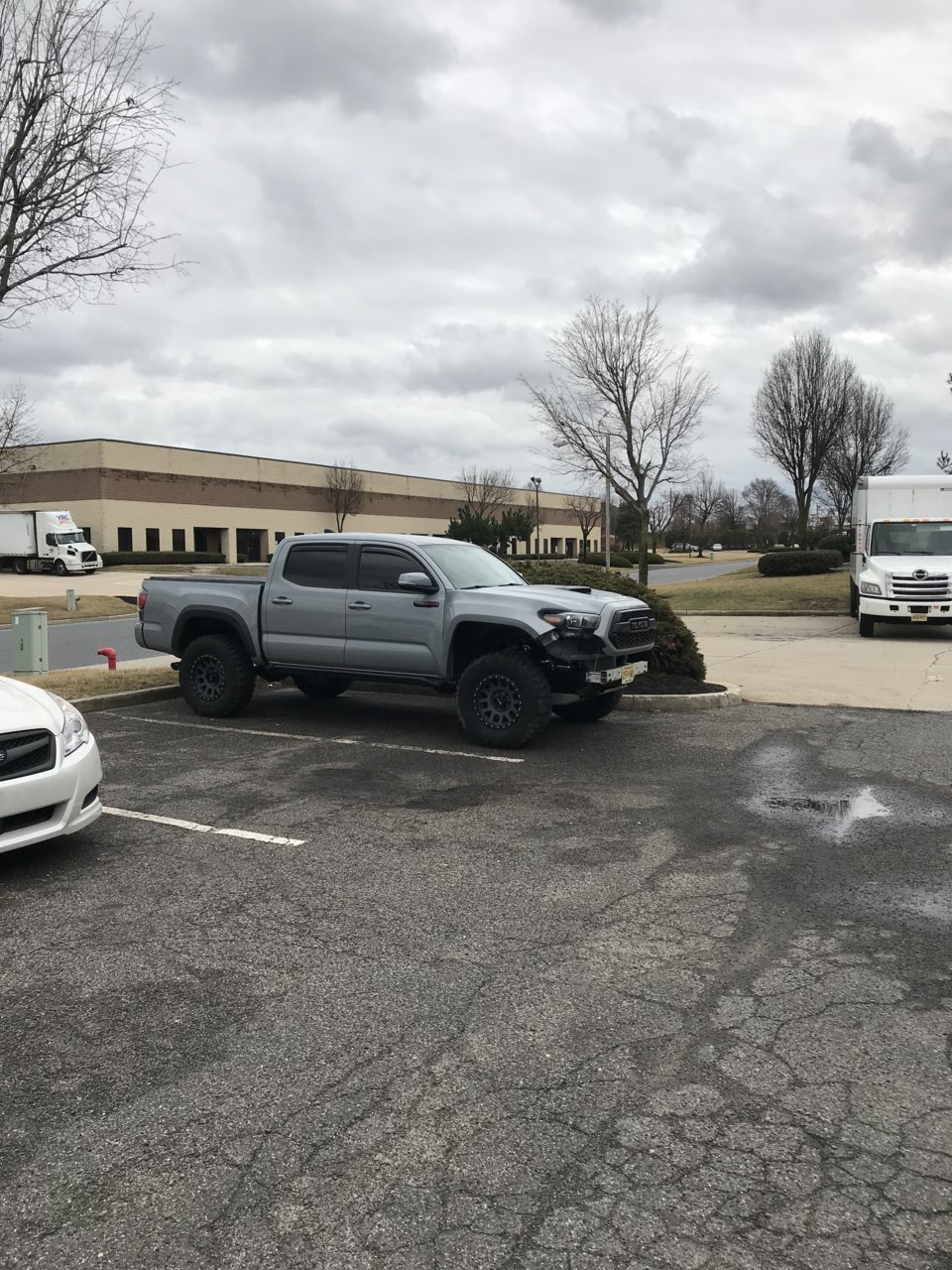

    Might have a truck done by June 1st. Got my fingers crossed. Here’s a pic of the bumper.
