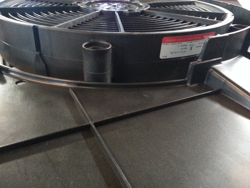

    Here is how it fits within the shroud.
    This fan is 2.6 inches thick so there should be plenty of room to fit it without hitting the engine. I plan on using abs to cover the gap around the outer perimeter of the fan and the shroud. Basically I'm going to fuse/glue the abs plastic sheet to the inside of the shroud and cut out a hole just for the area of the fan that moves air. This way it will look like a factory clean job.
    Anyhow here are the specs of the fan. Its the 3817 model.

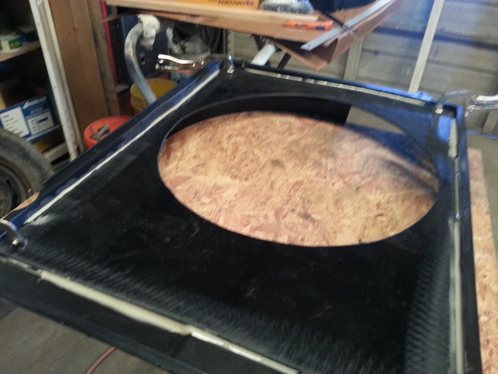

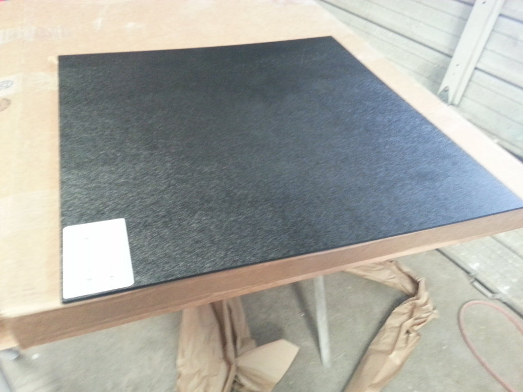

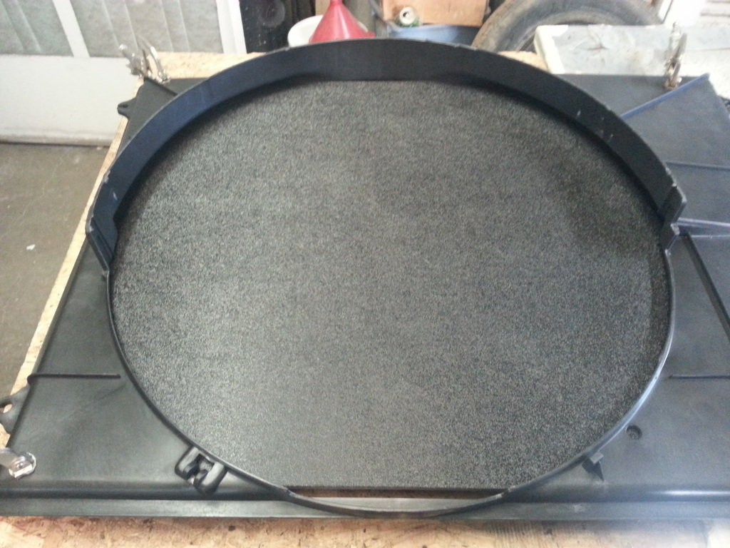

    ABS showed up today, unfortunately I have things I got to do today but I should have a little time tomorrow to cut this to size, cut out hole and hopefully fuse it to the inside of the shroud. BTW I got this ABS Sheet at amazon for $23 shipped.
    Here is the ABS fit inside the shroud with clamps holding it. There is a little gap at the top and at the bottom. I plan on sealing those up with my plastics glue to keep it sealed.

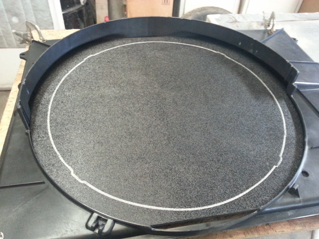

    Here I placed the fan on so I can trace the outer edge of the fan so I know where and how big to cut the hole out.

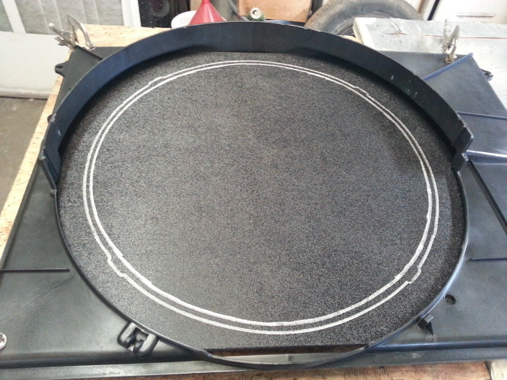

    Here is the outline that I will use to make a slightly smaller hole. Below is the second line that I will actually be cutting out.

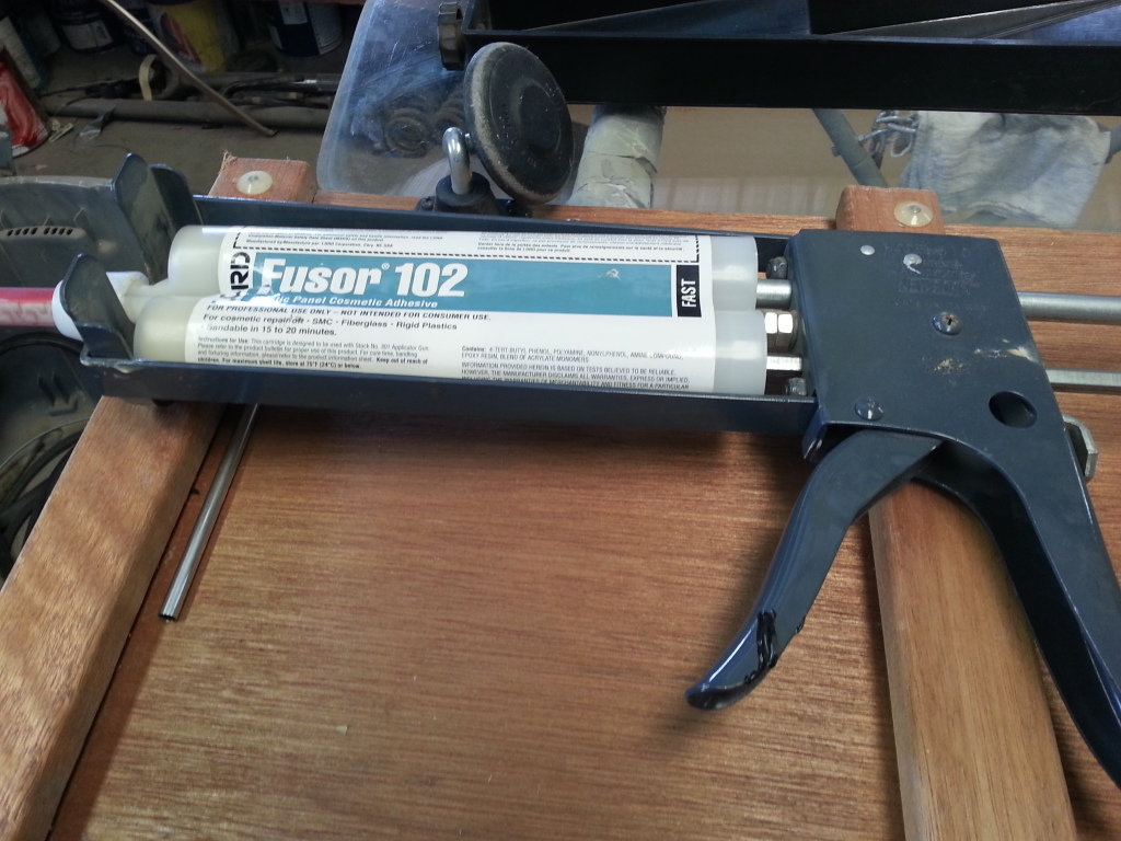

    This is the type of industrial plastic glue that I use. We use it at our shop regularly and I've found it to work very well.

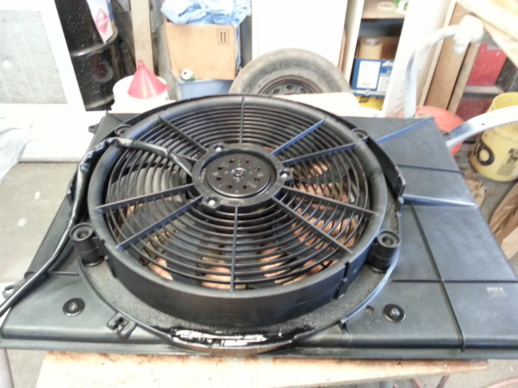

    Here is the panel with the hole cut out and glued to the shroud. I'm going to let it set overnight before I mount the fan to it.

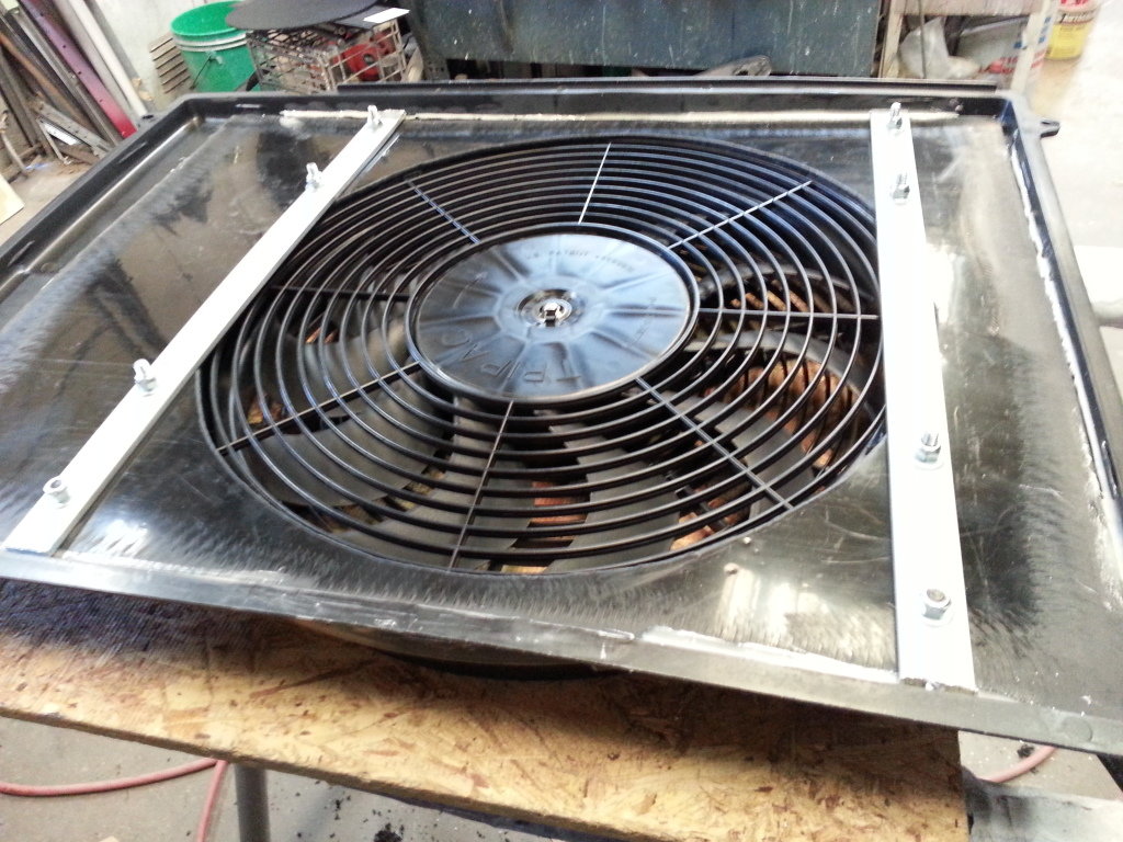

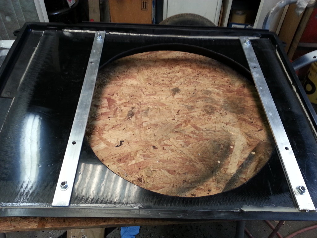

    After waiting overnight to let the shroud dry. I flipped it over to add a little load-bearing stability. A couple of 1" x 1/4" aluminum strips, cut to fit within the inside of the shroud to help with the weight of the fan.
    You can see the oversized washers and bolts that I used to secure the bottom of the aluminum strips to the bottom of the shroud. I painted them black so they would match and not look obvious.
    Inside look of how the fan mounts. Having mounted the fan this way allows the fan to use the entire shroud in the manner it was intended (pulling air from all across the radiator). BTW, none of the bolts excess threading will actually touch the radiator. I already checked the depth and they clear with plenty of room.

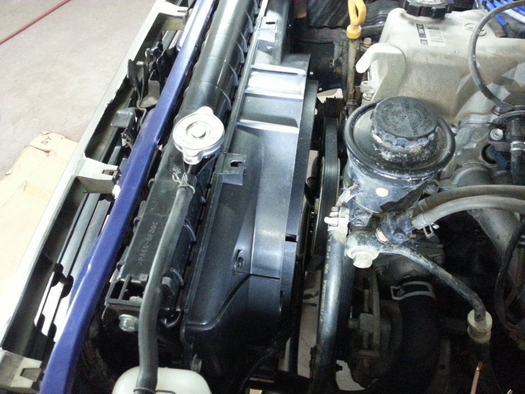

    Side and overhead view of shroud installed on radiator. Plenty of clearance. P.S. No need to install lower shroud lip as it is just redundant and would serve no actual purpose.

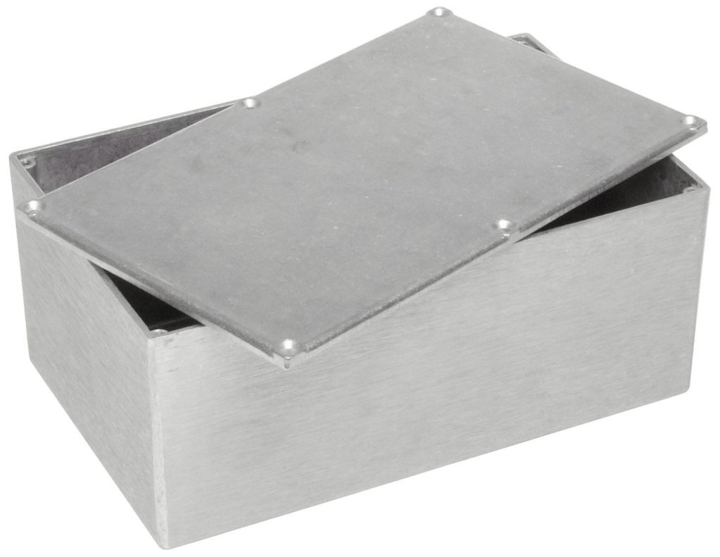

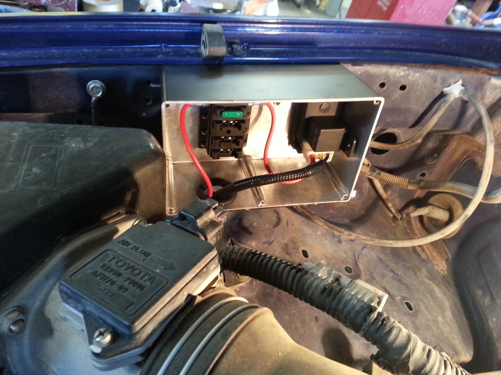

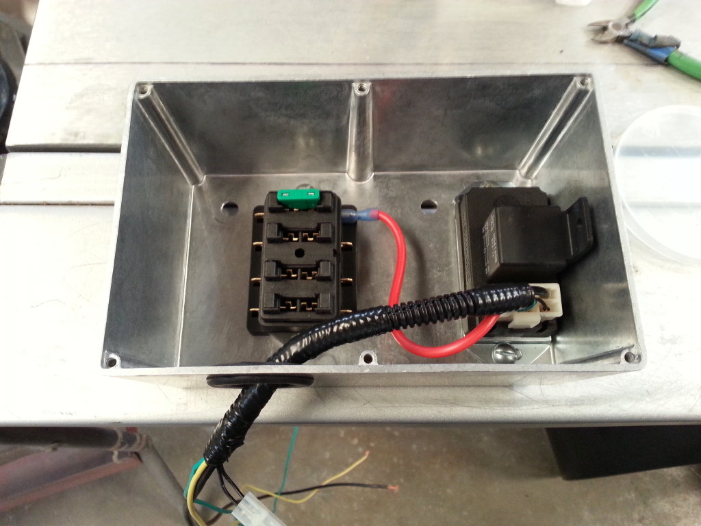

    I didn't like the inline fuse holder and I wanted to mount it all in a water resistant box so I got these:
    E Support Car Truck 4 Way Circuit Standard ATO Blade Fuse Box Block Holder 12V 24V
    and
    BUD Industries CU-347 Aluminum Econobox, 7-3/8" Length x 4-11/16" Width x 3-13/64" Height, Natural Finish
    Yes I measured it all out so I knew it was all going to fit. Here is the early fitting process.

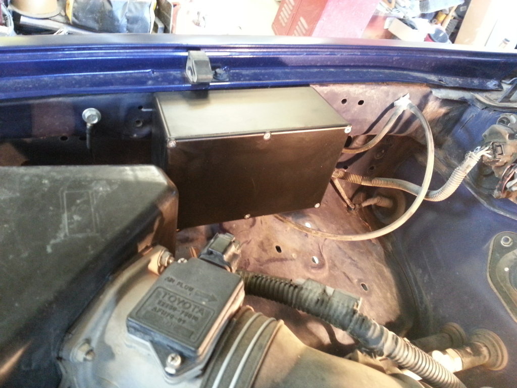

    Painted the box flat black to match with the rest of the under hood items and I mounted it where I had the most space. Not to mention where a couple of pre-existing nuts were already in place.

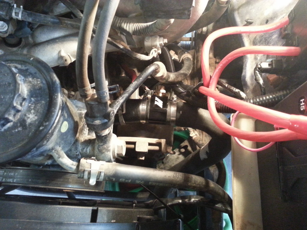

    Now this is where I mounted the sensor and sensor adapter. I did this fully intending to kill two birds with one stone. I didn't cut my hose I actually bought a section of hose to add to the length of my original radiator hose. I noticed that originally my hose practically hugged my alternator. Since I plan on adding a larger alternator I wanted more room so I inserted the adapter at the end of my original hose and added a 2 1/2" bit of hose to connect the adapter back to the thermostat housing. I also chose this area because this is where I want my probe reading temp at (after passing through the radiator and before going back into the engine).
    After testing the wired unit and passing on the first try, I closed up the "fan box".

    I also had to open the lid to the fuse box I used so air could circulate. That got hot and melted the fuse carrier. I upgraded that to maxifuse.
