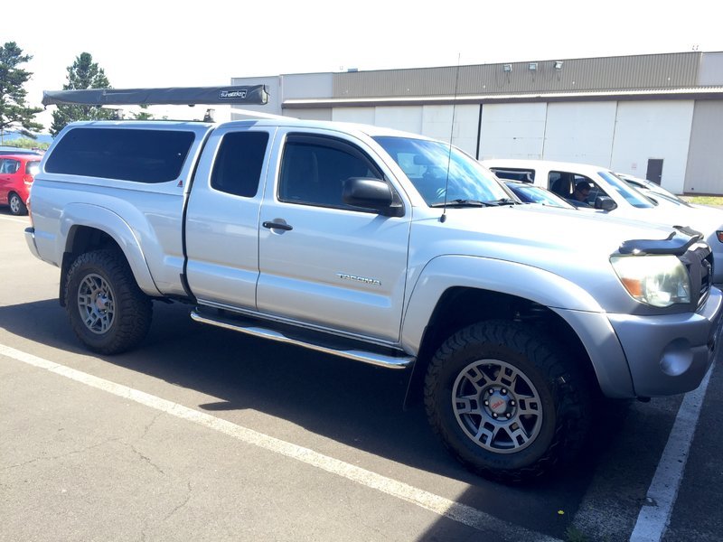

    Clife44, what size tires do you have?

    BFG KO2's at 275/70/17.

    Looks awesome! Thanks

    Thanks! Had to do a little trimming today but no problems. Great wheels and tires all around.

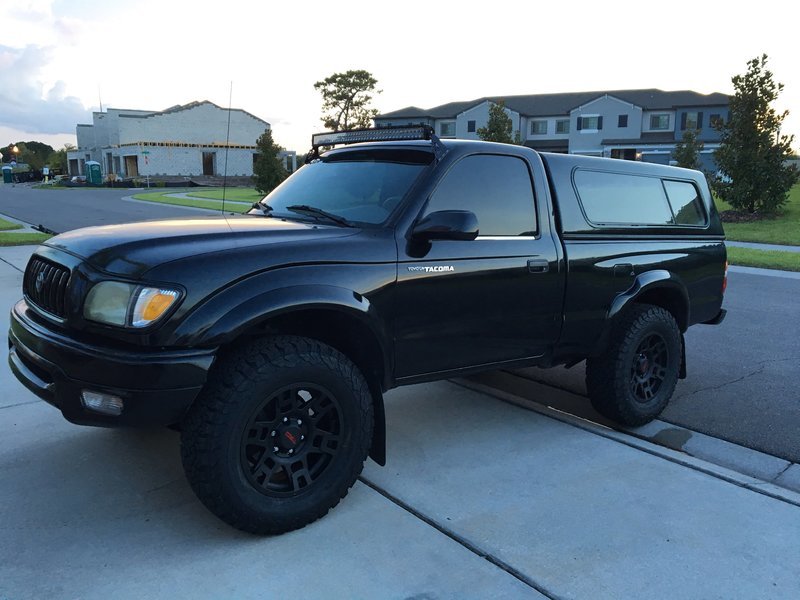

    BF Goodrich All-Terrain KO-2 265/70R17

    Was thinking about doing this exact thing. Why did you spring for 265/70 and not the the stock 265/65? Any rubbing with the slightly bigger tires?

    265/65 looks really small with these wheels for some reason. Also the 4runner that comes with these wheels use 265/70
    Its not even close to rubbing!

    Even at full lock? I know people with this size with BFG KO2 some rub at lock and that is what I was worried about. Other then that how do you like the tires?

    K02s even in same size is a bigger tire due to the tread. Again, not even close to rubbing at full lock. My caster is set at 2.7 on both wheels. Maybe if your caster is set closer to 0, you may have issues.
    I like the tires, don't love them. They tend to follow the road imperfections, and I feel the sidewalls could be a tad stiffer. Other than that, they are quiet and smooth riding. I am probably a lot more particular than most when it comes to tires, so what may bother me, may not bother most folks.
    Overall, it's a good setup. I like that the offset is wider than stock wheels, so they look a bit more aggressive and the handling is a little better duse to the wider track.

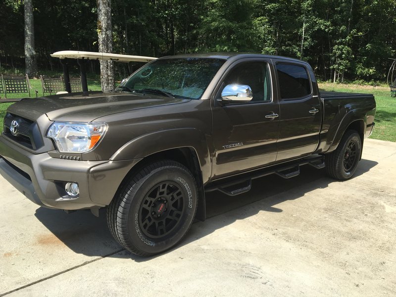

    What size at those? 65/17 or 70/17?

    265/70/17
    They rub at full lock. Lift coming real soon.

    Damn thats what I was worried about. Thank you for letting me know this though.

    It's a slight rub, only when backing up at full lock. I can remove the mud flaps and fix the problem, but will lift instead.
