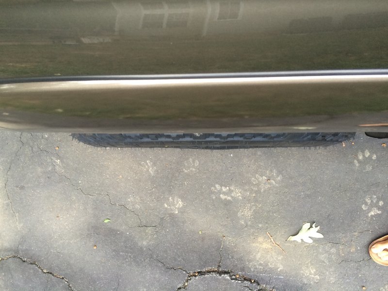

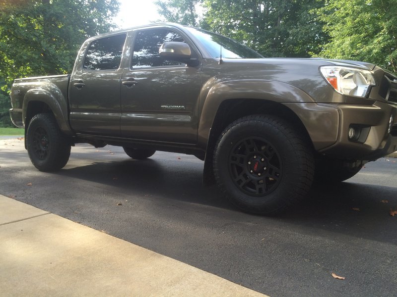

    Hey, I want to share some info for you guys (and gals) about these rims and my set up.

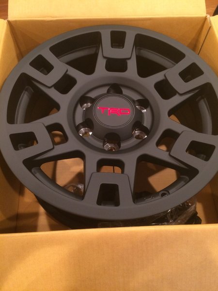

    So I bought these rims from a local Toyota Dealership about 20 miles away from my house. The closest Toyota dealership would not price match to the online Olathe Toyota price. I had to search around, but I eventually found a dealership that can get me 4 rims for $735 shipped.

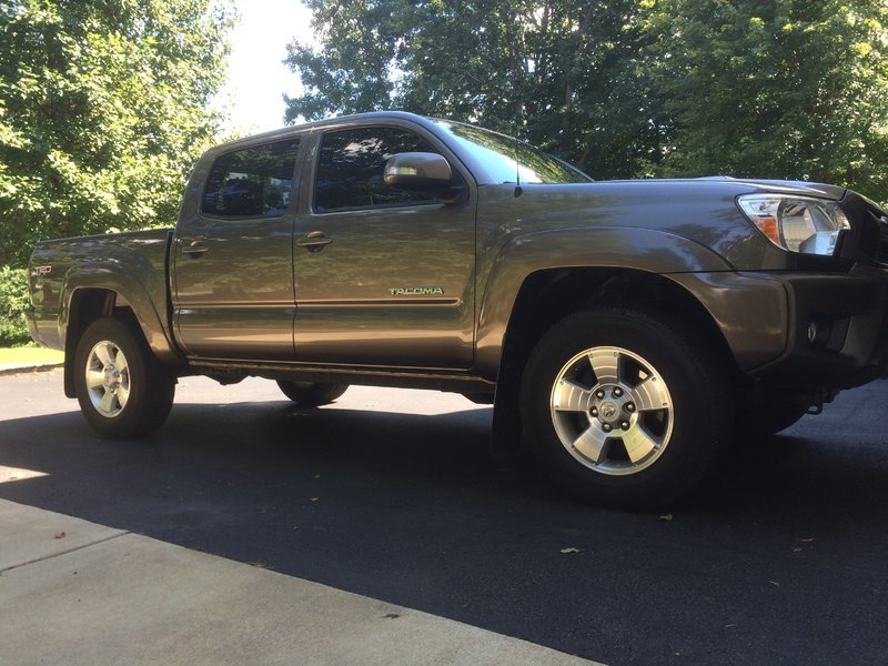

    This is what the truck looked like beforehand. 2012 Pyrite Mica TRD Sport DCSB. Completely stock, except for upgrade audio. Nothing was done to suspension nor a lift was added.
    Got the rims, got the tires (Nitto Terra Grapplers G2 265/70R17) and headed to my buddy's shop. He mounted the rims and tires in under an hour. The stock lug nuts and stock TPMS with valve stem work perfectly from an OEM ALLOY Rim. *Note: bought the 4 tires for $680 shipped... I knew a guy from Progressive Insurance that got me the tires super cheap*

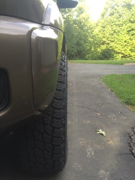

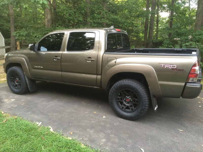

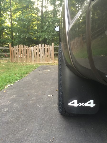

    And finally, the after. It looks completely different. Again, stock suspension and no lift. the 265/70R17 tires work perfectly. You do have to take off the little front mudflap in front of the front tires. There is a minor (and when I say minor, I mean minor) rub on the front mudflaps, only when turning in reverse. (Ie: backing out of a driveway onto the street). I am not worried about this rubbing since it is so minor.
    As you can see, these rims work perfectly. They will not rub against anything major with 265/70R17. The rims' offset also pushes the tires out about 3/4in to 1in than stock, as you can see. I think these completely transform the truck into a beast.
    Again, if you have any questions, feel free to ask! Also, tell me what you think!!!

    Very interesting read for starters it looks great. You should at least do the leveling kit if not save up for a full set up if you wanted to go that route. Luckily for you your tpms worked, I had the steel rims and my tpms did not work. Mine also do rub slightly with the front mud flaps, I removed them just in case. I'm on falken tires and my tires stick just slightly more than your Nitto.

    Those look really good Tacoma guy, thanks for the detailed pictures. I'm still not sure I want to go up a size though, why did you go with the 70's over 65's, is it just for looks?

    Man you are right that looks awesome!! Thank you for the detailed pics and explanation. I am ordering these rims Friday!!
