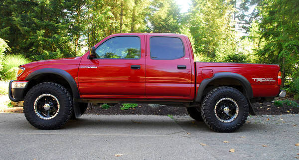

    It will if the rim is big enough. like if u put a 18in rim on a stock tacoma with mud tires its gonna rub. unless u get a tire with a smaller sidewall. Theres one member on here w a stock red tacoma 1st gen who was able to put new rims and tires I think around this size toyo mts 285/75R16 and she said they only rubbed if she turned real sharp.

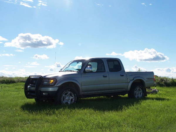

    The truck i'm talking about looks like this
    It was recently purchased by my father 2 provinces over, and is being shipped to me next week. This is the reason I cannot tell whether there is any lift installed. I am assuming no, and it is stock.
    I want NO rubbing. My buddy has a 05 tacoma with a 6" lift and his dick cepek mud countrys still rub on sharp turns, I don't want to deal with that.
    It currently has 265/75/r16, which I understand is the stock setting.
    Also, this truck probably won't see any offroading so mud tires are not a factor. I'm looking for best MPG, it will be a mainly highway vehicle.

    nice truck. yea tht def looks like stock. If you want some decent tires look at firestone ats. Sound good on highway and if u ever have to go offroad they will def help. Doesnt really affect gas mileage either

    SO 265/65/17 and i'll have full turning radius, rubbing. Thank you very much sir.

    not sure but yea those look like the stock rims

    Yeah those are the stock rims, I have those on my truck too :p. I'm not sure on the the offset/backspacing specs though...
