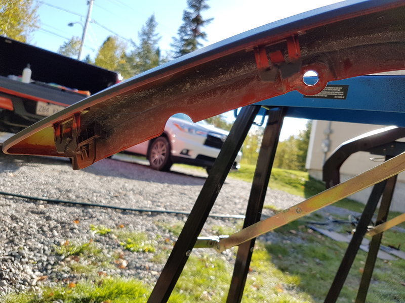

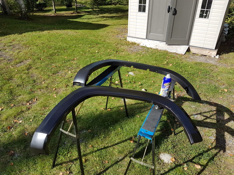

    One of the guys here removed his fender flares to Plasti-Dip them and he said it was a PITA.
    If I recall correctly he said he even broke one or two clips in the process. That's probably why most folks just mask around them.
    Anyway, I couldn't find the thread but I do have some of his pics, and you can clearly see how they are mounted.

    Dont be surprised if you do try to pull them and find some tape there. I've asked around about replacing mine and some trucks have tape and some dont. I dont really think Toyota is doing enough QA on these trucks. I had a big glob of sealant on the inside of my engine bay. I assume someone put it there to use it somewhere else and forgot it since it served no purpose where it was at.

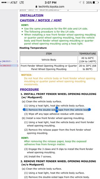

    They absolutely DO USE DOUBLE SIDED TAPE.
    That's why Toyota says they are non-reusable parts.
    But thanks for playing.

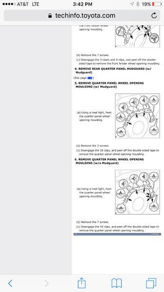

    It absolutely is. Would you like to see the whole procedure?
    And in those pictures you posted, what do you think the shit is above the clips, it's residual double sided tape.
    I appreciate your enthusiasm, but let's own our truck for more than 3 days and 60 miles before we start spreading misinformation. Thanks

    I was making my comment from reading the OPs comment. It sounded like he said its held on with doublesided tape. No mention of all the clips.
    And yes I would like to see the whole procedure. From the looks of it the doublesided tape along the edge looks like it's used to make a watertight seal. I'd guess all the clips hold it in place.

    I dipped mine, but when spring time comes around I might have'm painted matte black. Six months or so of seeing them dipped black I'll know for sure whether I want to make it permanent or just keep them dipped.

    That looks above my skill level. I'd probably break too many of the clips. Claws on the other hand seem pretty durable. I didn't even remember reading in the other guys post about the 7 screws.
    Well if I get them painted, I'll let a professional shop do the job.
    I'll see if they can use a gasket along the edge. I prefer that black edge against the truck body. Had them on my Tundra and really liked it better that way.
