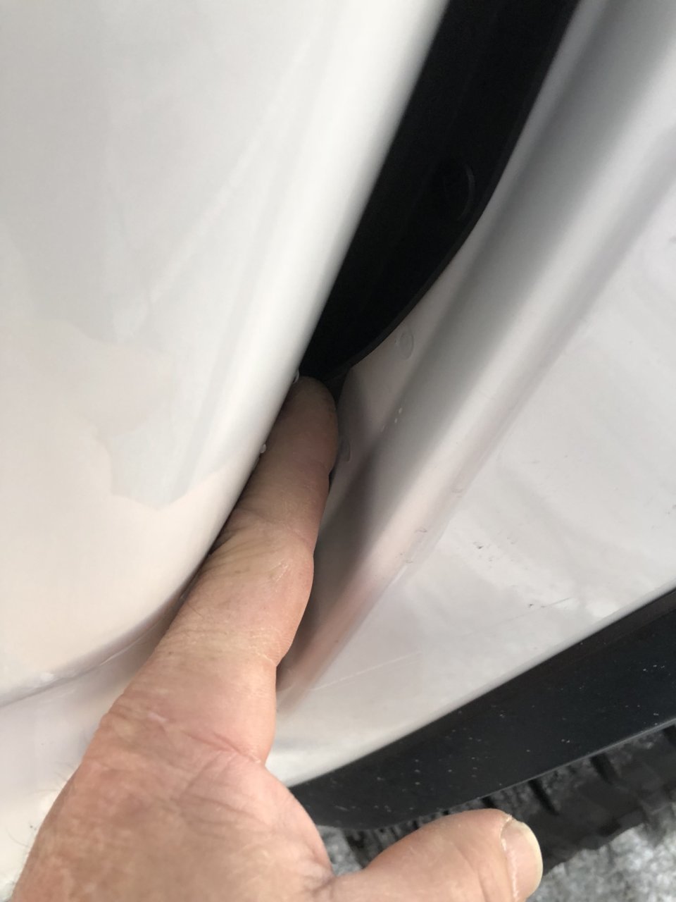

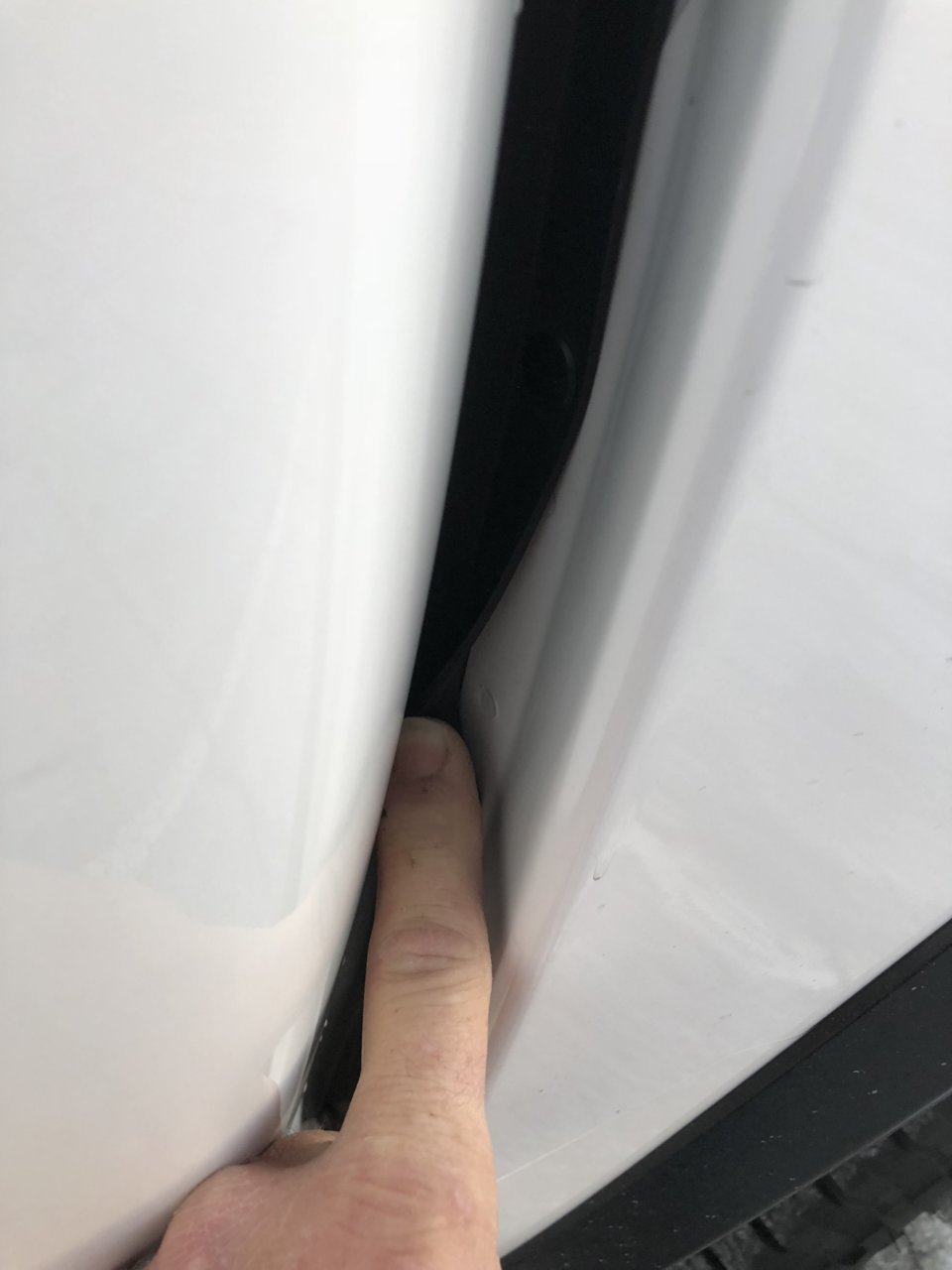

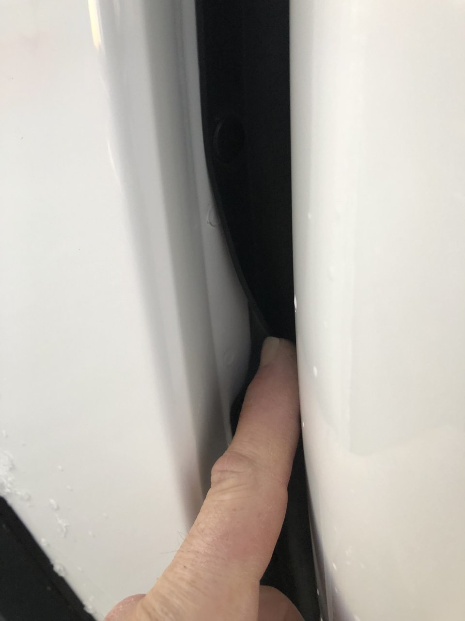

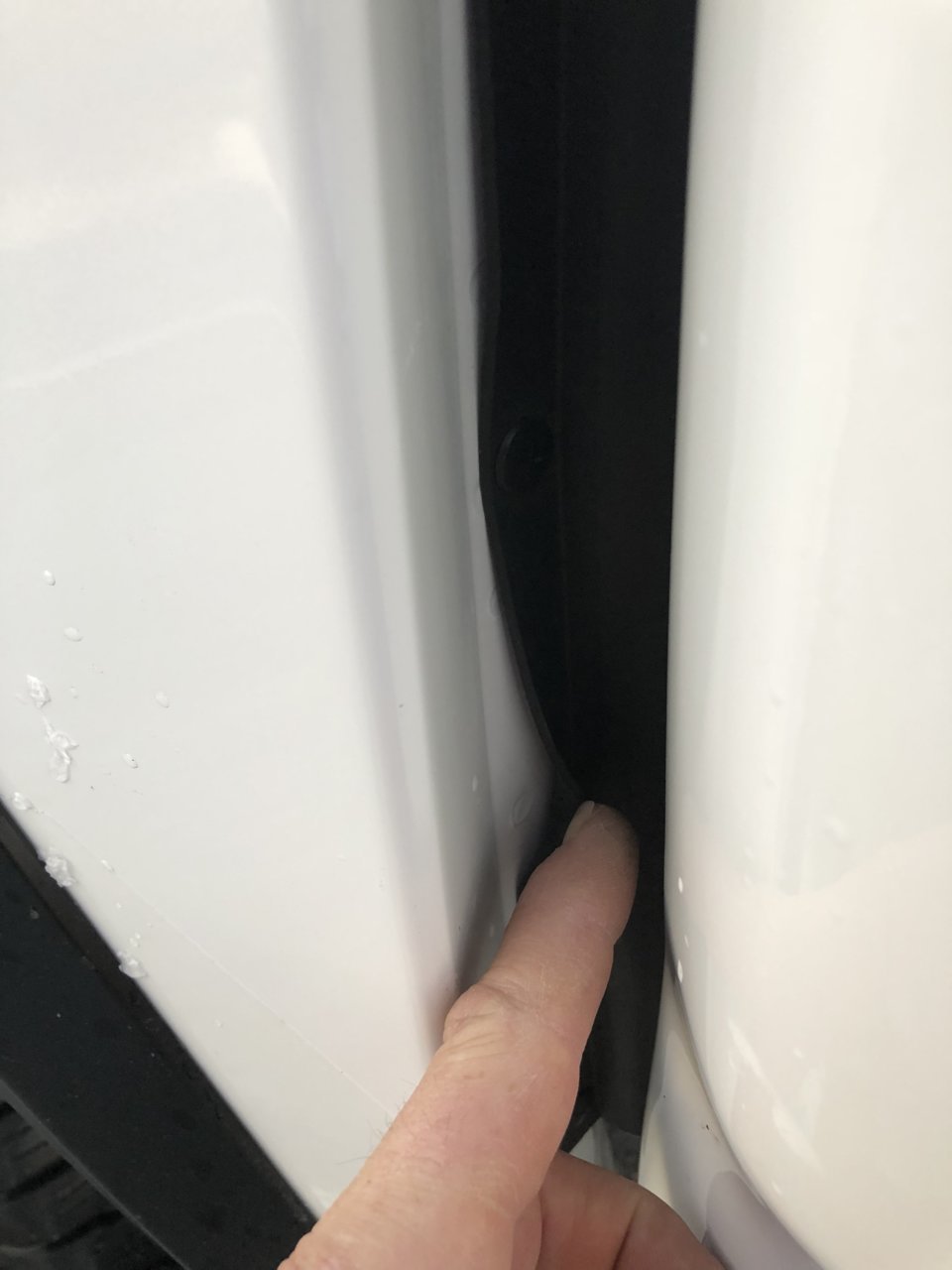

  18. Jan 14, 2019 at 8:01 PM
    #38
    Ronzio
    Ronzio Well-Known Member
    Feb 20, 2018
    #245114
    2,719
    Pennsylvania
    17 DCSB TRDOR
    I got my truck back from the dealership today...the rust on the pinch welds was repaired under warranty. They had the truck for a week and did an excellent job looks better than new! Total cost to Toyota warranty was $1718.20 MUCH THANKS TO THE O.P. for bringing this issue to my attention had I not read your post I probably wouldn’t have ever noticed this area of the body.
