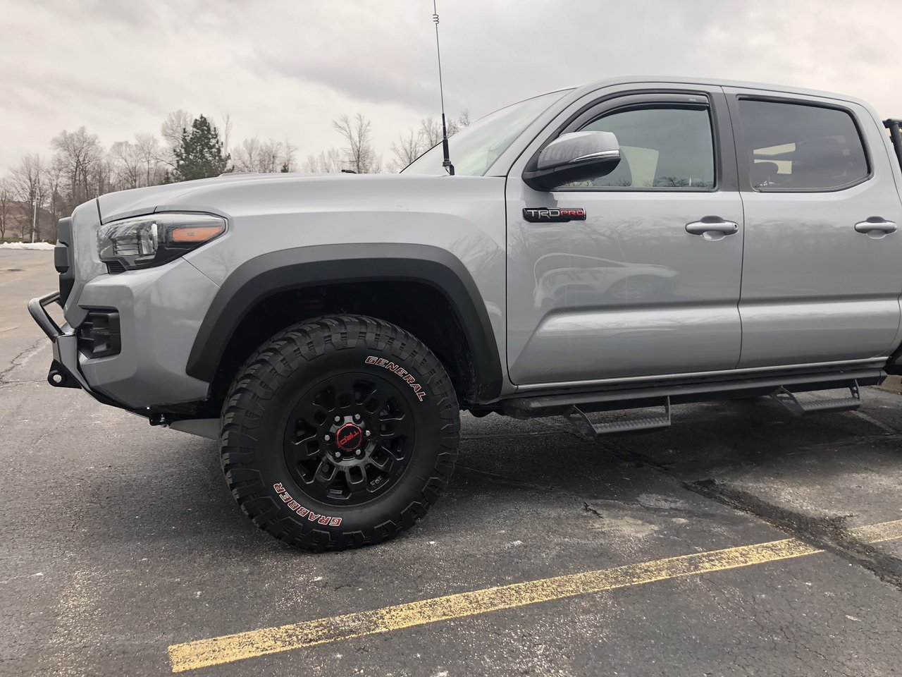

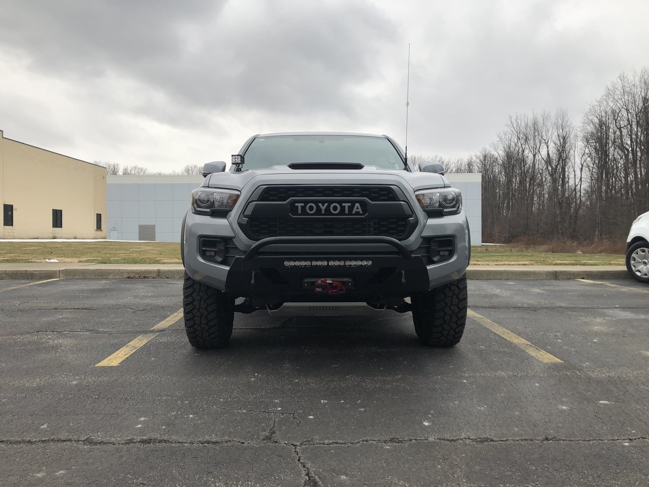

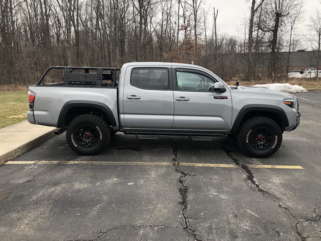

    A snapped a few pics today as it stands . . .

    Really looks good to me. Assuming you'll have additional weight in the back, it might be ok as is? You don't wanna load up the back and be sitting nose high. I'd prefer to even have a little rake left when loaded so you're not hitting the bump stops on bumps. But maybe that's not an issue for you.
