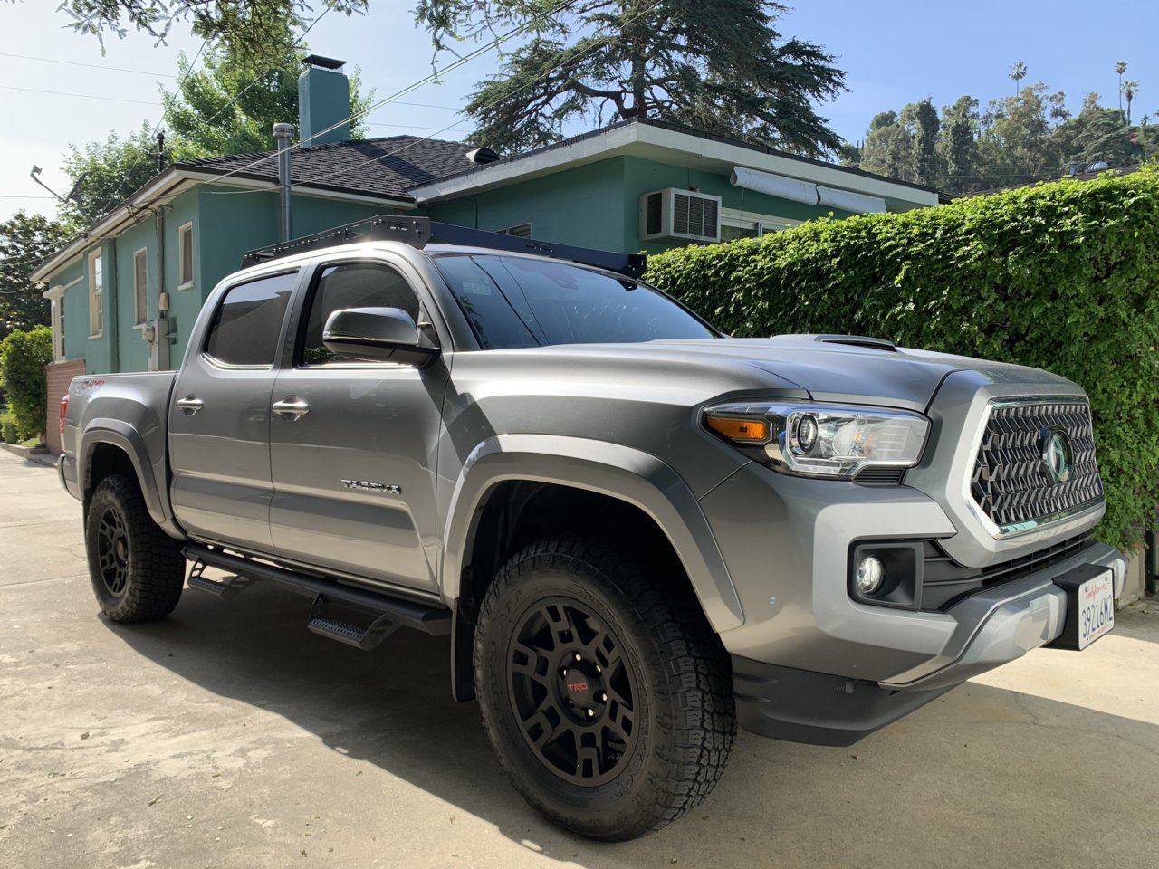

    2018 TRD DCLB Sport 4x4 Silver Sky
    Bilsteins 5100s on the top setting, 4runner Gray TRD Pro Sema wheels, 285/70/17 Toyo AT3s, Sumo Bump stops, TRD exhaust, ECGS Clamshell bushing, 1/4 shim for the lean and one inch rear block, OEM Pro grill and garnish OEM TRD Skid plate, TRD CAI, Demon Brackets, Rigid Industries Pro fog lights, OEM Trail Rails sidebars, Diode Dynamics LED SL1 high and low beam lights, OEM Roof racks, Clazzio leather heated seats, Remote Start, TRD Pro shift knob, tinted windows, Rockford Fosgate 4 channel amp for the headunit and sub and amp combo, OEM Puddle lights, OEM tailgate lock, OEM bed mat, LED interior lights, OEM blackout kit for letters, JLT catch can, upgraded 27F toyota True Start battery, Vleds led tail light kit with Pro tail lights, OEM Rave4 side mirrors with convex spotters,just to name a few mods.
    I would say yes you will be fine. I personally would go with a 265/70/17 as I use this wheel and a Toyo Open country AT2 SL rated to keep the weight the same and this size made my calibration dead accurate with a GPS. Lots say the more offset with these wheels helps. why not add some Bilstein 5100s to the front and raise it an inch. You will love the ride and benefits you greatly for not a lot of money. I did the 4th setting and a one inch rear block, rides amazing and looks way better. If your keeping the stock suspension try a 265/70/as I'm sure the shop will test fit. I say it will fit with no lift.
