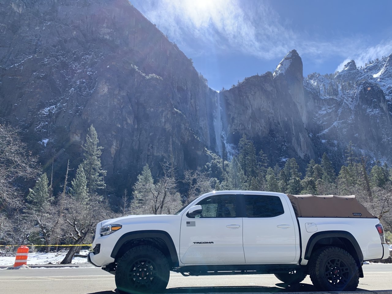

    TrdPro grille, blackout badges. Pretty much stock.
    I sometimes rub on the front mud flaps.

    Another question for you… What sliders are you running in that pic?

    Unfortunately they’re not rock sliders. More like reinforced steps. Lol.
    They are made by Tyger. You can find them on Amazon, or get them on the used market for sub $150
    I plan on getting some real sliders in the near future

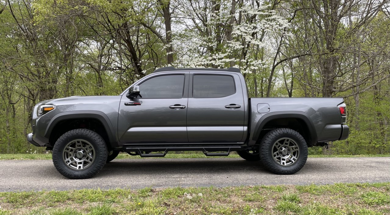

    A 265/65R17 will be the same size as the factory tire (30.5”) that came on the truck.
    You can fit a 265/70R17 (roughly 31.5” depending on the brand of tire) if you don’t mind mild rubbing on factory mudflaps while turning with mild suspension compression. You may not experiencing any rubbing with general highway use without mudflaps, but with any real off-road use, you will likely rub.
    Any bigger than that, and you will experience rubbing on a Pro. Going with anything bigger will also adversely affect your fuel mileage and power as well.
    Here’s mine with 265/65R17 Nitto Ridge Grapplers:

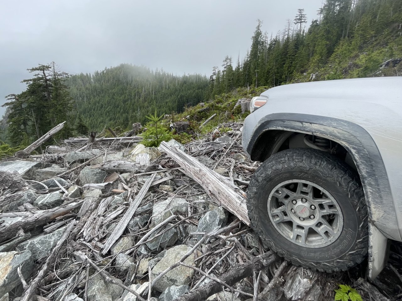

    So many trips now on this combo. Not a hiccup.

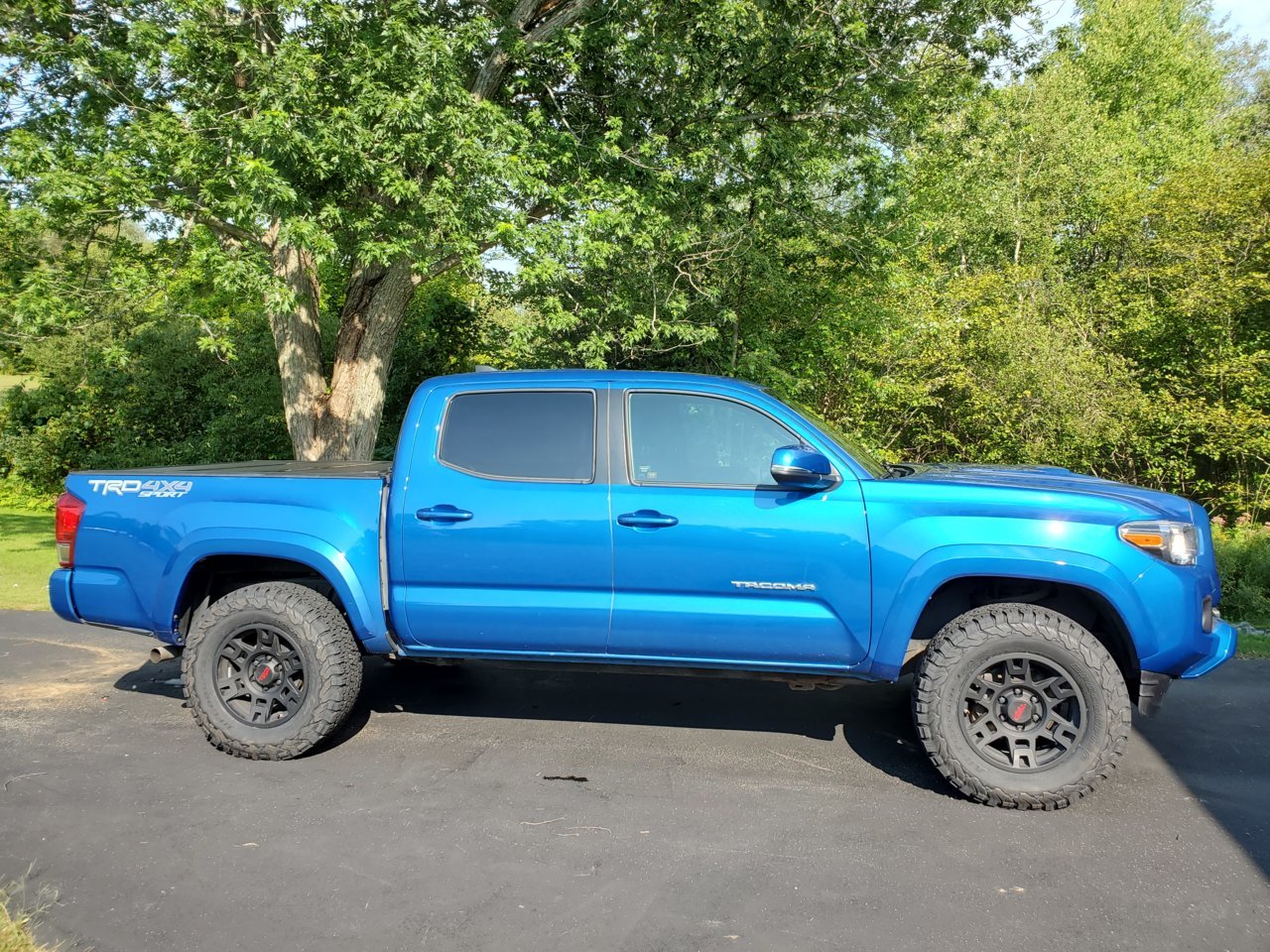

    Just got a set of KO2 tires in 265/70R17 and am super happy with them. 20210828_161845.jpg

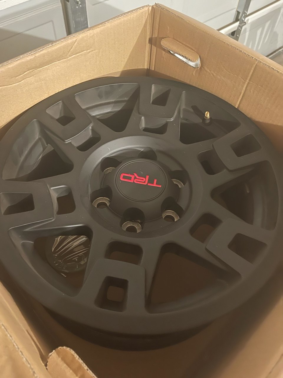

    Just bought x4 of these + x24 black lug nuts for $800. Shipping included via bam autoparts
    So stoked
