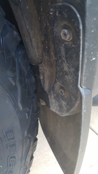

    I can confirm this is truth.

    Figured if I had them then that would give some veracity to my statement rather than having to trust another person stating "Trust me. It'll work fine."

    Hahaha that is exactly what I was thinking! "Well I have heard a handful of people say that is works.....so it has got to....right?" The pics definitely will allow me to buy a tire without any worries that I will be in for a sad time later!

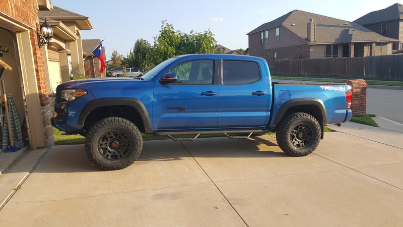

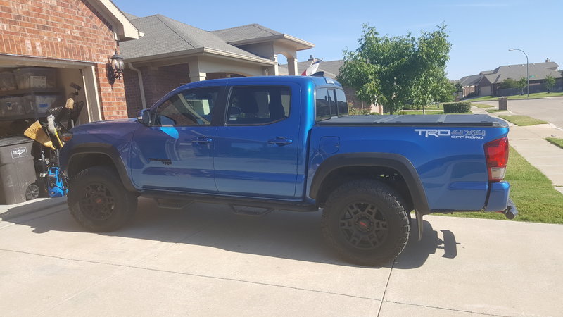

    Put new shoes on yesterday. 275/70/17. Even with a 3" lift, still had to remove front mud flaps to stop the rubbing.

    It looks good Mark. Did you get the transmission TSB and how is it driving/performing?

    What lift do you have? How high? And those are ko2's 275/70R17? :/

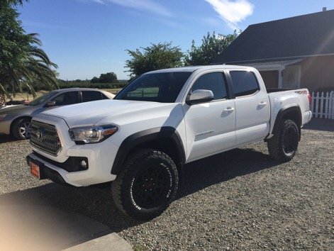

    pics like this makes me sorta kinda wish I did white letters out.

    What size KO2's? Is your truck stock height or what lift are you running? I just bought the same rims and some said I could run 275/70R17 with stock height and have no problem....now some are saying I'll have a problem....? :/

    Look sick! What size KO2? Stock height too right?

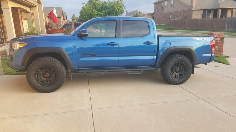

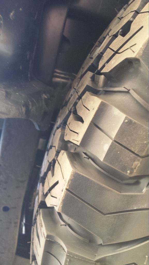

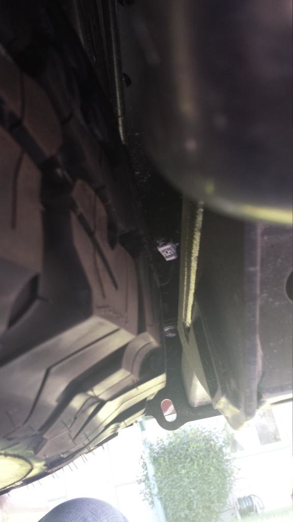

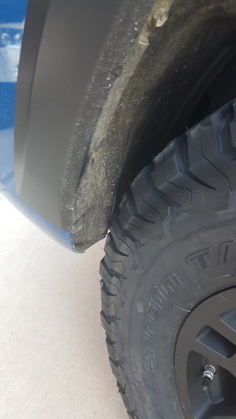

    Yes, these are the BFG KO2s 275/70/17

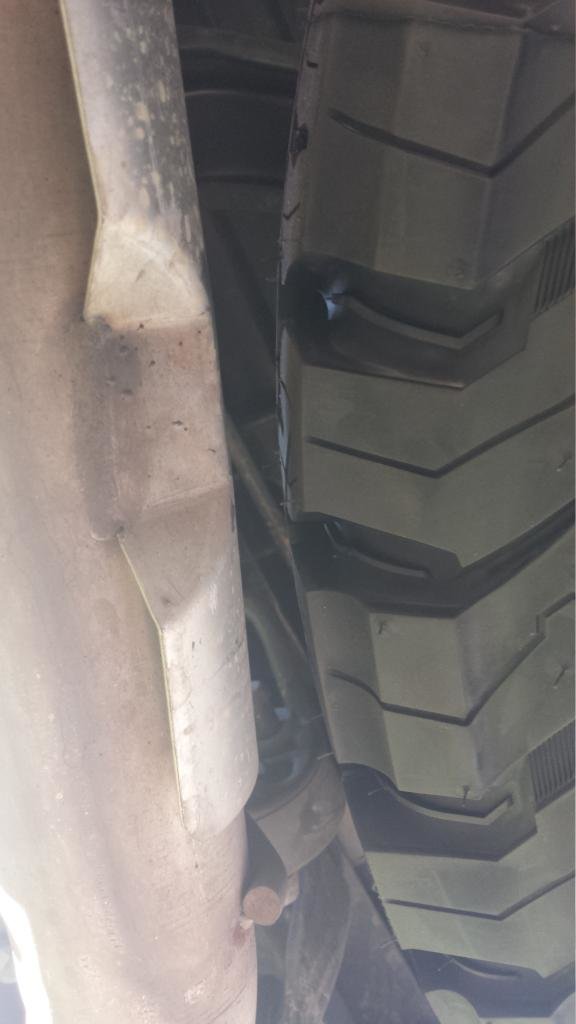

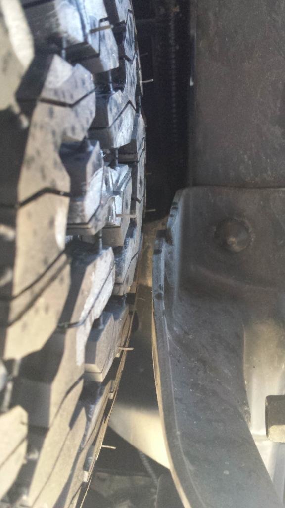

    Lift: Bilstein 5100s all around, OME 887 springs, Wheelers 2" AAL. Started out on the 2nd notch on the front shocks which gave a 4" lift. It rubbed and I had noise from the CV joints. Lowered front to first notch to fix CVs and removed mud flaps. This lowered the front to 3". Still has minor rubbing. Why did I put on the wheels before the lift?....because I read posts stating they would not rub. I had the wheels/tires installed at COSTCO. When they drove the truck out of the shop, the tech came in to let me know the rub was pretty bad and to take it straight home (he knew I was lifting it in the morning). He wasn't kidding. It was rubbing with the wheels turned only half way. By the time I got home (7 miles), there was a hole rubbed in one of the mud flaps. So I have no idea how others can claim they had no rubbing without a lift. Believe what you want...TW is full of contradictory information. This was my experience. Here are pics of the truck with the wheels, before the lift and the rubbing:
    Before lift, just got home from having wheels installed:
    Rubbing:
    After the lift (4"). I still have very minor rubbing under specific conditions:
    This is after lowering to 3". I still have very minor rubbing under specific conditions.

    I have heard some people say that they get slight rubbing with 265/70/17 on the stock mud flaps, so I feel like there is no way 275 will work. I have these wheels, and 265 KO2s, but haven't had them installed yet. I bought RokBlokz mud flaps to help reduce the risk of rubbing.
