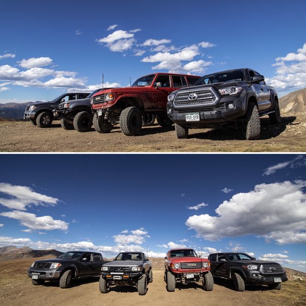

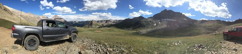

    Archive Garage Shackle Flip, Bilstein 6112s Front, Fox 2.0 Extended rear shocks, AAL, SPC Racing UCAs.
    With just the 265/70-17 K02s (run at 28psi offroad) and rock sliders this summer I did with my buddies:
    Sante Fe Peak
    Chihuahua Gulch
    Saints John
    Deer Creek
    Red Cone
    Radical Hill
    Governor Basin
    Mineral Creek
    Engineer Pass
    Hurricane Basin
    California Pass
    Hurricane Pass
    Corkscrew Pass
    Black Bear Pass
    Imogene Pass
    Yankee Boy Basin
    Red Mountain

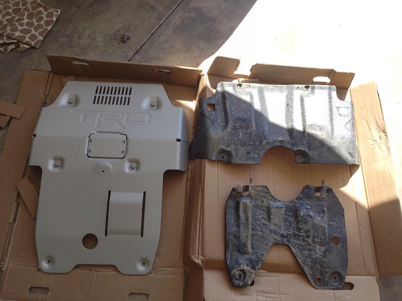

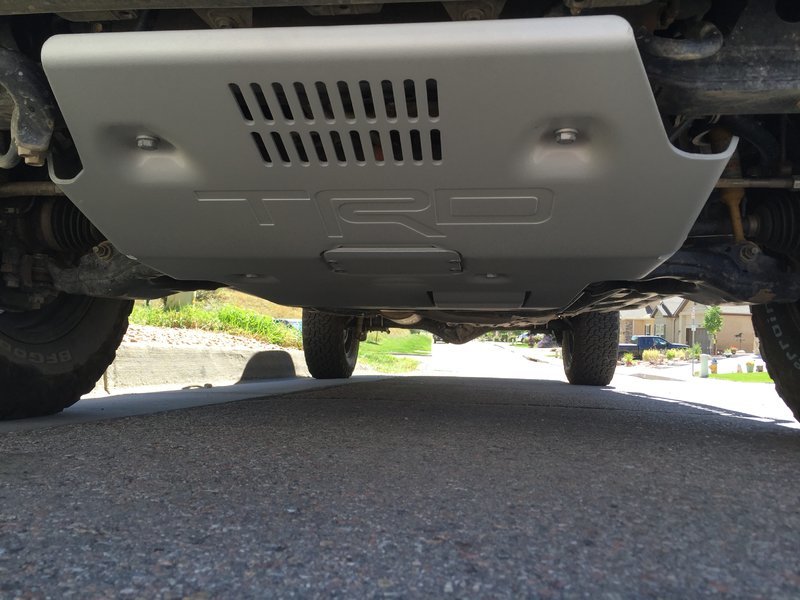

    I was blown away how capable the truck was stock. Rear locker came in real handy. Only trail that I felt that I wish I had better clearance and articulation was Radical Hill. You should have no problem doing whatever light off-roading you and your wife plan on doing! These tires took a beating and will do awesome for everything you're looking to do. I replaced the OEM skid plates after all the trails this summer with the new beefy TRD Pro skids (1/4" Aluminum).image.jpg image.jpg image.jpg image.jpgimage.jpgimage.jpg

    How many bolts did you have left over after replacing the skid plate??

    The stock OEM skid plate uses 6 12mm bolts. The TRD Pro skid plate connects to the frame using 4 17mm and 2 12mm bolts. So you're left with 4 extra after reusing 2 12mm.

    Basically same as original TRD Pro reveal. Covers all the same parts the OEM does but in one big chunk of aluminum. Definitely covers oil pan and front diff.image.jpgimage.jpg
