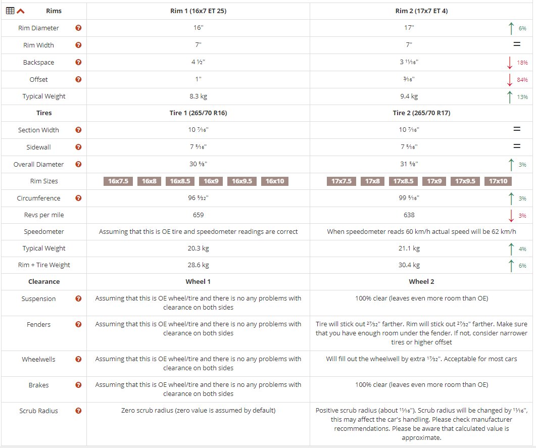

    Here is the difference between going from a stock OR rim with 265/70R16 tires to the 4Runner TRD Pro wheel with 265/70R17 tires. The 4Runner TRD Pro wheel is 17x7 with an offset of 4mm.
    CavalryTRD and ejewels like this.
  10. Mar 15, 2018 at 8:02 AM
    #1350
    Stocklocker
    Stocklocker Well-Known Member
    May 15, 2017
    #219125
    12,741
    17TRDORDCSBAT
    So there is a 21mm difference in offset between the two. Thanks......that’s interesting.
