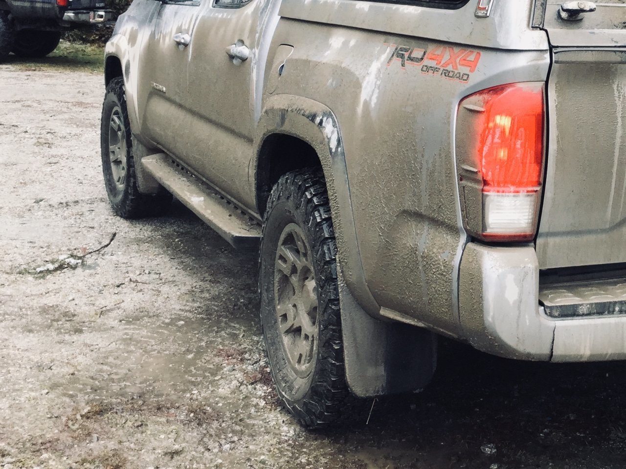

    The stock hard plastic Toyota mudguards need to be removed for more serious off roading. Not because they contact the tires with this set up, but because they contact the ground when the suspension stuffs and flexes. If you stuff a rear or front wheel, the hard mudguard is on the ground and gets smashed or torn off.
    I run mudguards around town and on logging roads to keep chip damage to a minimum, but remove them if running over the really rough stuff (takes 2 minutes at most). I broke a couple before I figured this out, but they are inexpensive to replace from Toyota. You can also run aftermarket guards that are more flexible, but risk getting them sucked into the tire tread, and torn off, in reverse.

    Come to think of it, the only clean thing here is the back of the mud guards......maybe they are doing nothing for me? :mudding::confused::mudding:

    I think for winter it helps. Summer around here not so much unless you’re just trying to keep mud and dirt off.
