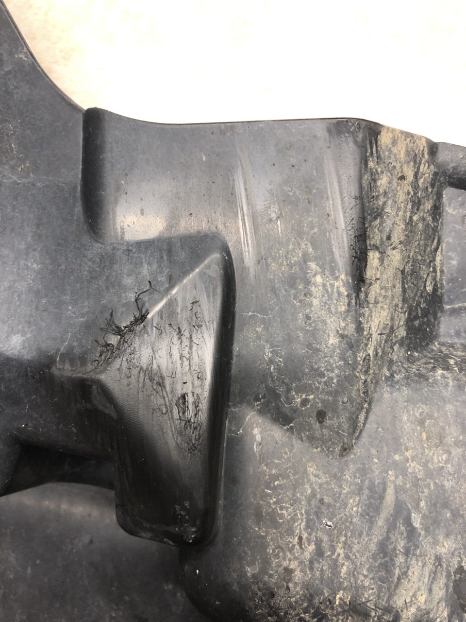

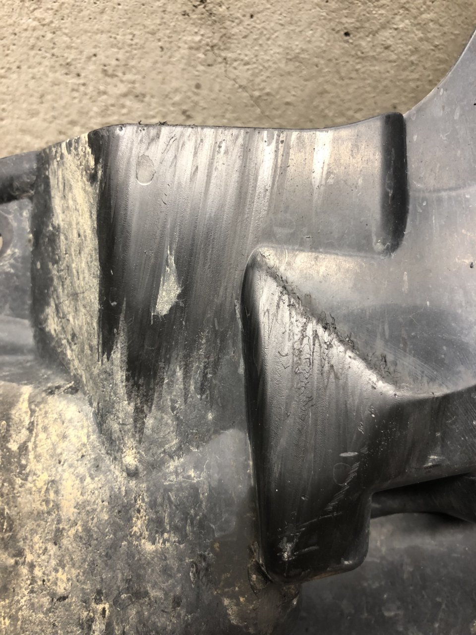

    Like @Spare Parts I moved up to a 70 series, but for me rubbed on both sides. Took better pics for you if you try trimming. RekGen was another idea but after yanking the front flaps I was happy.
    Right:
    Left:

    Thanks. I will probably just be proactive and pull my OEM mudflaps prior to installation. I might get thinner mudflaps down the road or hold off reinstalling the OEM until I decide to lift the truck.

    Ahhh cool. Thanks a lot. Great job on working these out. I am leaning towards proactively removing the guards when I get new wheels and maybe getting Rekgen or something like that until I lift the truck and then check for clearance issues. This definitely gives me a template to work with though if I decide to keep the OEM.

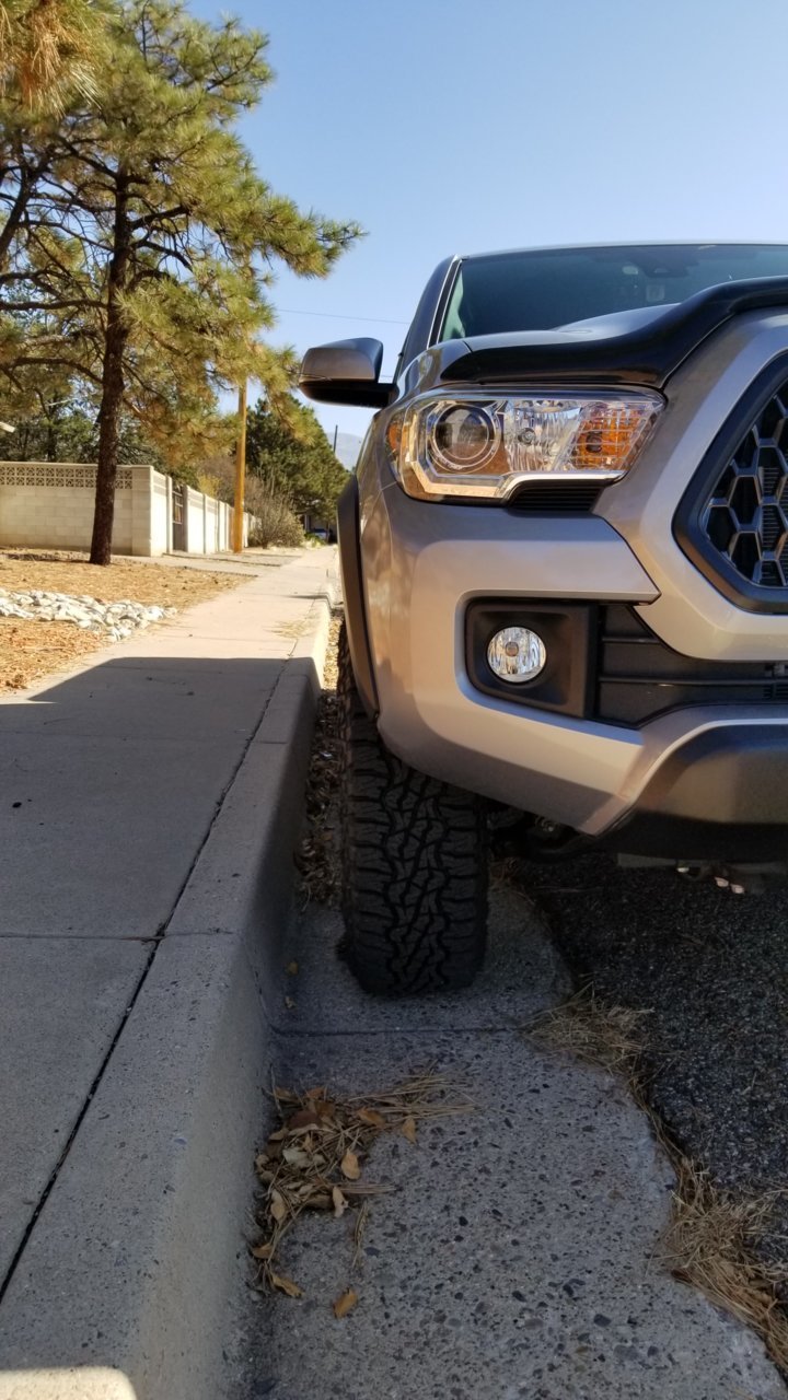

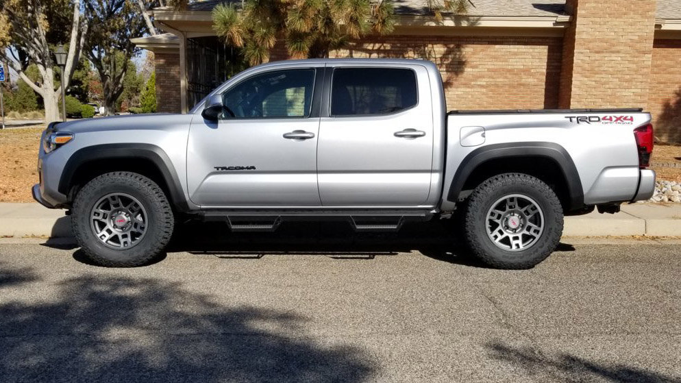

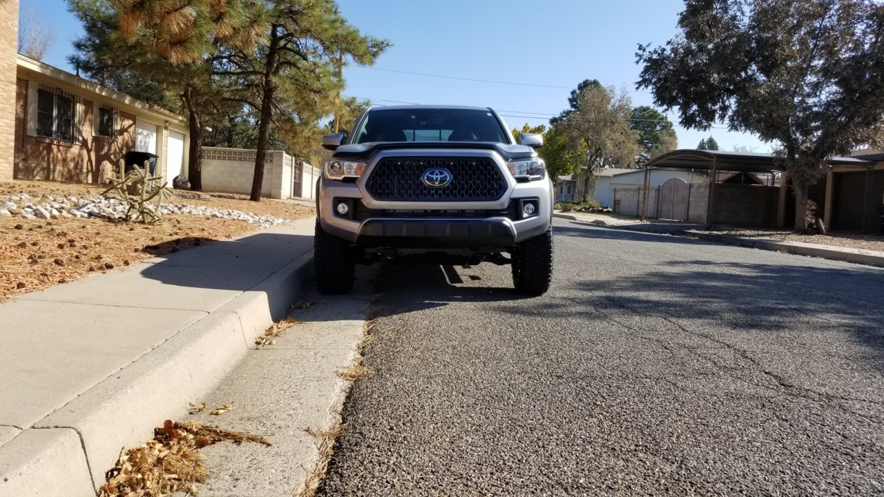

    Finally got the new wheels (17X7 TRD Pro OEM) and tires (265/70/17 UltraTerrain) installed last Friday. Stock suspension and no rub but I removed the mudflaps prior to swapping out the OEM wheels and tires. I am very pleased with this setup. The ride is only a tad bit rougher than stock and gas mileage around town hasn't changed. The tires perform well off road and feel much better than OEM in my opinion. Thanks for all the help and advice in this thread.
    I can definitely see where the OEM mudflaps will rub just from the way they are designed. It's sort of an odd way to make a mudflap but it probably lends itself to being more rigid and easier for injection molding.
    I went ahead and ordered some Rek Gens because our paved roads are pretty crappy here so it will help with the rocks and debris. I also didn't want to damage the OEM flaps if I want to sell them in the future.
