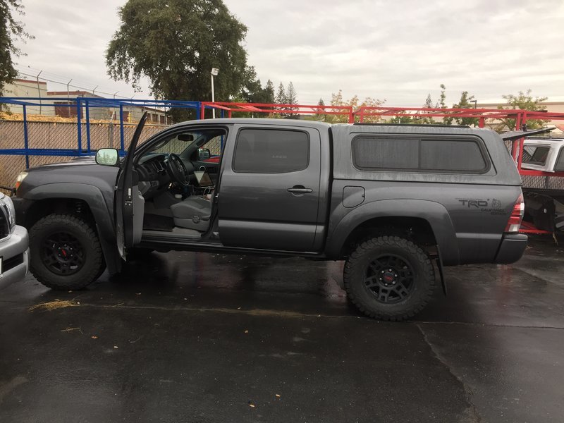

    265/70r17 KO2 had them installed today with bilstein front at 1.75, Deaver AAL rear, I am stoked with results!!

    That looks awesome! I have those wheels ordered. Haven't picked tires yet. And have the Icon AAL on the rear with 5100's and OME coils up front! Will post a pic soon

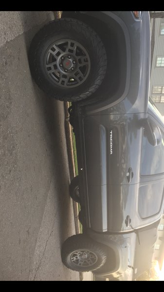

    that sounds like a balancing issue. i just got this same setup installed this morning at Discount Tire and they told me to come back if I had those issues - saying it was directly correlated with balancing.
    Because of the tires, in C load, they actually added some small weights in the inside of my wheels to balance properly. I have never heard of this, but the guy at Discount Tire said it was pretty common for LT Tires.

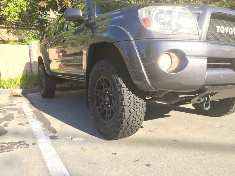

    Very nice! What's your suspension setup?

    Thanks! Pretty happy with the stance.
    Running bilstein 5100s set to 0 with eibach "heavy duty" coils - I believe the coils have a 620lb spring rate and give roughly 2.5" in the front. Light racing upper control arms. In the rear I am running wheelers off-road progressive add a leaf with the stock overloads and Old Man Emu shocks. I think that gave me around 1.5"-2" in rear. Don't quote me on any of those heights because I forgot to measure beforehand.
