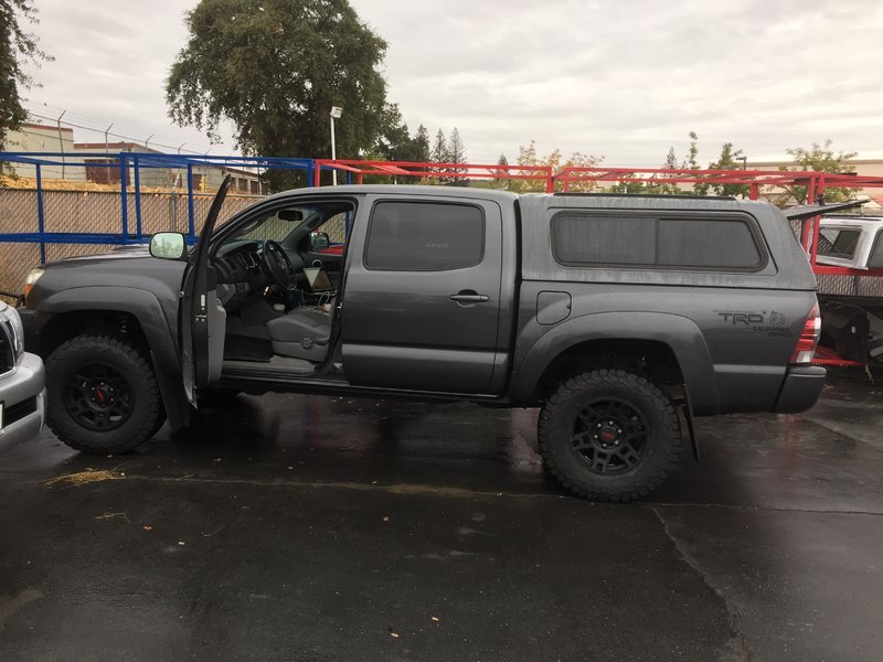

    My old set up I had a cheap rough country 3in spacer leveling kit with matte grey TRD wheels wrapped in 275/70 BFG KO2s on there no rubbing or trimming of any sort

    2.5" lift in the front with 5100s set to 0" and eibach 620lb 2.5" coils, and 1.5" wheelers progressive add a leaf in the rear. 275 70r17 no rubbing. This is a second gen tho...IMG_0165.jpg

    VangaSTL Well-Known Member
    Oct 27, 2015
    #167889
    3,602
    Garrick
    St. Louis, MO
    2016 TRD Sport 4x4
    Do you have any spacers on the wheels?

    Nope no spacers
