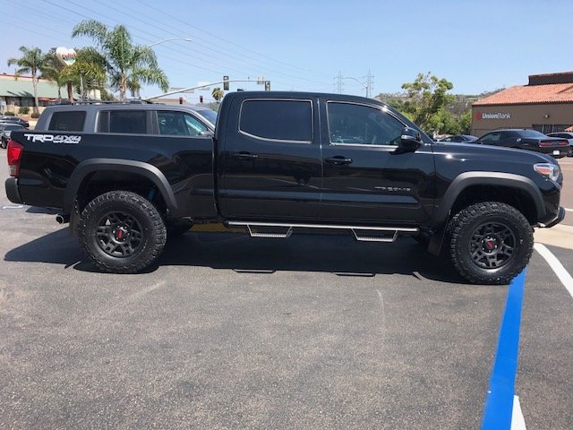

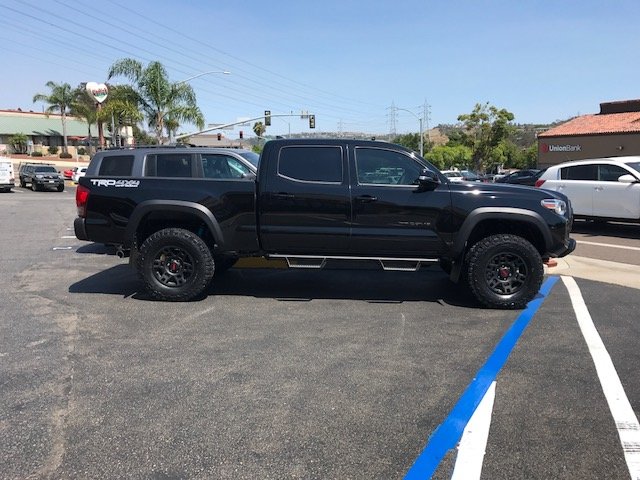

    2017 TRD OR 4x4 LB. I just put on a bilstein 5100 level and AAL I have rockblokz mud flaps with TRD 17/7 wheels 285/70/17 ko2 tires and no rubbing at all. Hope that helps!

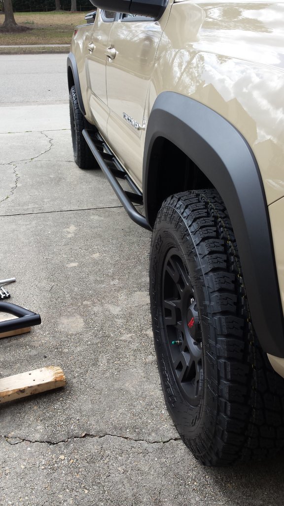

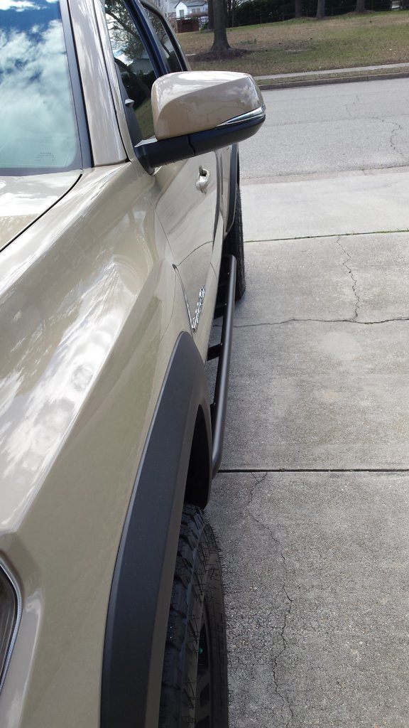

    Are you staying on the stock suspension?
    Here's how far my 4Runner pros stick out with a 265/70 Nitto TG tire on stock suspension, you might catch the outer edge of the inner fender when turning at stock height with 255/80.20160226_132959.jpg 20160226_114633.jpg
    Since those pics were taken I've added 885 springs.
    Shouldn't have any clearance issues if you also go 5100s at 0 and 885 springs.

    I was referring to stock yes. Is the lift needed?

    Like I said, you might rub inner fender especially if you have mudguards at turn with the 4runner Pro wheels.
    Some are experiencing rub at stock height on my size tire with the same wheel on the mudguards and if an airdam is installed on the stock suspension. The 255/80 would be larger than my size.

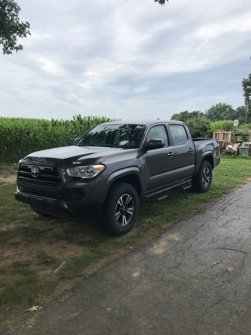

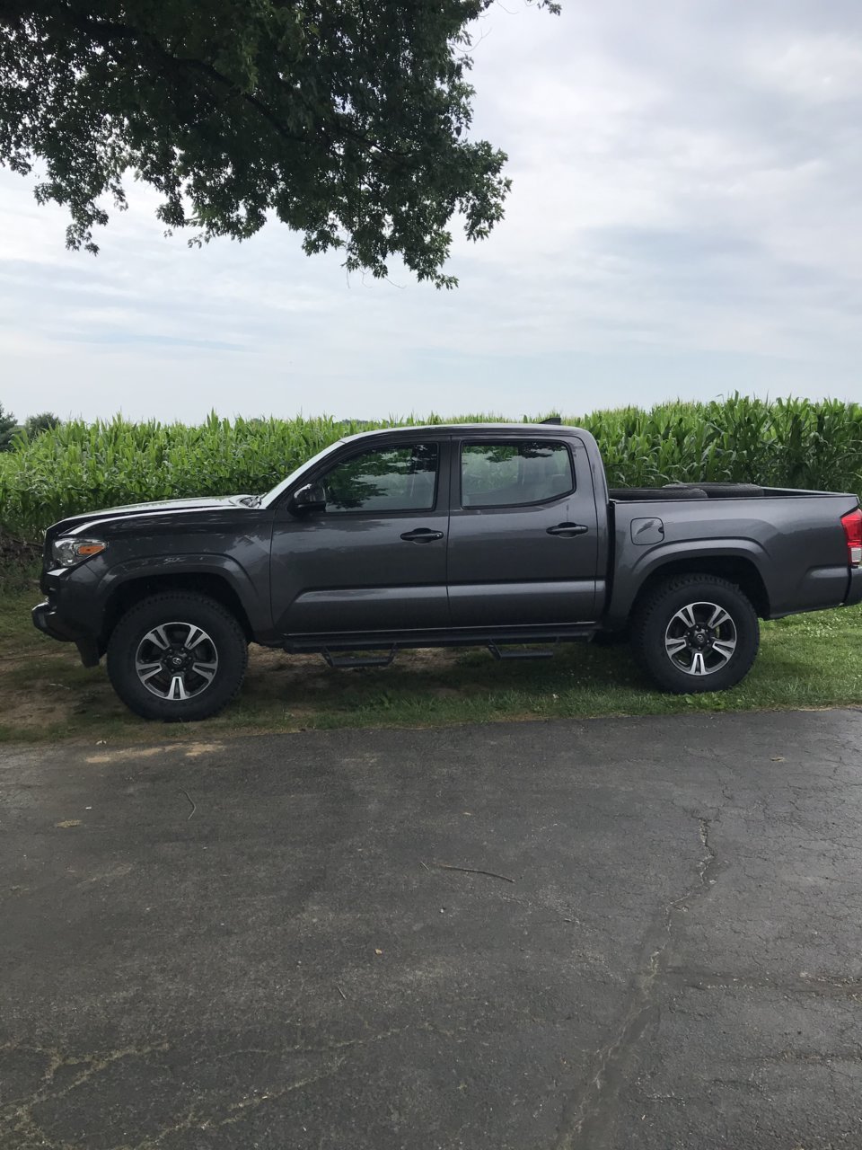

    tires 1.jpg tires 2.jpg Here is my 2017 stock with the TRD Sport rims added and Wrangler 265/70r17's on lift no rubbing. Very happy with the results.

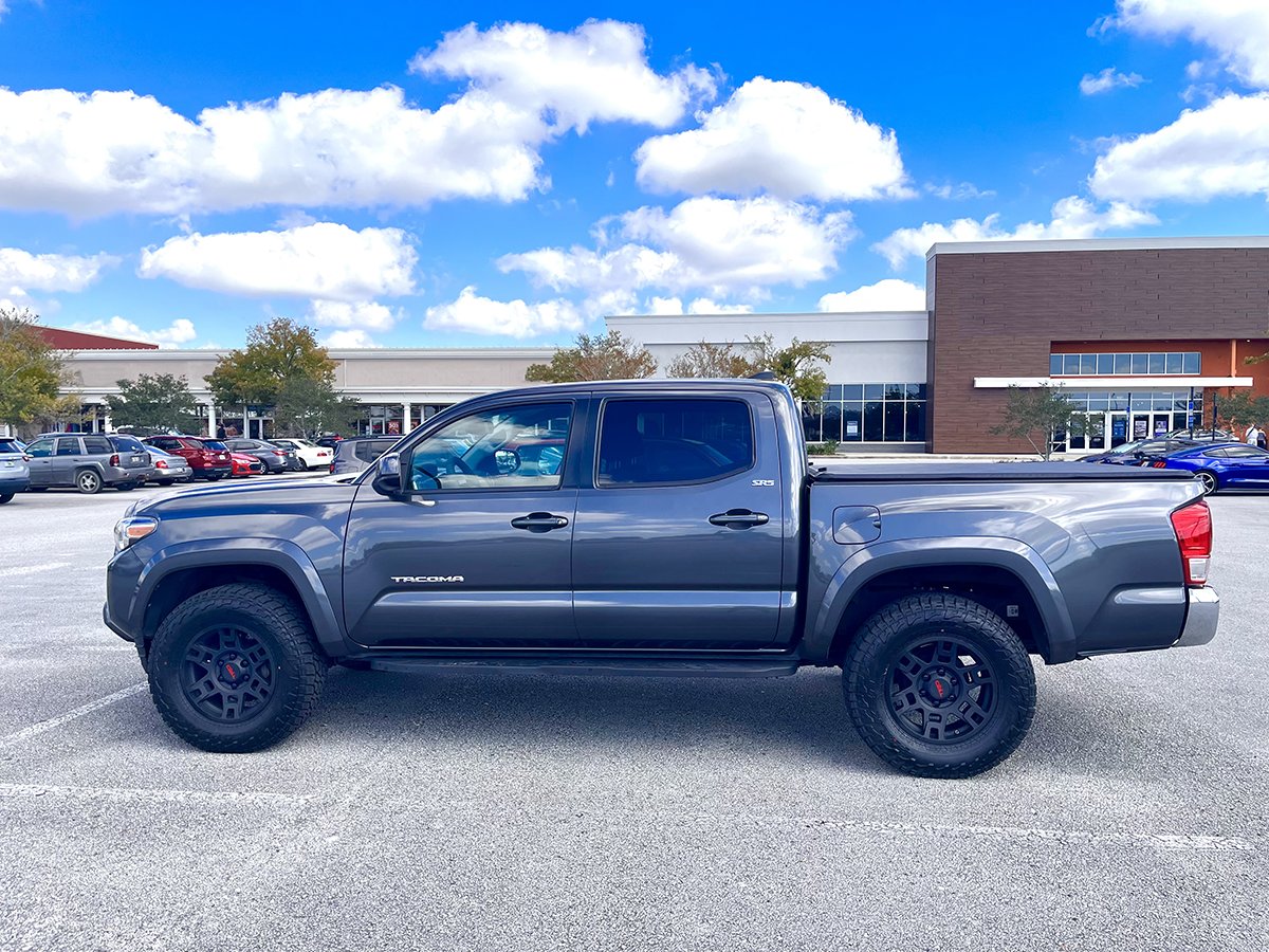

    2017 Tacoma
    TRD wheels

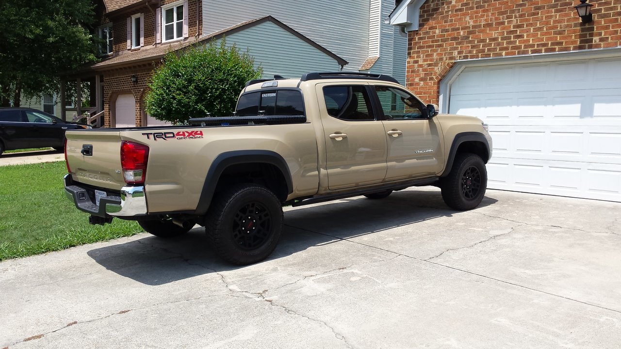

    My 2017 Tacoma. Stock suspension. i got the 17x7 TRD wheels with 265/70 Falken WildPeaks. Fits perfectly no rubbing. Almost got 265/65 but upon further recommendation 70s was the best choice all the way! so glad i did it. Good luck to whoever is considering an upgrade.
