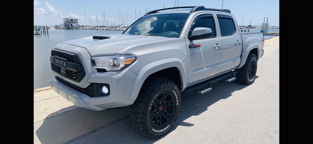

    I had a 2019 Trd Sport with those wheels. It fit just fine.
    Now I have a 2021 Trd Sport with the new design wheels.

    What tires and size are those im about to get 4 and those look really great The bottom ones not the Coopers
  8. Apr 14, 2021 at 5:40 AM
    CarverLB
    CarverLB Who Dat?!
    Apr 9, 2012
    #76579
    1,137
    Bryan
    Long Beach, Mississippi
    2021 Trd Sport 4x4
    Those are 265/70r17 Nitto Trail Grapplers

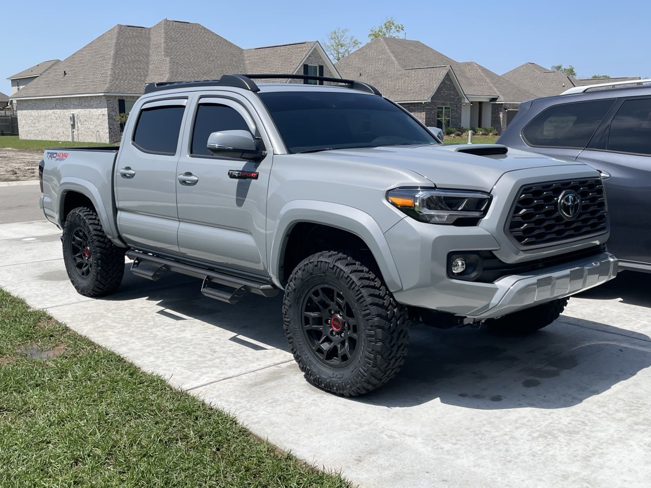

    21' DC OR with TRD Lift, TRD SEMA Matte Black, and ST MAXX at 275/70. Love the setup and no rub but it does throw some gravel on the highway.

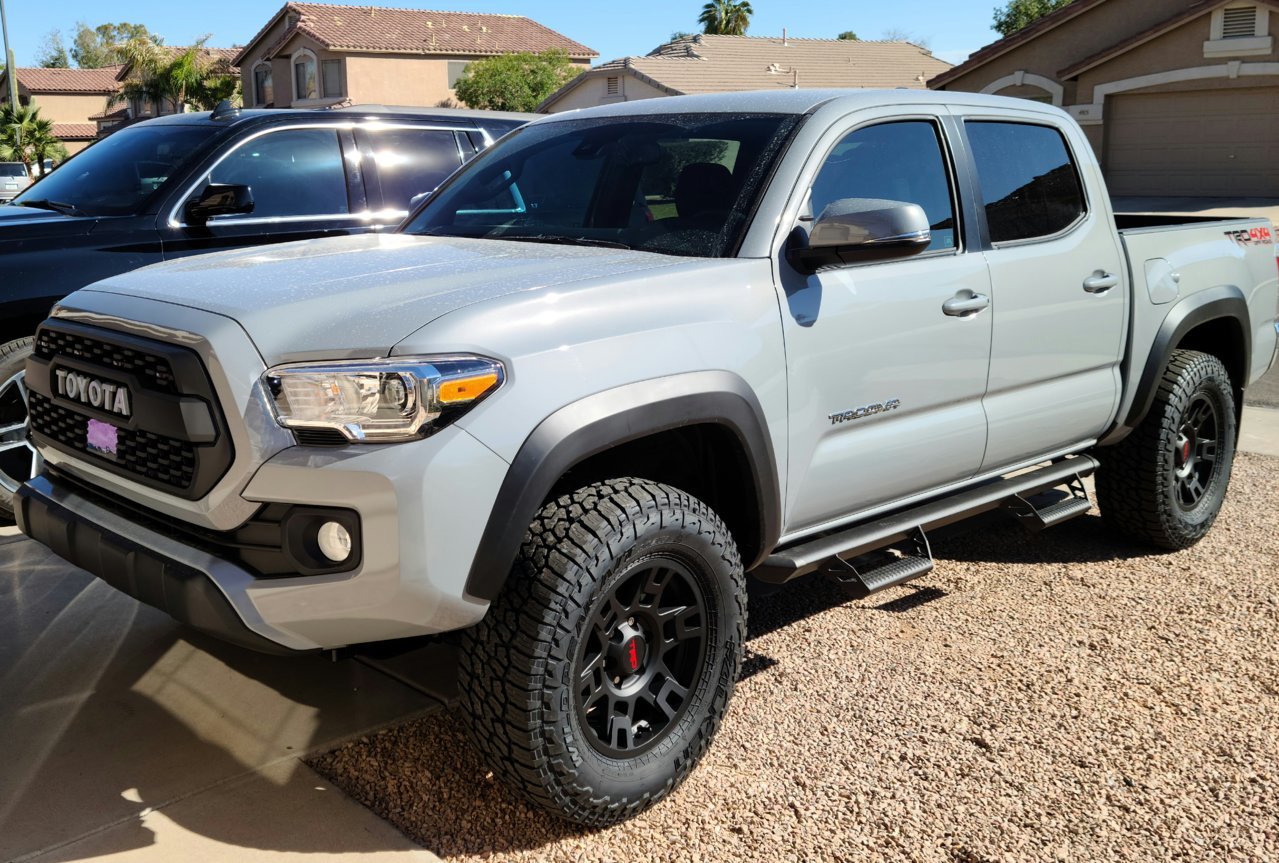

    Nice! Do these come in bronze?

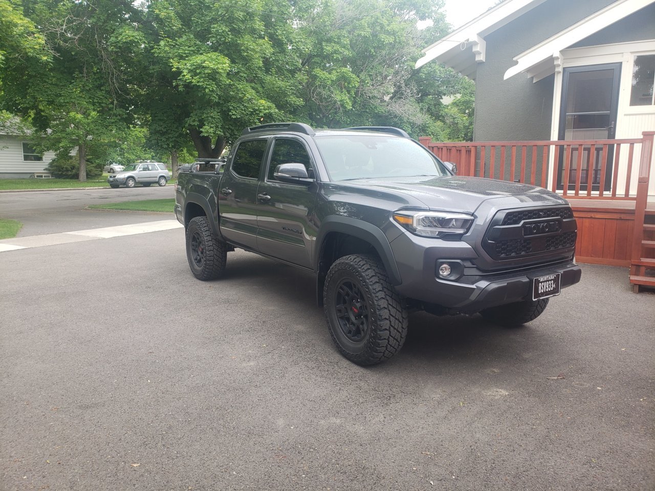

    4Runner SEMA wheels. TRD Factory lift kit.

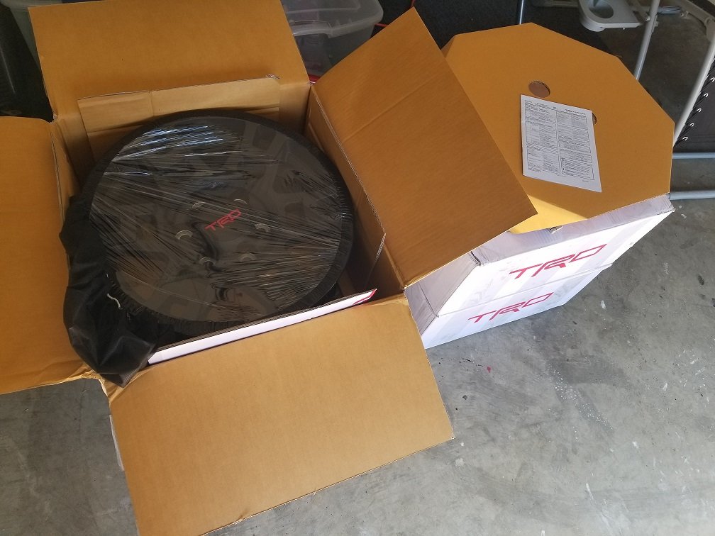

    Use the “FREESHIP” code. I ordered the black version. $715 shipped with no tax. Arrived in three days.
