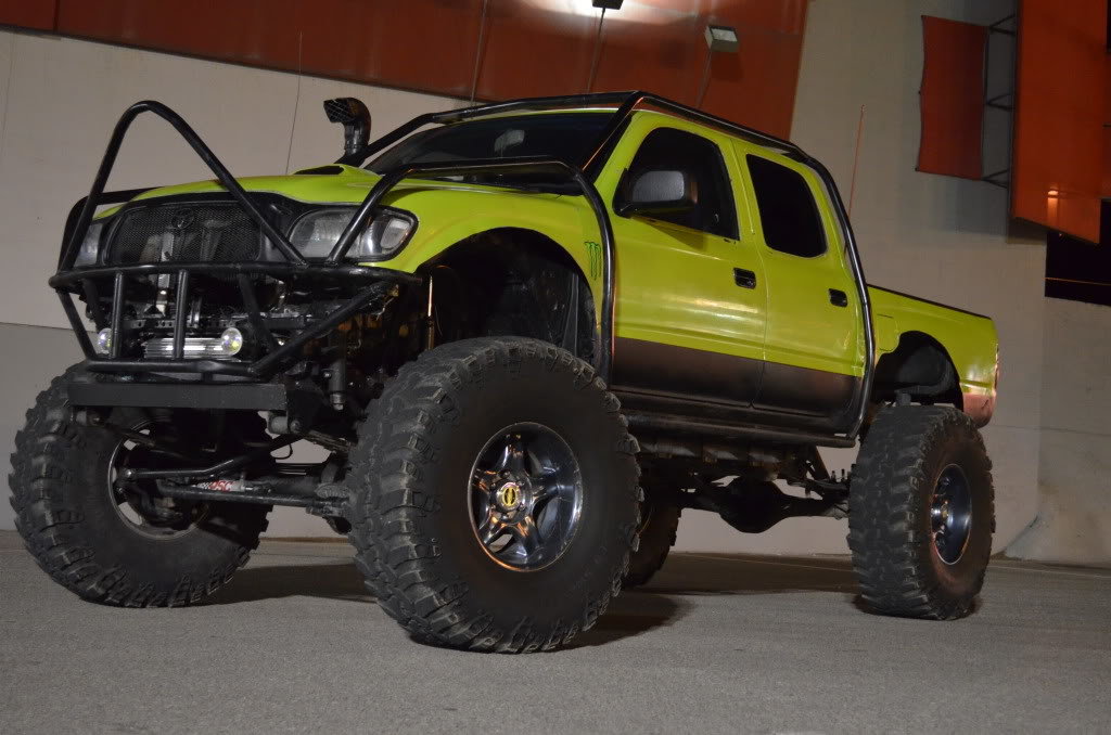

    these rims on my truck are 17" with 41" Iroks you be the judge

    Frik yeah that's intense!!

    Oh i'll judge you damnit!!! I hate you and that beautiful beast and all the ideas you have giving me. This pic is my new back ground on my work computer.Very nice truck:D

    I've been trying to talk my buddy into lifting his first Gen a couple inches, super minor, he's on the fence and asked me for a reference pic to see how it would look. . .
    I told him 5100s and an AAL would look like this!^ and sent him that pic :D

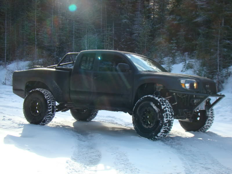

    16.5's have a 5* lip vs most other wheels that have a 15* lip, 16.5's also don't have the "safety" bead. The reason why is that the wheels in half sizes are intended for heavy loads. I run hummer beadlocks in 16.5 and they are tits. DSC07287_6625804dd6bf24fa588465062874d0c063779ecc.jpg

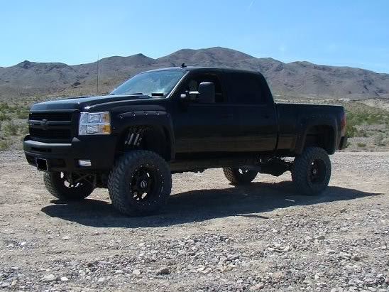

    Iv ran 20's, 18's and now 17's. Got rid of the 18's and went with 17's because of tire cost and availability of 17" tires(Cheaper/Plentiful). Avoided the 16's because of possible fitment issues

    You change over to 8lug or are those 6lug converts?
