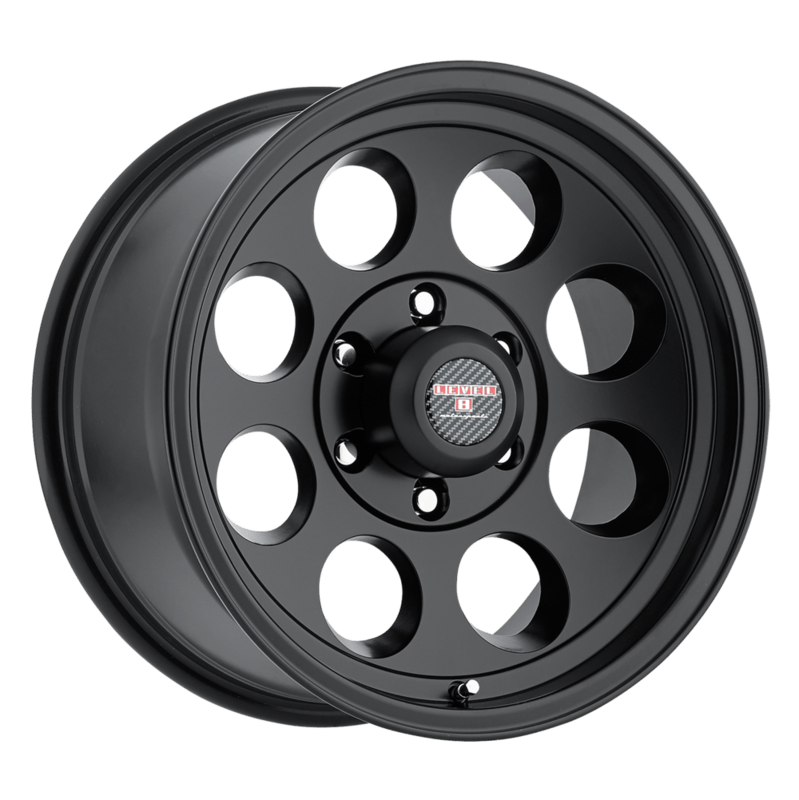

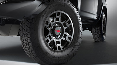

    I can't decide between 2 wheels; The OEM black matte wheel or the Level 8 "Tracker"... I don't know enough about offsets, rim\tire widths to persuade my choice in this matter and hope someone could help me out.....I have a 16' 4dr 2wd long bed sport with stock 17"x7.5" wheels now and will lift the truck 2" soon. Does "offset" mean the wheel sticks out more? Thanks
    Trd wheel 17"x7' 4mm offset
    Tracker 17"x8.5" -6 offset

    Just offset, the tracker will stick out 10mm further than the trd. The tracker is also a wider wheel, so the actual wheel will be 3/4” wider on both sides. You won’t really notice the wheel width difference because the overall tire is wider. Hope that makes sense. The TRD wheel is a better looking/stronger/more popular wheel. IMO

    Yea, makes sense. I like the trd wheel better but was apprehensive about a smaller wheel and looking too skinny as opposed to a bit wider profile without getting too crazy. It’s about a 300.00 difference in price.. Cheapest dealer quoted 750.00 w/tax... if I went with the OEM wheel could I go with a little wider tire?

    The more negative off set the wheel the further it will stick out. Those are both damn good looking wheels and i can't vote either way. I have an 06 and when I did my 3" lift I had to get a different off set wheel due to rubbing on my UCA I believe it's the same with 3rd gens but neither should cause an issue

    It won't look funny at all. Both great looking. A tire with a nice aggressive sidewall will help a lot as well

    A 285 should sit right and look good. I personally would go with a the wheel with the more negative offset if your going with 285. It'll give it a more stanced look and less chance of rubbing
