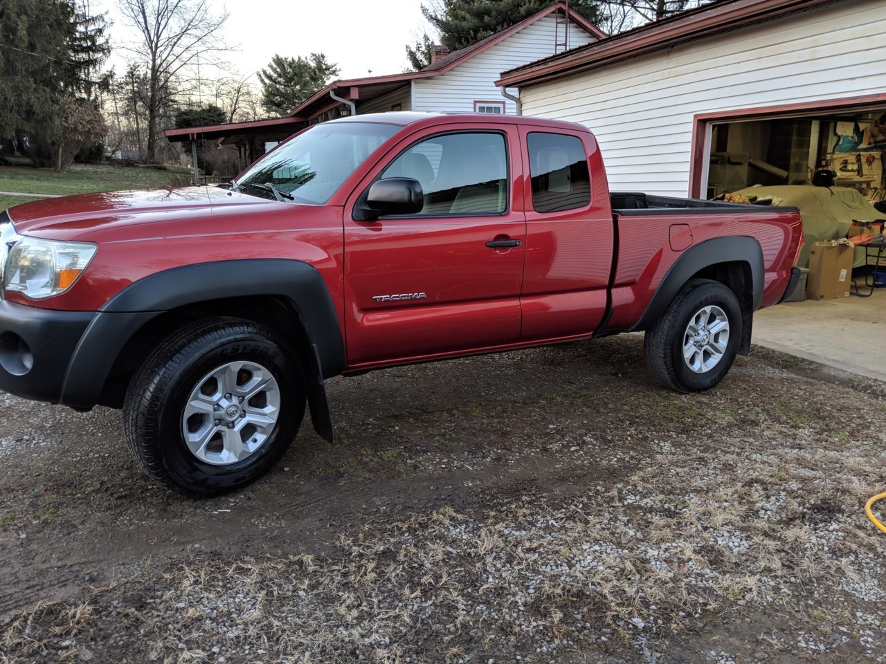

    265/70/17 w/flaps. No rubIMG_20190326_193205.jpg

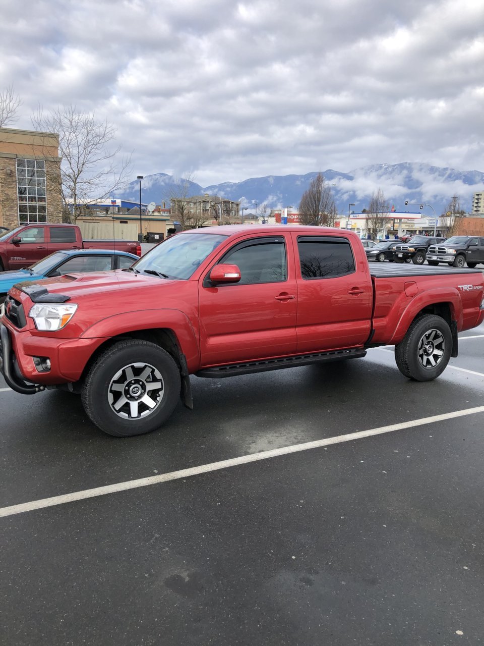

    My 2013 TRD SPORT came with Bridgestone 265/75/17.
    No off road, no lift, no rubbing.

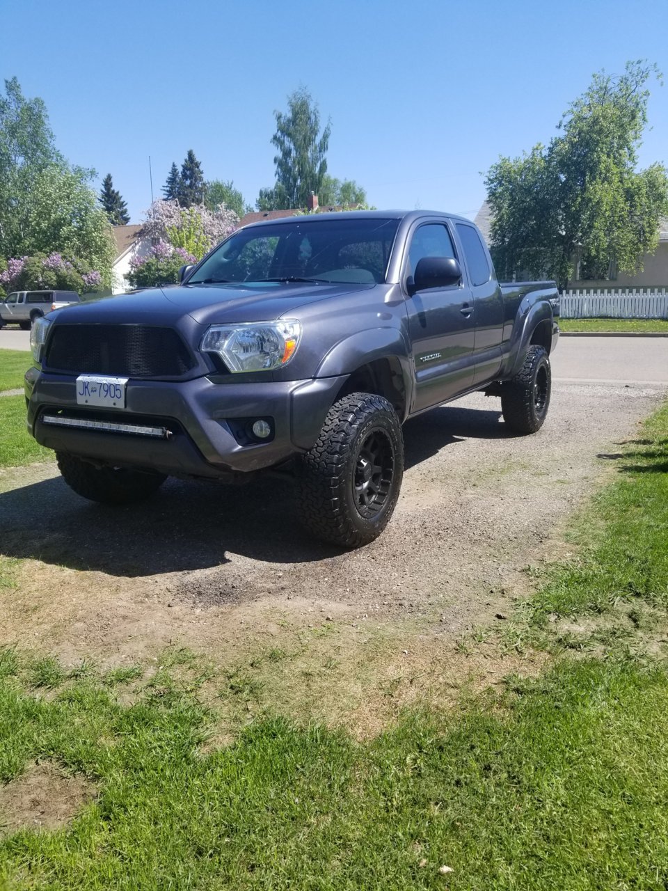

    Little different but, 265 70 17s on a 17x8 rim didnt rub at all for me when truck was stock. But I have never had the chance to test with mudflaps
