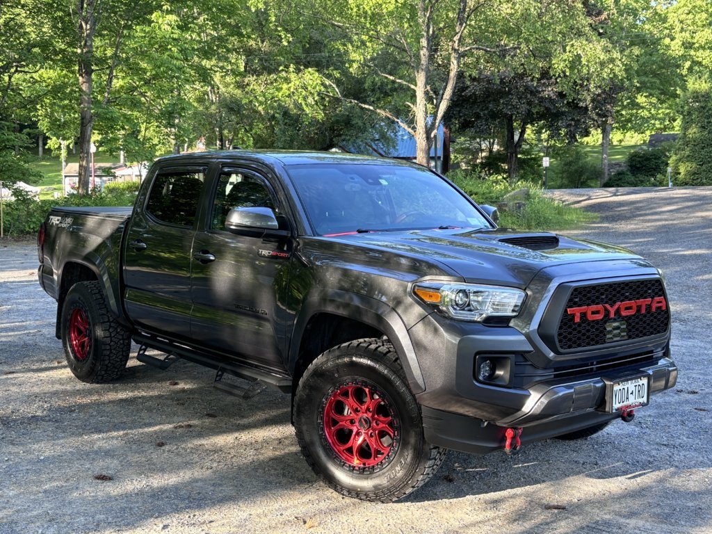

    They should fit fine then. There can be minor differences in overall diameter between tire brands, but with the mudflaps gone, you should be fine. Here is my 2019 with the same size wheels and tires on it. No suspension mods of any kind.

    Thanks man, appreciate it! Love your truck. That red and magnetic is sleek as hell!

    No problem man! Thanks! I wanted something different than everyone else has. I think I nailed that at least! LOL

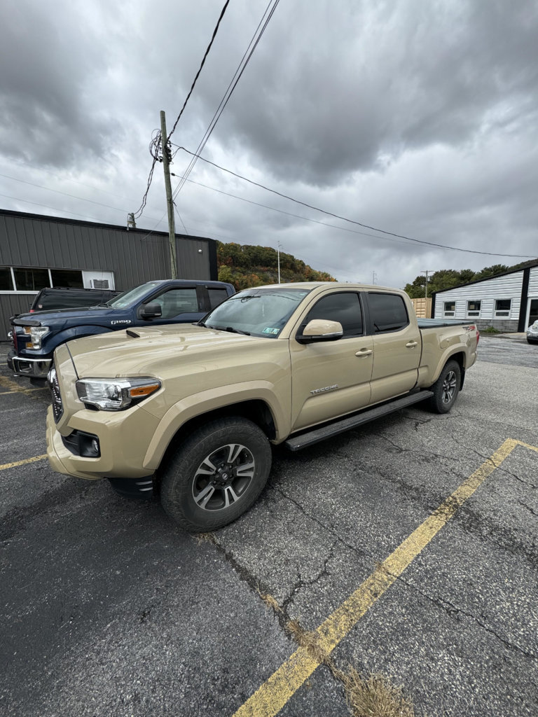

    Hahahaha, yeah for sure. I sniped my truck before they even had a chance to take pics of it. Just got it in the dealer ship and made a listing of it before it was detailed after they bought it. I used to work for a local Toyota dealership and fell in love with Toyotas Sand color. Not many other makes can nail the Tan. Drove 2 hours to get it. Hopefully soon ill have those bad boys on my truck!
    Do you think those wheels would cause and issue with the skirt under the front bumper? I completely forgot about that.
