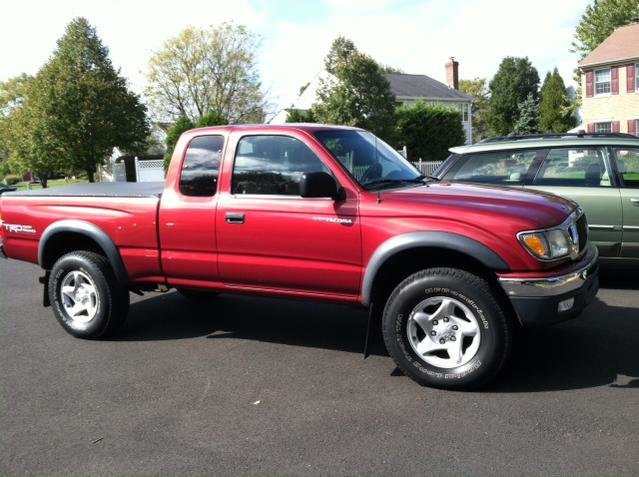

    I purchased this the other day in PA...long story, but my in-laws are in Lancaster, PA, this truck is in Philly...little over an hours drive. So instead of me driving 4.5 hours to test drive from VA, she went and checked it out for me. Very nice, clean as a whistle, NO RUST, one owner, clean title and Car Fax. Only reason why I'm buying this 3 states away is...killer deal.
    Anyway, there is no mention of a timing belt being replaced in the Car Fax and no sticker on the fan shroud....I managed to speak to the original owner tonight, he said he never had it done. He's about to retire, older gentlemen, very nice. No tow hitch, said he babied it. Just wondering why he never changed it. :confused:
    With all that being said, would you trust driving it 200+ miles from PA to VA with the original timing belt? I found a thread on Yota Tech, and some owners claimed to have put 265k on the original....some 150, some 180, etc...
    Being this is my 10th Toyota, third Tacoma, I know how important this is to do.
    What do you all think? Would you schedule an appt with a dealer up there before the drive? Just want some of your takes on it. I've attached a pic of her. :)
